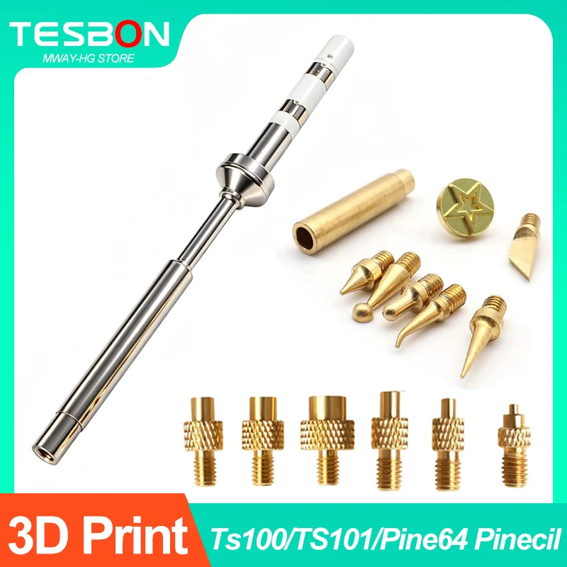

Have you thought about using the blade attachment on a soldering iron?
Absolutely no plastics on the soldering irons please (sorry to jump in).
The heat set/ plastic welding iron does not have a blade attachment. You could make one.
Some interesting ideas - thank you. I have a TS100 solder pencil with an additional element to heat and push threaded inserts into plastic… Then I bought some small brass blades I thought would screw into the element (unfortunately I need to machine an adapter first). However I suspect the soldering pencil approach would be practical for short cuts only. For 1-2m marine fabric I would prefer the cutter Sailrite use, it has a larger curved blade.

I tried a wedge shaped cutting blade that came with a portable gas soldering iron. While I only need the lowest setting for soldering, even with the iron roaring it wouldn’t cut the fabric cleanly. It kept catching, I felt it wasn’t hot and/or smooth enough

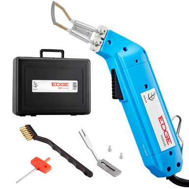

A hot knife 1. wont give you the accuracy/clean edge 2. They’re quite a fire/injury hazard and produce a lot of fumes when cutting so would require fume extraction.
Very handy for cutting webbings though! I have one.
