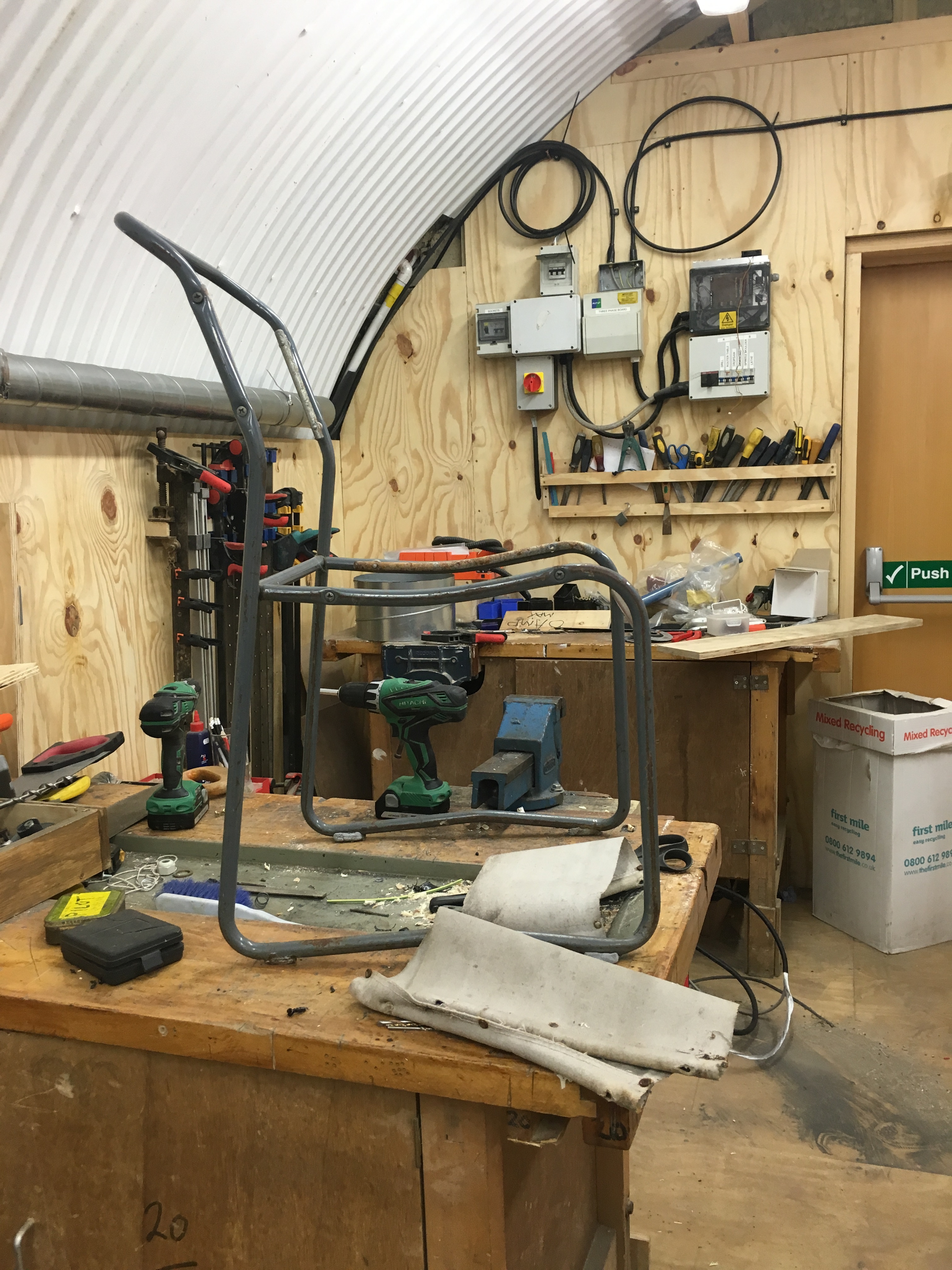

These are the chairs that are having the log seats and backs put on them.
They’re not flat. I think they’ll need to be flat.
