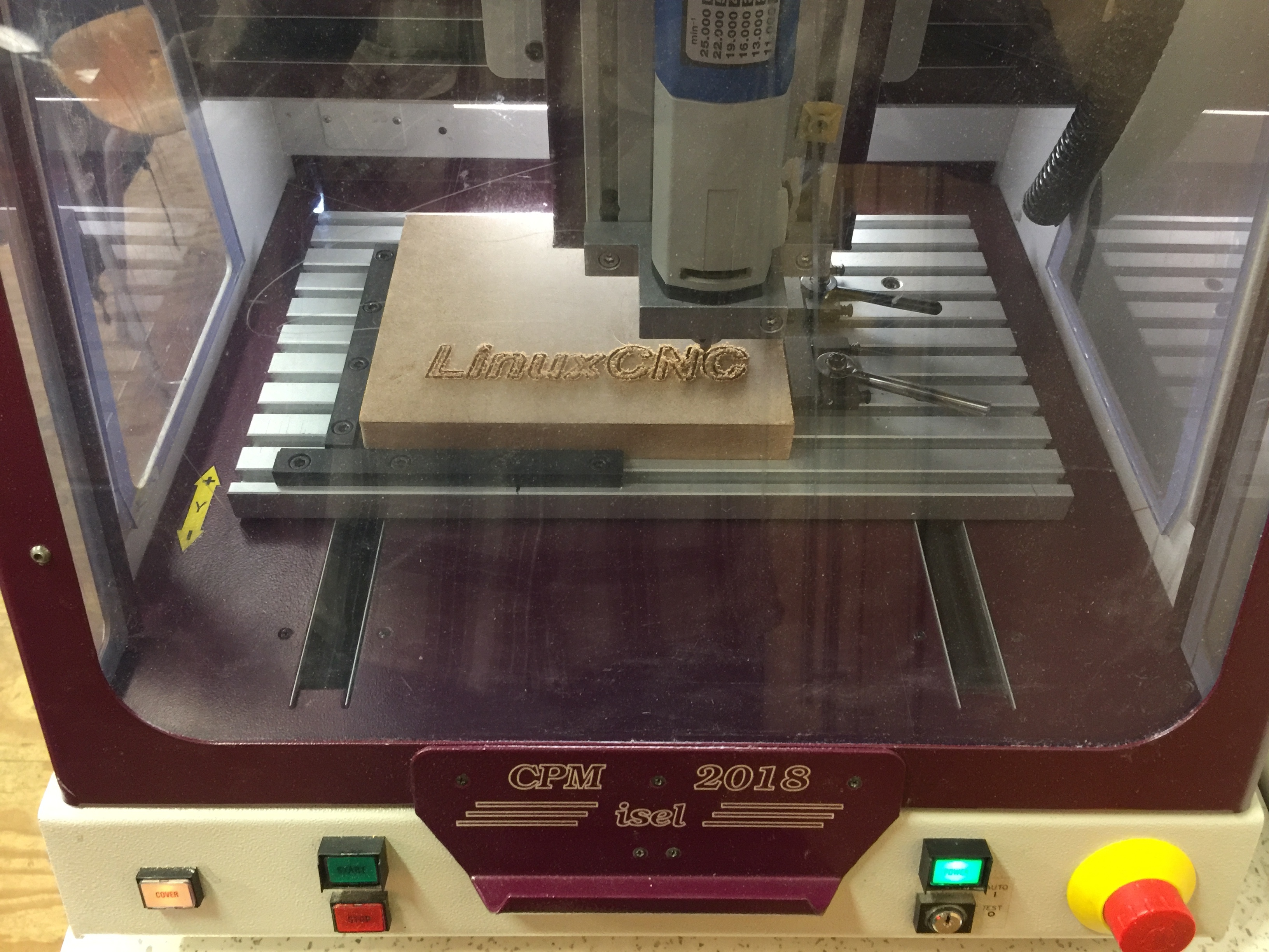

When we looked previously, I did get it moving but it was unreliable and kept erroring out.
The advice we received was to scrap the existing board and replace with a more standard board as above.
The machine itself is superb but the electronics are poor.
There were still a couple of bits outstanding on the list.
One of the limit switches (think it was X axis) seemed to be locked on, the key switch / Em switch were loose and, while we were working on it the wiring to the spindle was disconnected in the junction box on the carriage.

Yupp - just a couple tiny things left to do, but the machine is 95% ready!

Cool, yes the machine movement area is 200mm x 175mm x 90mm and we only have certain bits right now. Although it can do aluminium, we want to stick to wood / plastics first out. So I will come up with some guidelines…
I will write up a tools page for the machine and try to lay out some stuff there…
I dropped in today to have a look and must say Andy has done a great job, attention to detail, neat work, open to suggestions (me chirping from the side lines)
There is still some work and documentation to be done but the base is there, I witnessed a test cut and am pleased with what we have
