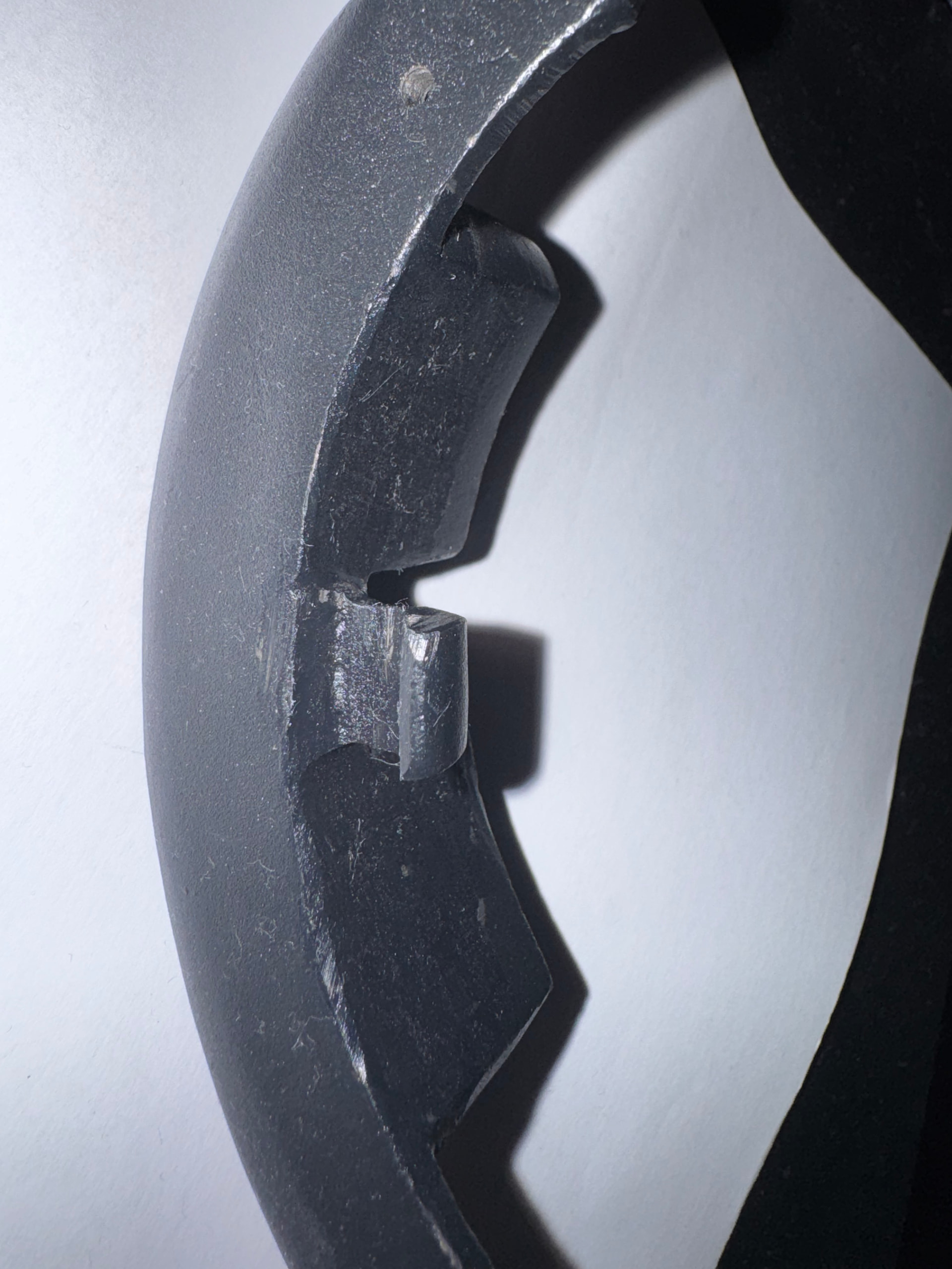

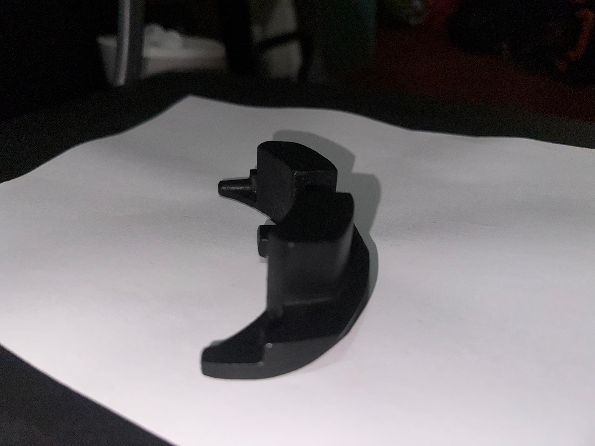

I’m trying to recreate a piece from an adjustable dumbbell, so weight is important. I’ve been doing some research and brass looks like its denser, but also softer (really cool!). Would brass be possible?

If I’m unable to find a brass block big enough, any advice on welding them together? I’m looking into it and it looks like the soldering method is only for small pieces.
I’m trying to recreate a piece that’s about 120x65x35mm so I’ll need a block a little bigger and can’t seem to find them that big online.

Can I ask what sort of shape you’re trying to make? I’ve CNC’ed a fair amount of brass on the current CNC and something 35mm thick would most likely take absolutely forever - typical passes are ~0.25mm on that machine
If it’s relatively simple geometry the vertical mill might be a better option, that thing’s a beast

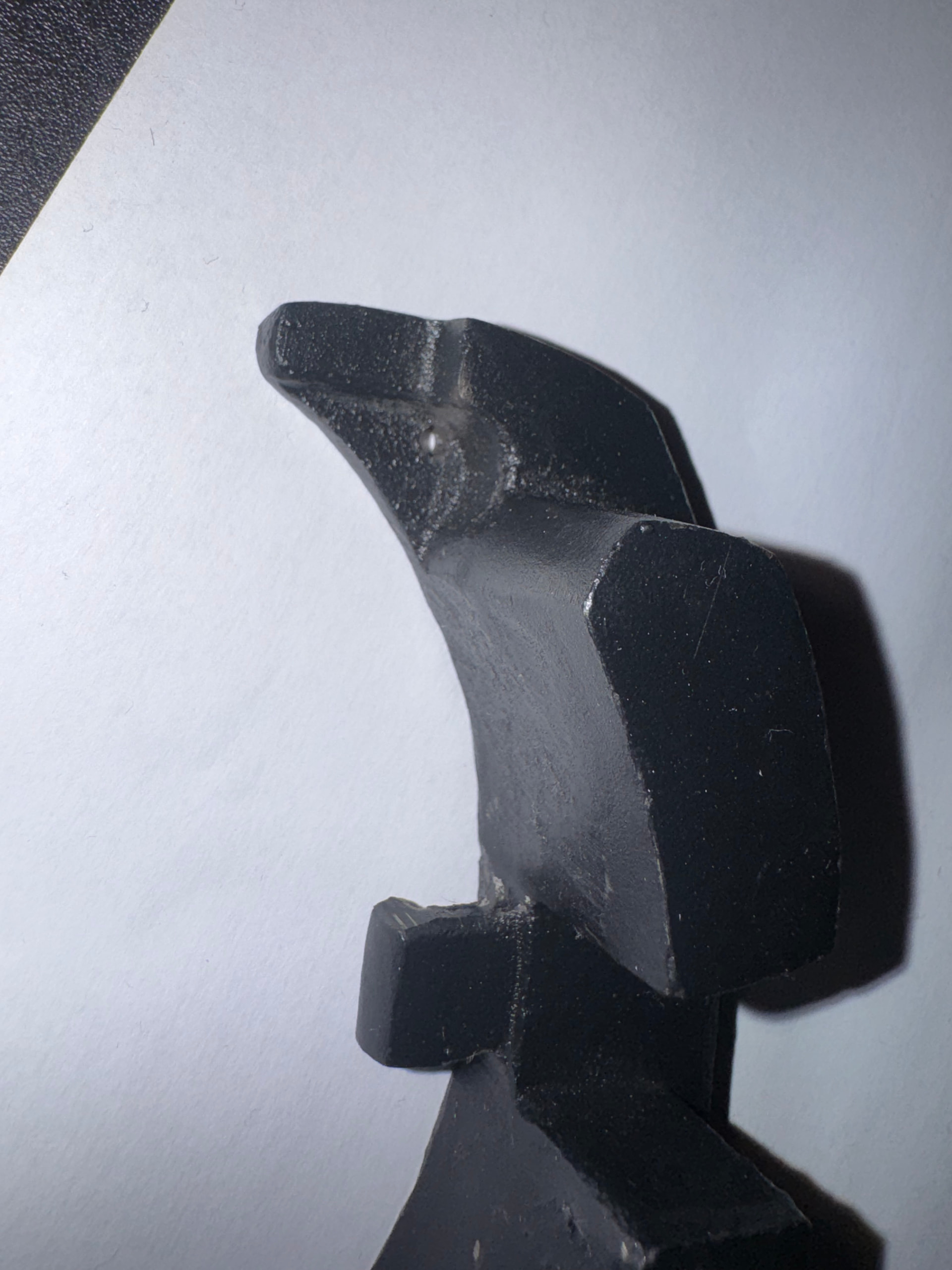

It’s quite a chunky piece, so cutting off the major pieces outside the cnc will probably be worth it. It has a hook which I might struggle to make by hand.
My main concern is finding a block big enough.
I take it what I’m trying to do is quite complex, especially for my current level, considering its a curved shape.

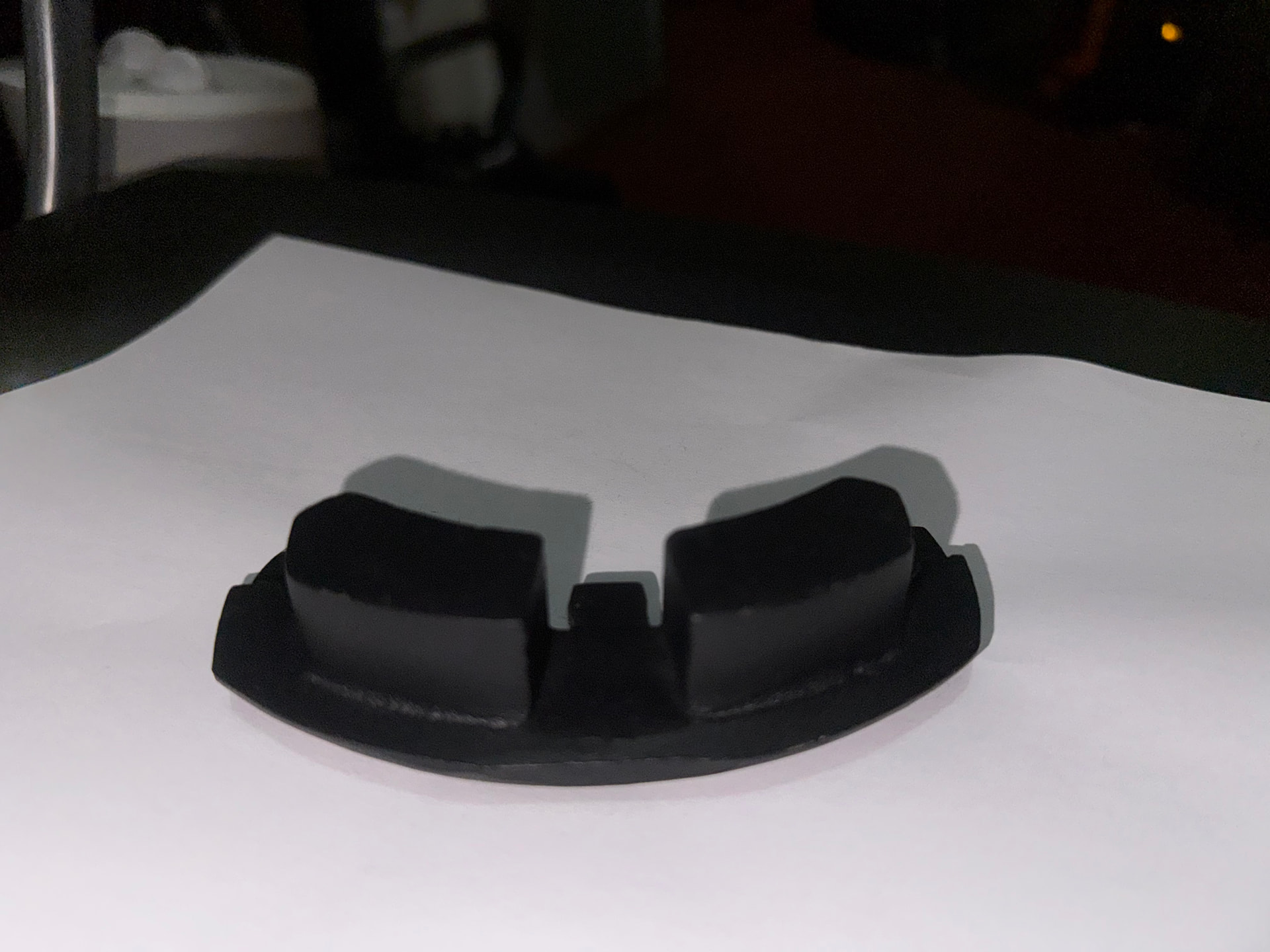

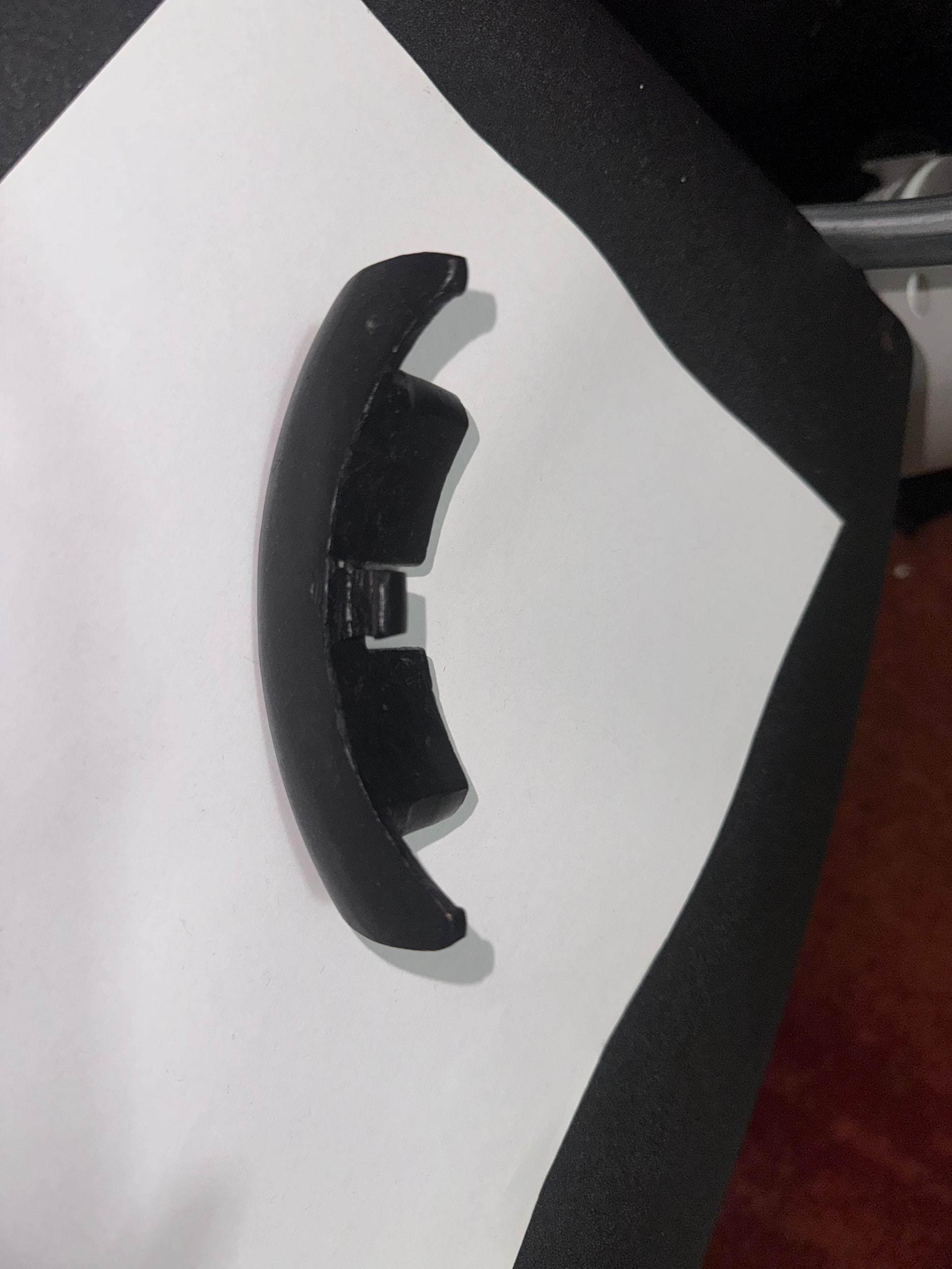

The piece you want to do is doable but very complex to do on a manual machine, but if it’s possible in your application I would suggest a semplification in design, as that will be complicated to do on a CNC too… ![]()
The main problem is finding a block large enough. I could do some brazing, but not sure if that’s doable at the makerspace and I’ve never done it before.

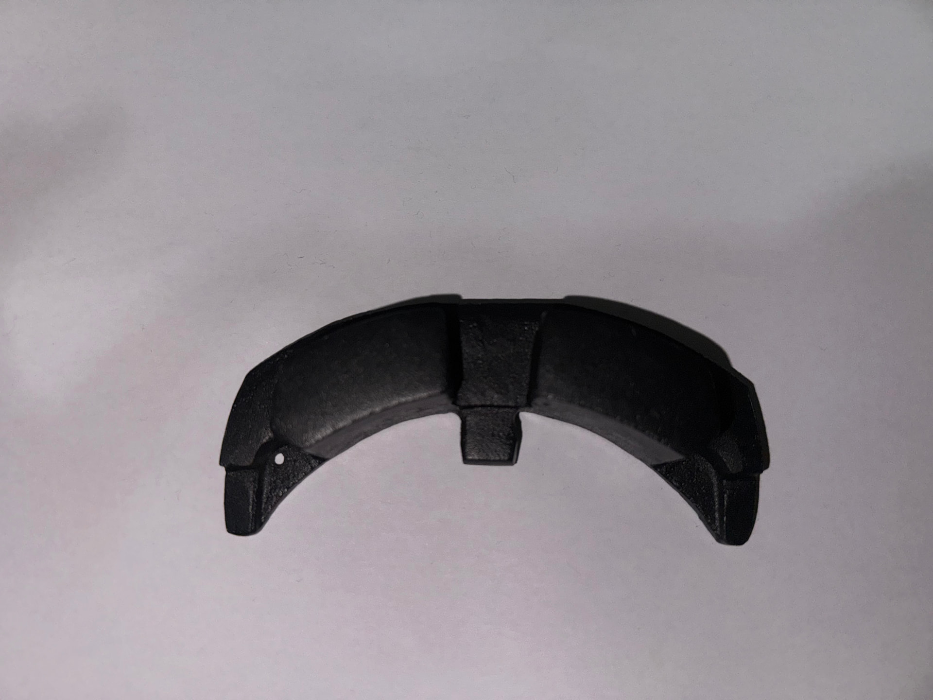

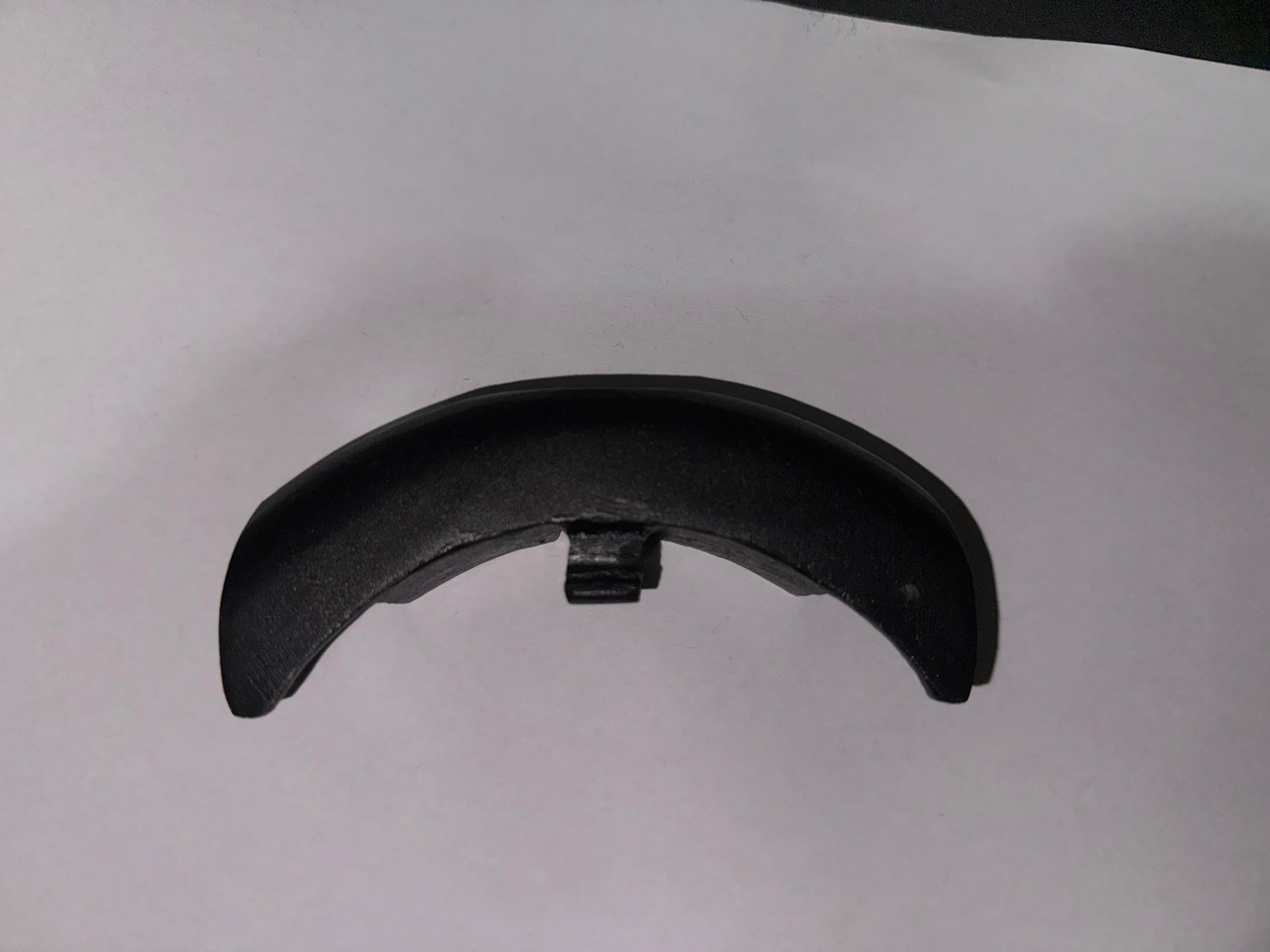

It would need to be this shape, almost exactly, I could cut some corners, but most of the complexity is there so it can slot into the dumbbell.
It’s looking hopeless at the moment.
I could maybe 3D print an enclosure and fill it with brass powder dust, or brass pieces, maybe this could work.

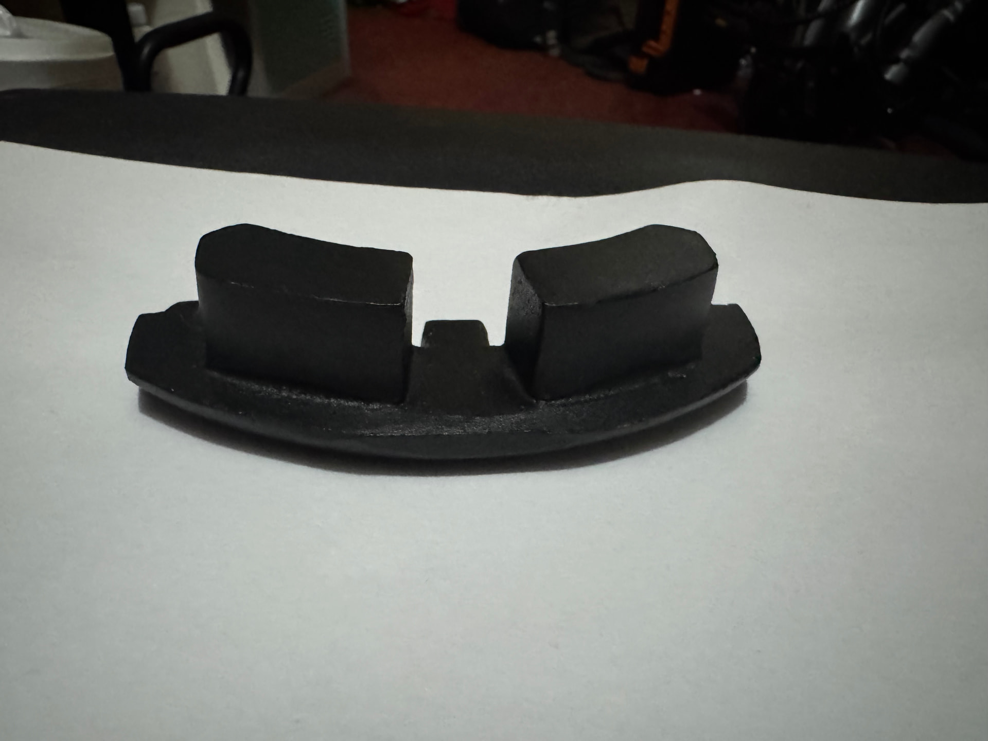

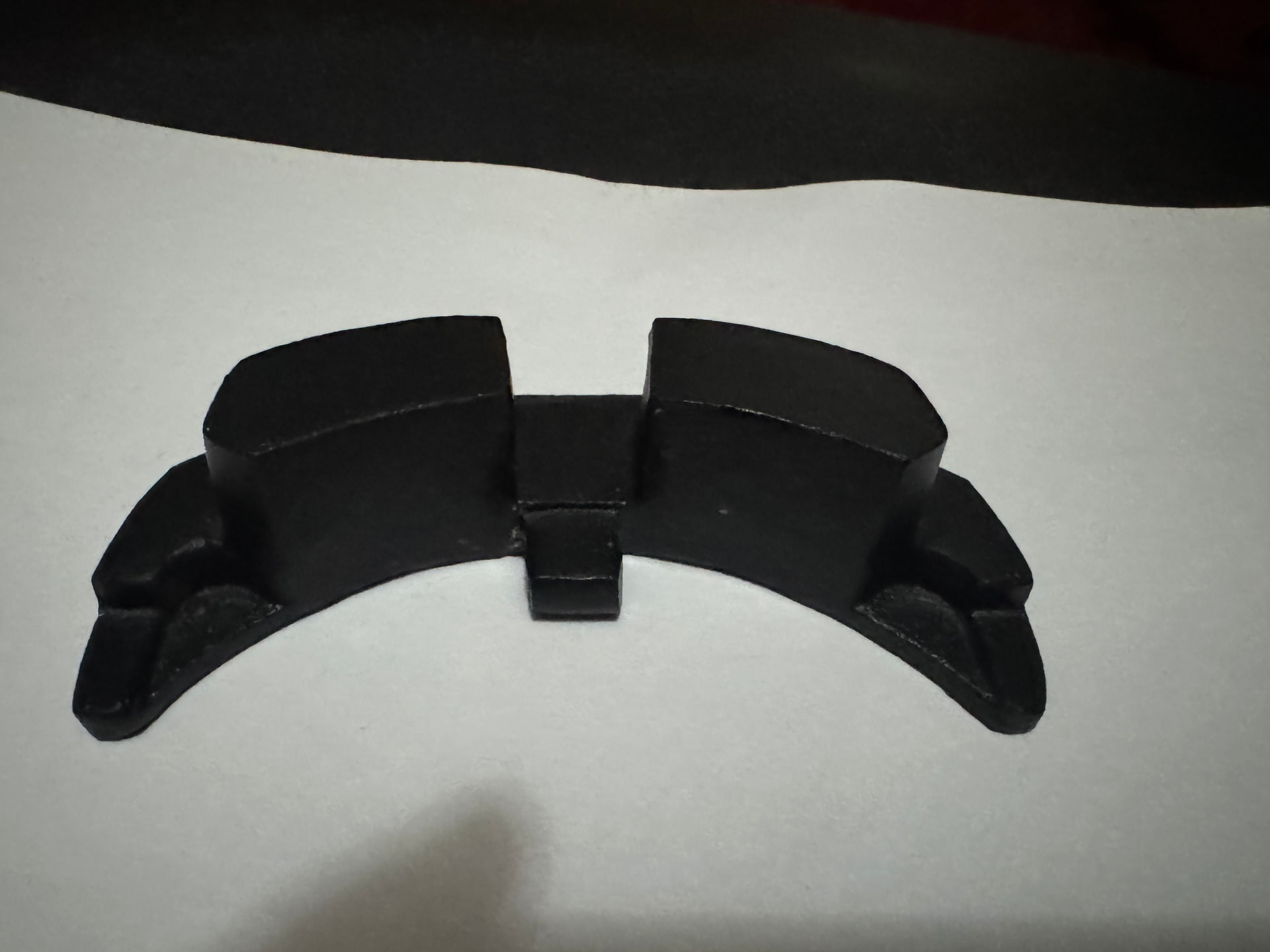

Well I don’t think it’s difficult to find the raw stock.
Metal supermarket has round stock up to 6.5 inches in diameter
There would be a fair amount of waste but it’s doable.

The only part that needs to be metal is the hook, I could probably get away with an ABS hook, but it might break after a while.
If I could just CNC the hook and screw it onto the enclosure, then fill that with brass, or tungsten dust, it might be enough of a compromise without waste, while still being the right shape and weight ![]()
