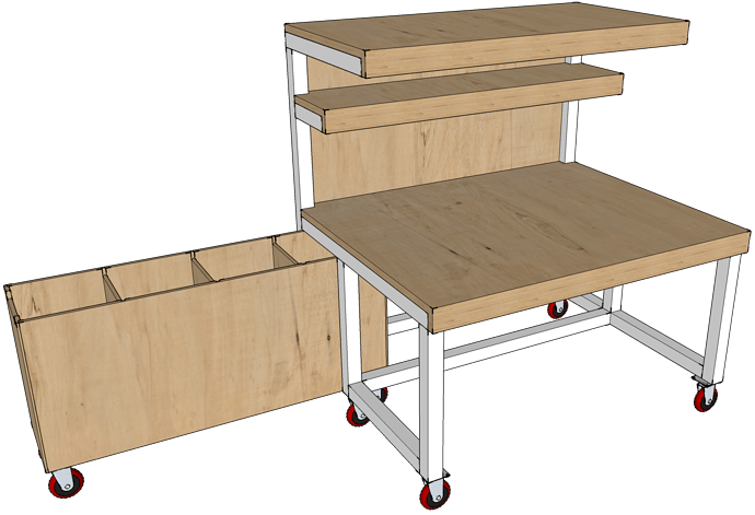

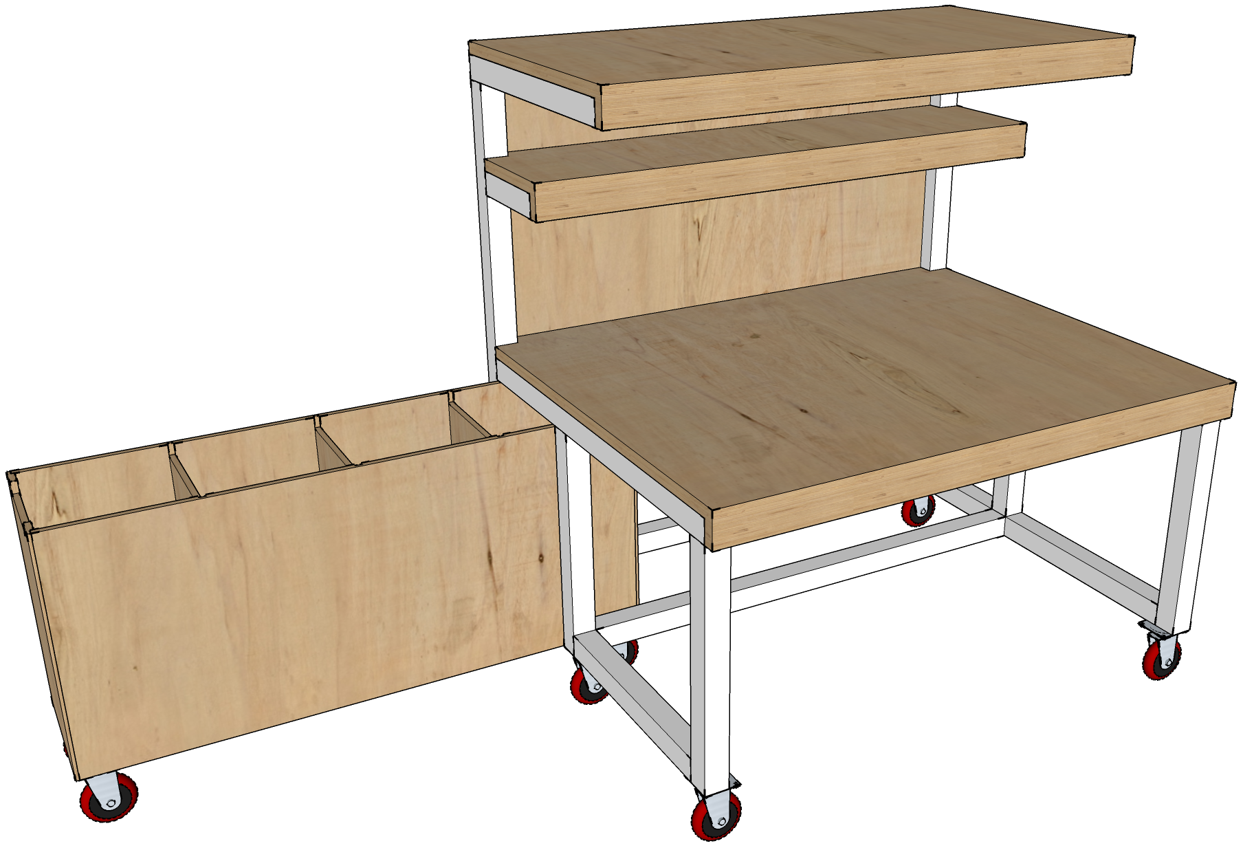

Then we looked at what the electronics benches should be, and while I am skeptical of relying on @joeatkin2’s time he feels lit would be quick to put together a metal frame with timber top.
We discussed a design for the two benches.
Depth: 3’ 3"
Height: 720mm to the work top
Width: 4’ or 6’
There would be a 2’ top shelf and 1’ mid shelf for equipment. There could also be a storage trolley in the back that slides out.

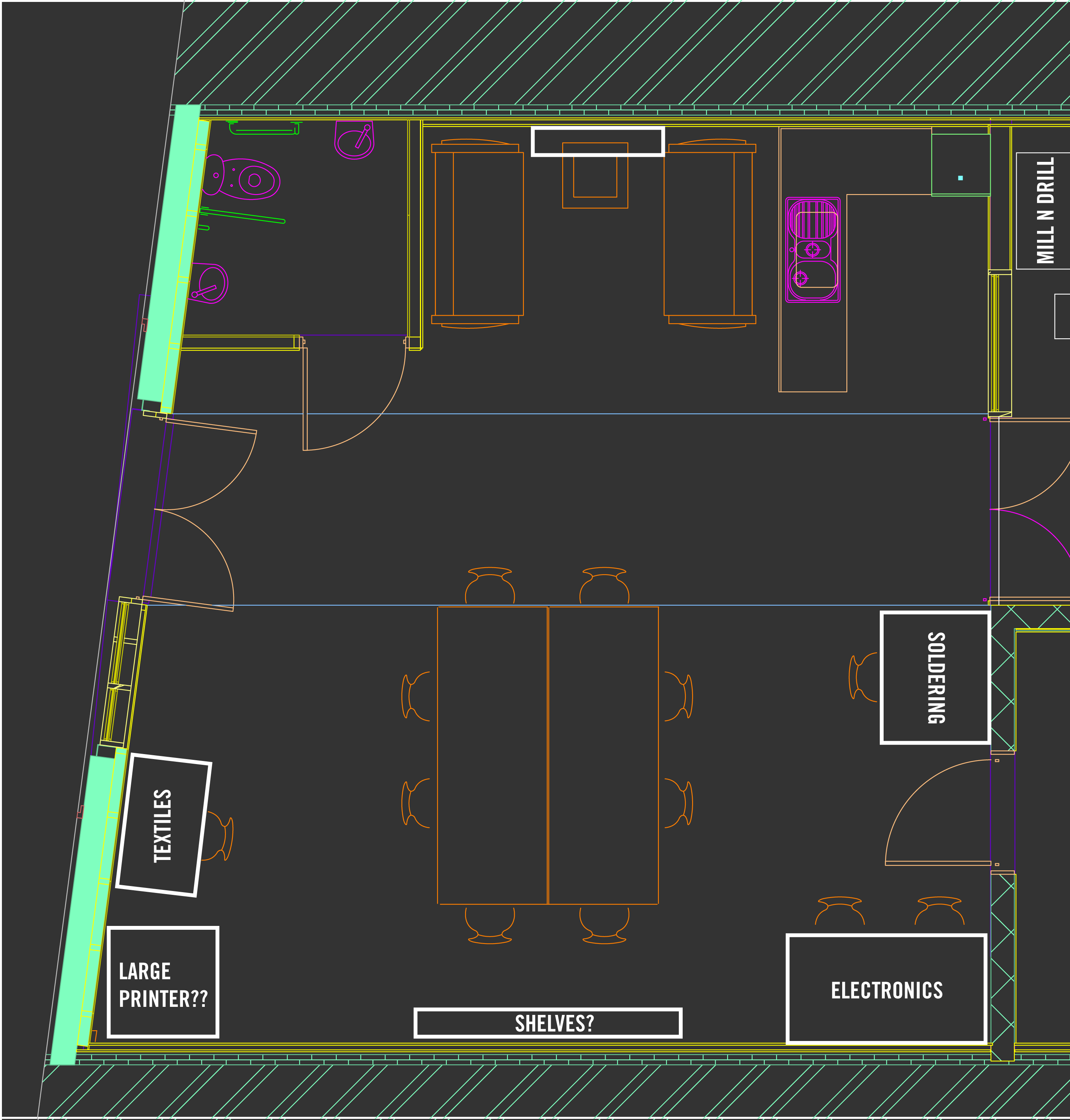

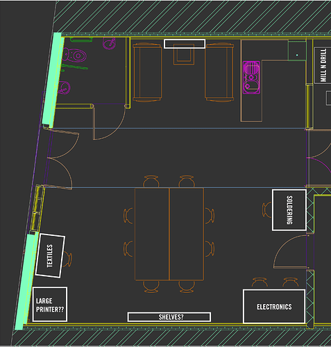

Floor plan below. After going though the layout I’m pretty convinced this is the way to go, nice and roomie, we don’t need loads of storage in clean space other than in dedicated areas.
Need to get a tape measure out and check with @textilestechs what space / furniture they want, I’ve dumped the honking great big printer on them… As I type thinking it could wheel under a standing height cutting table 1meter square minimum, but we can discuss.
@joeatkin2’s To Do list is long and complicated but if he’s happy and @electrotechs are happy I personally think its good design and gets us what we want and need (it was a tough negotiating session but we got there in the end
When table saw is in action knocking out some shelves to go under TV and along wall behind big table will take no time at all.
