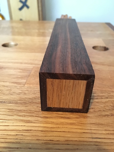

Wanted to make tall thin box with miter joins on the side. Could have used table saw with perilously small pieces of wood, or make a miter shooting board (I chose the later)

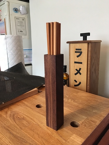

Here is the result:
Walnut sides and a heavy block of oak at the base for stability. It holds 10 individual chopsticks
