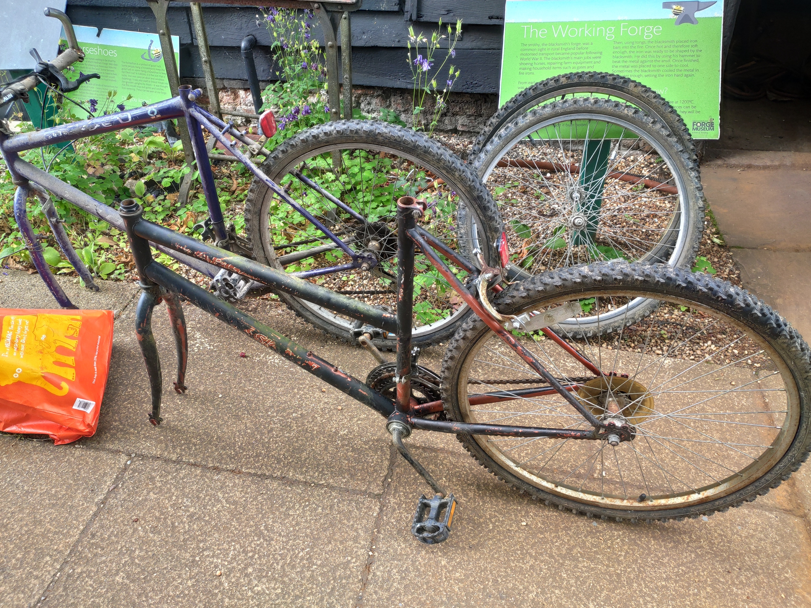

I’m going to cut up a couple of old bikes and wood them together into a Christiana-style cargo trike.

I’ve ordered a TSDZ2 mid-drive and a battery and I think I’m going to stop welding until the motor arrives so I don’t weld anything that gets in the way of the motor.
