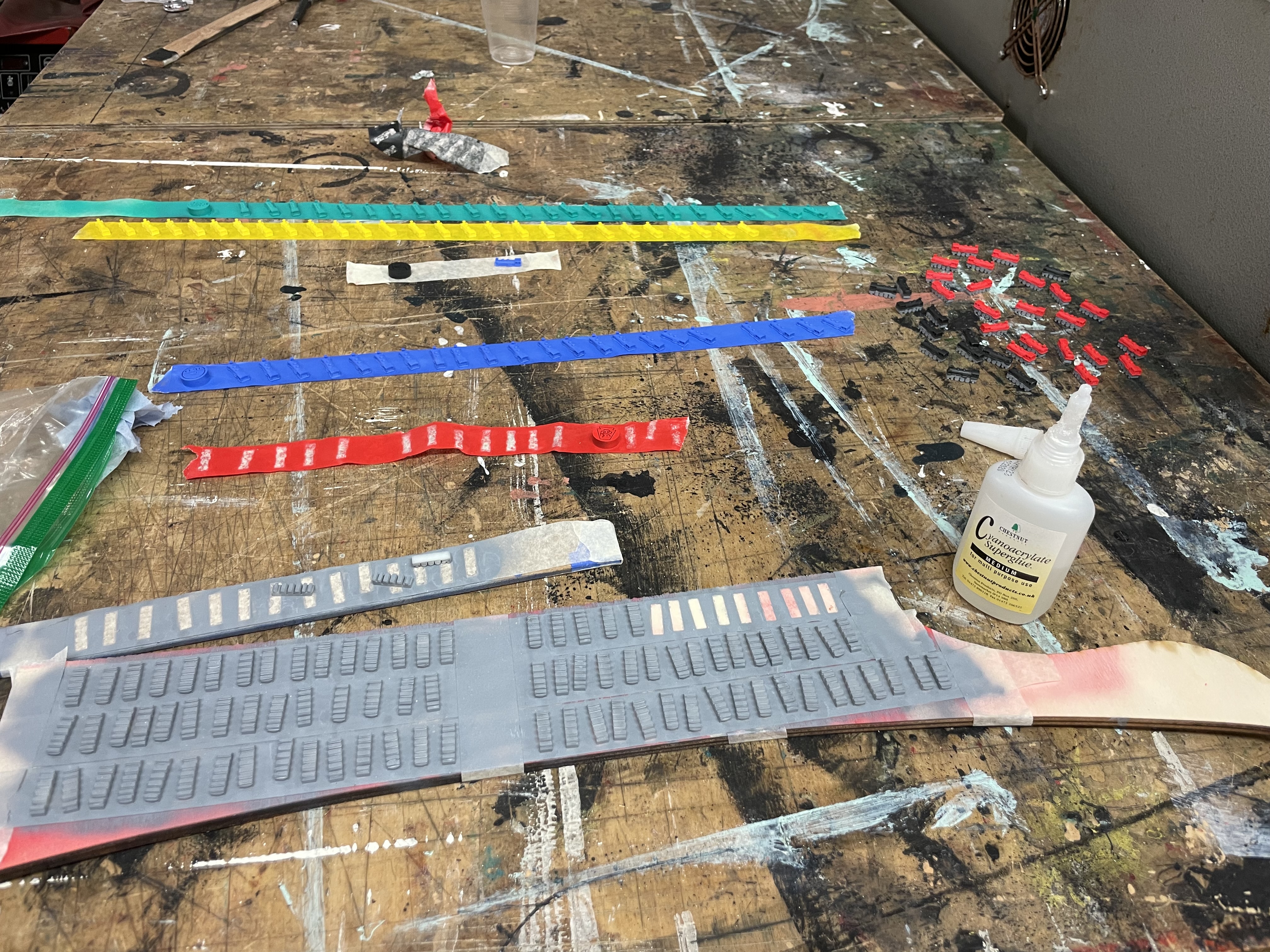

I made these as an excuse to try out the resin printer! I got the models from thingiverse. Each of the trains is two pieces independently painted then glued together. I’d never really airbrushed before, so this was a learning exercise as well.
Progress pic from painting:
