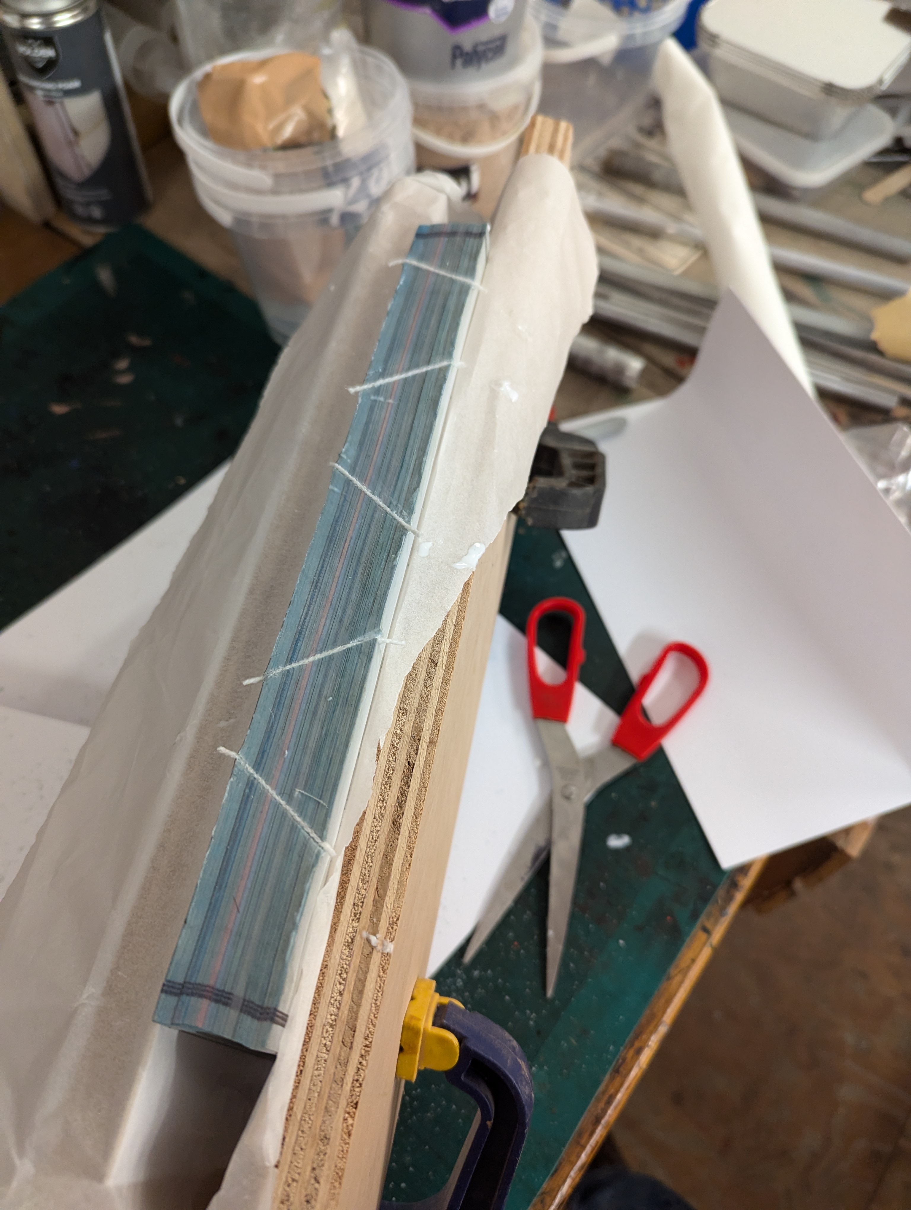

The press that we have at the space at the moment isn’t suitable for gluing up a spine. We have an nipping press but you need a laying press as you need good pressure as close to the spine edge as possible, especially for a larger volume as this.
Just for your future reference, it is better to leave the edges un-trimmed until the book block is bound then trim afterwards for a clean finish.

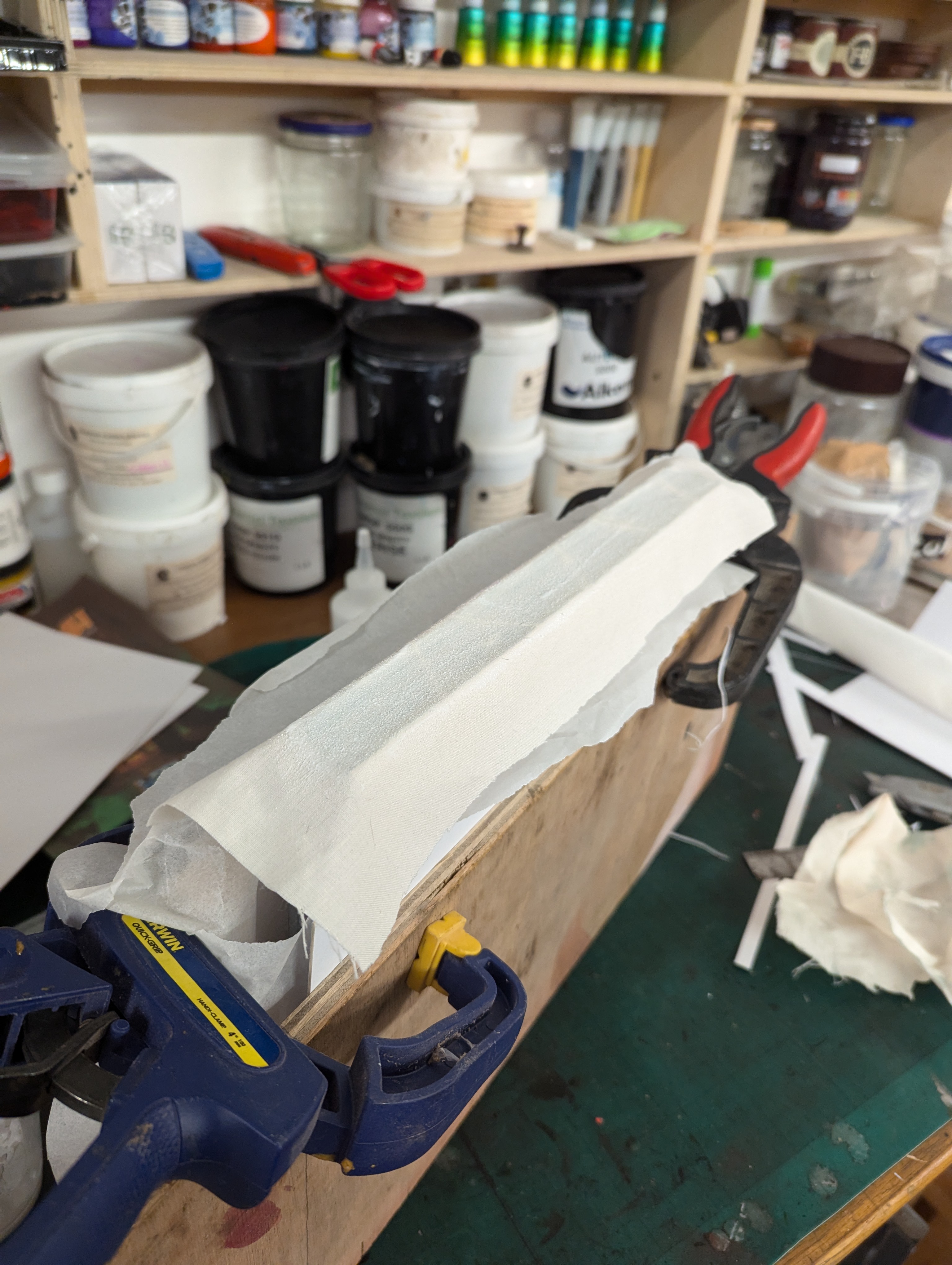

Would a couple of 2x4s and a some wood clamps work? Maybe with some paper to protect it
Yes, as long as you have clamps that can reach the centre of the spine so you can get a nice even pressure though a 2x4 should be stiff enough. and yes a piece of grey board to protect the first and last pages is good. even better if you line this with a release paper, best option would be some silicone release paper (fancy Baking parchment). specificall baking parchment rather than greaseproof is best.

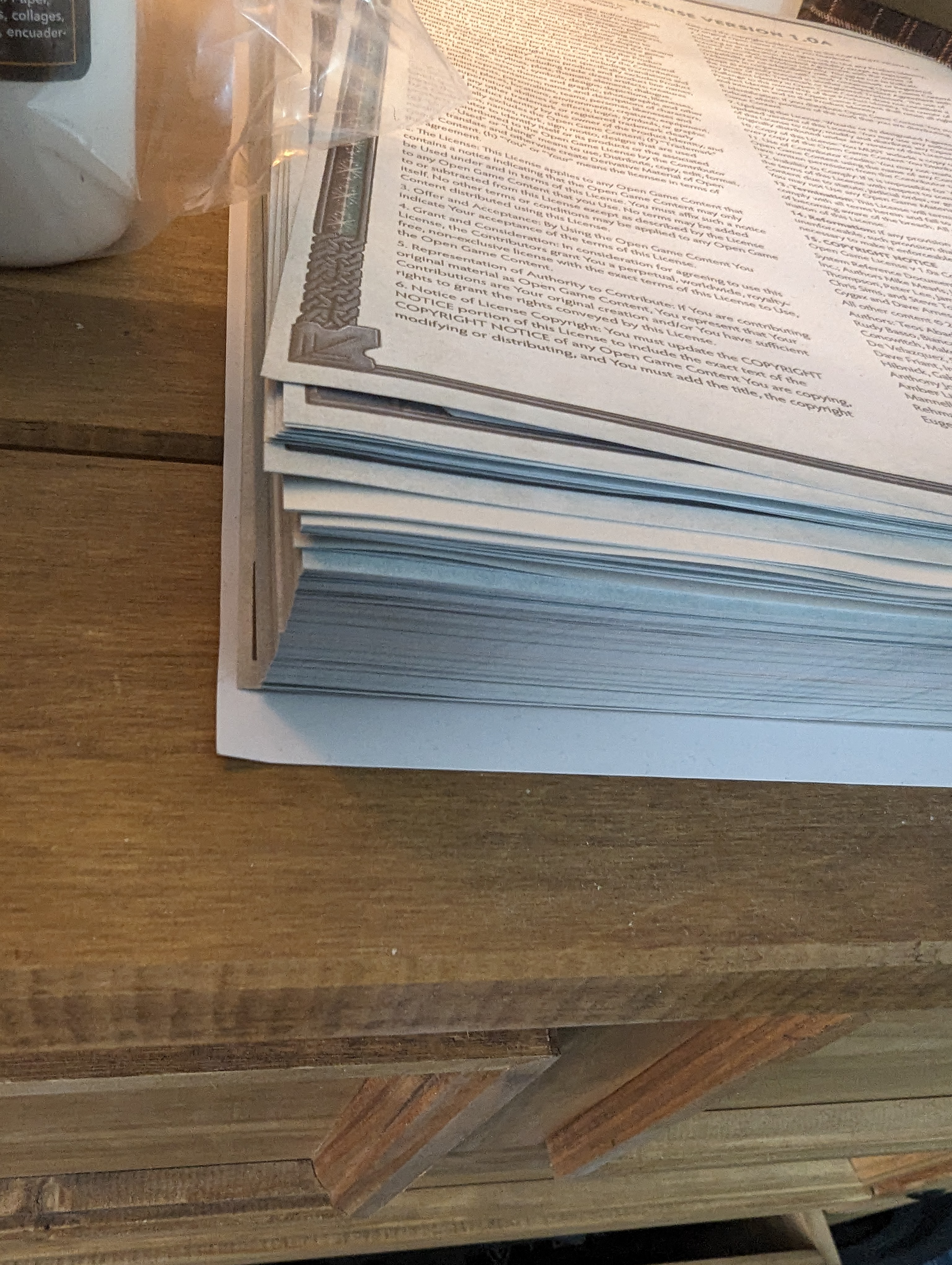

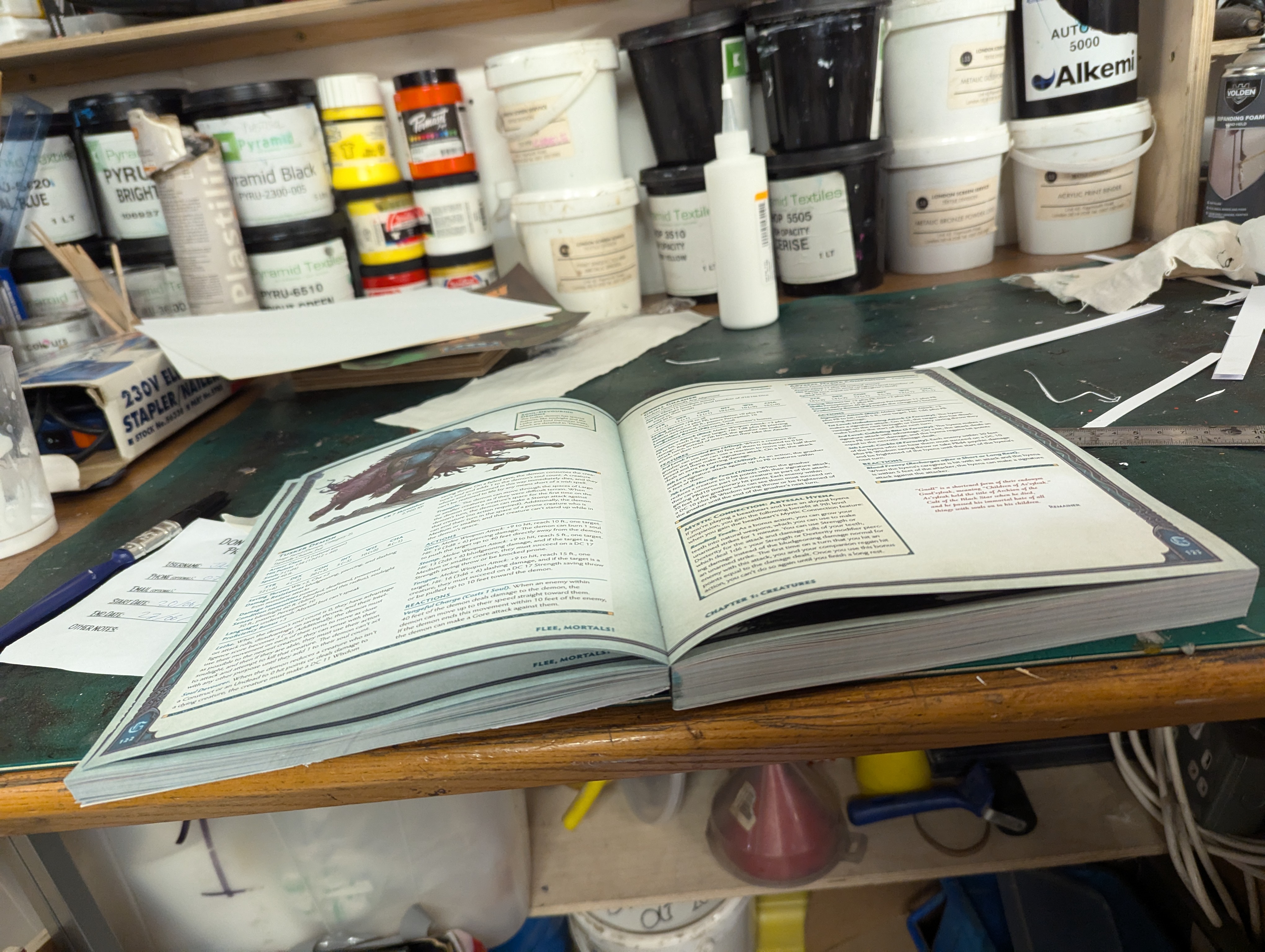

Some progress from today. So far its going pretty well. But I’ve messed up the trimming on one of the end papers
My one annoyance so far is that I had to trim one of the endpapers at the bottom a couple of mm so it’s a touch too short. But I think that’s going to be hard to fix as they’re all glued on.

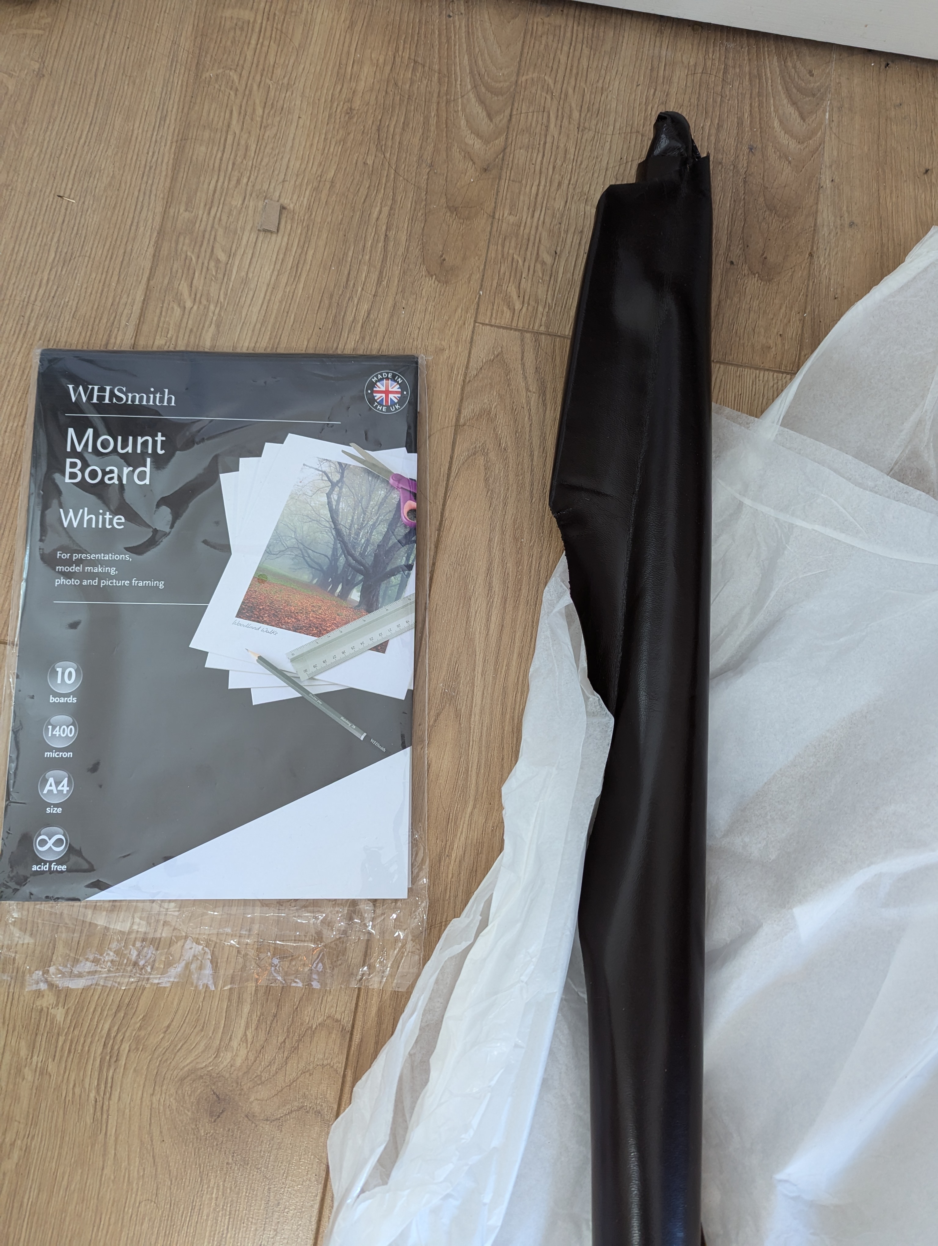

I have a some leather and some mount board

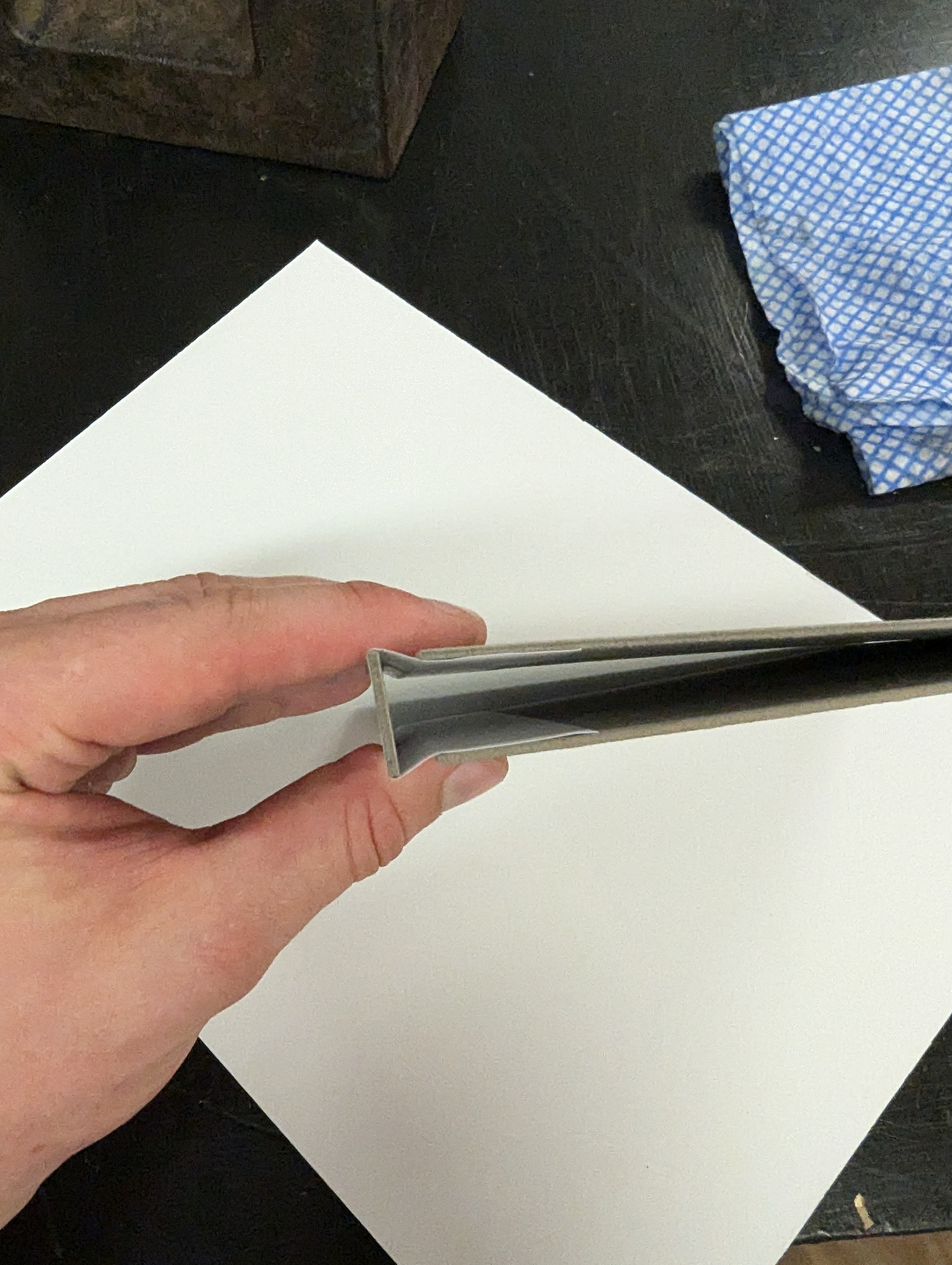

I don’t think mount board is exactly what I need, and I’m trying to work out if it’s good enough to continue? Or where I can get some greyboard or Davey board?

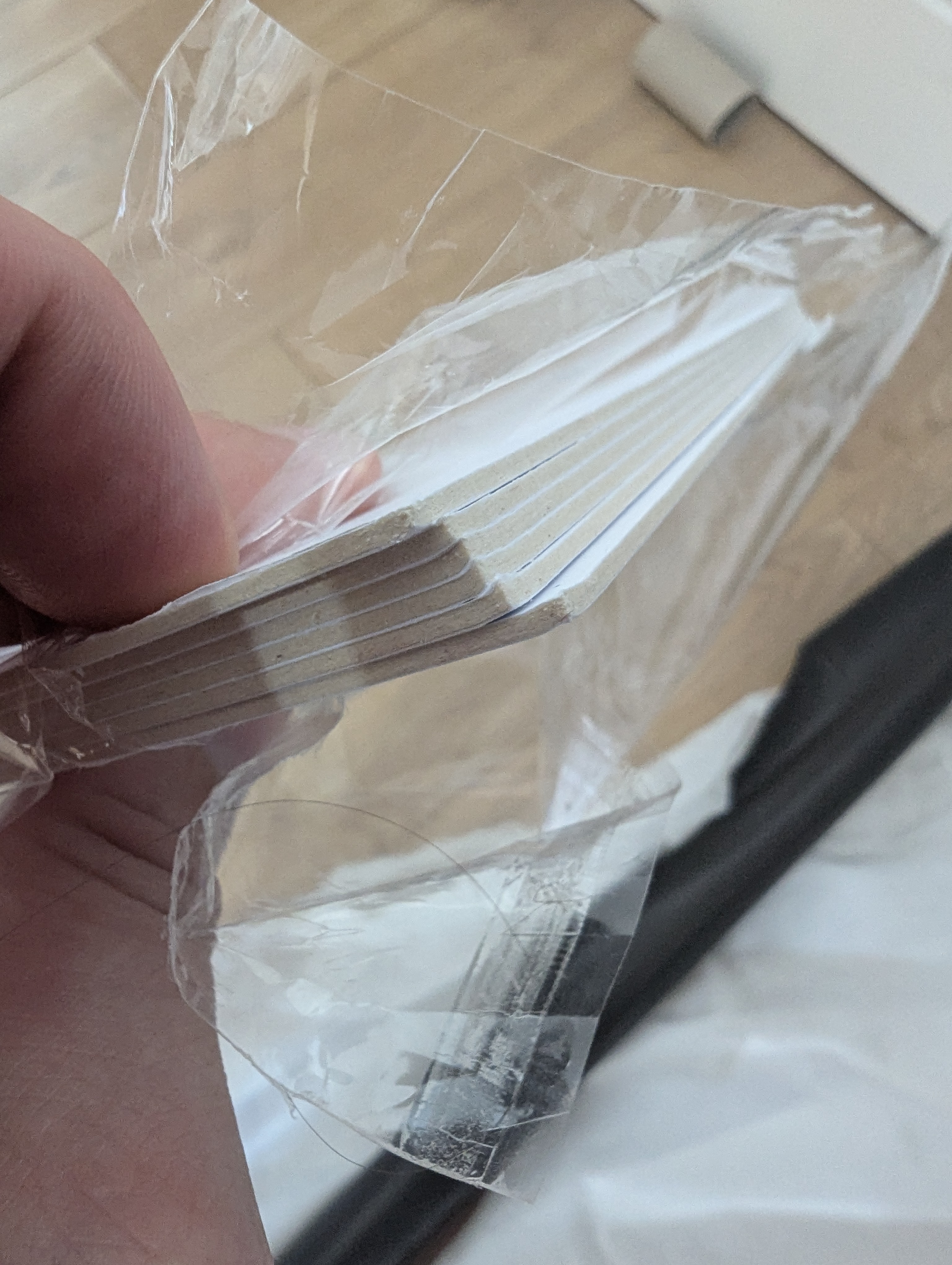

This is what it looks like from the end
Any advice from people who are in the know would be appreciated
mount board should be fine as long as it’s thick enough.

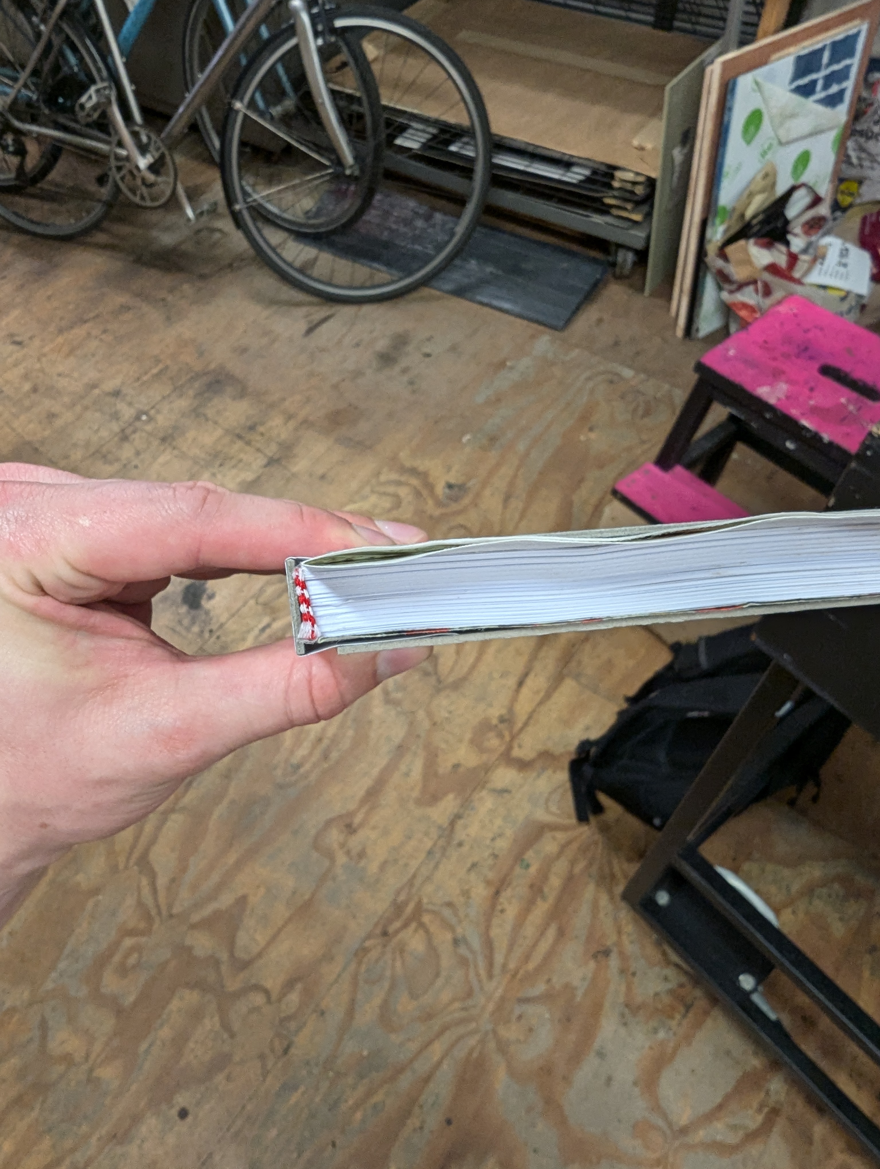

So I now have a small a6 notebook text block bound

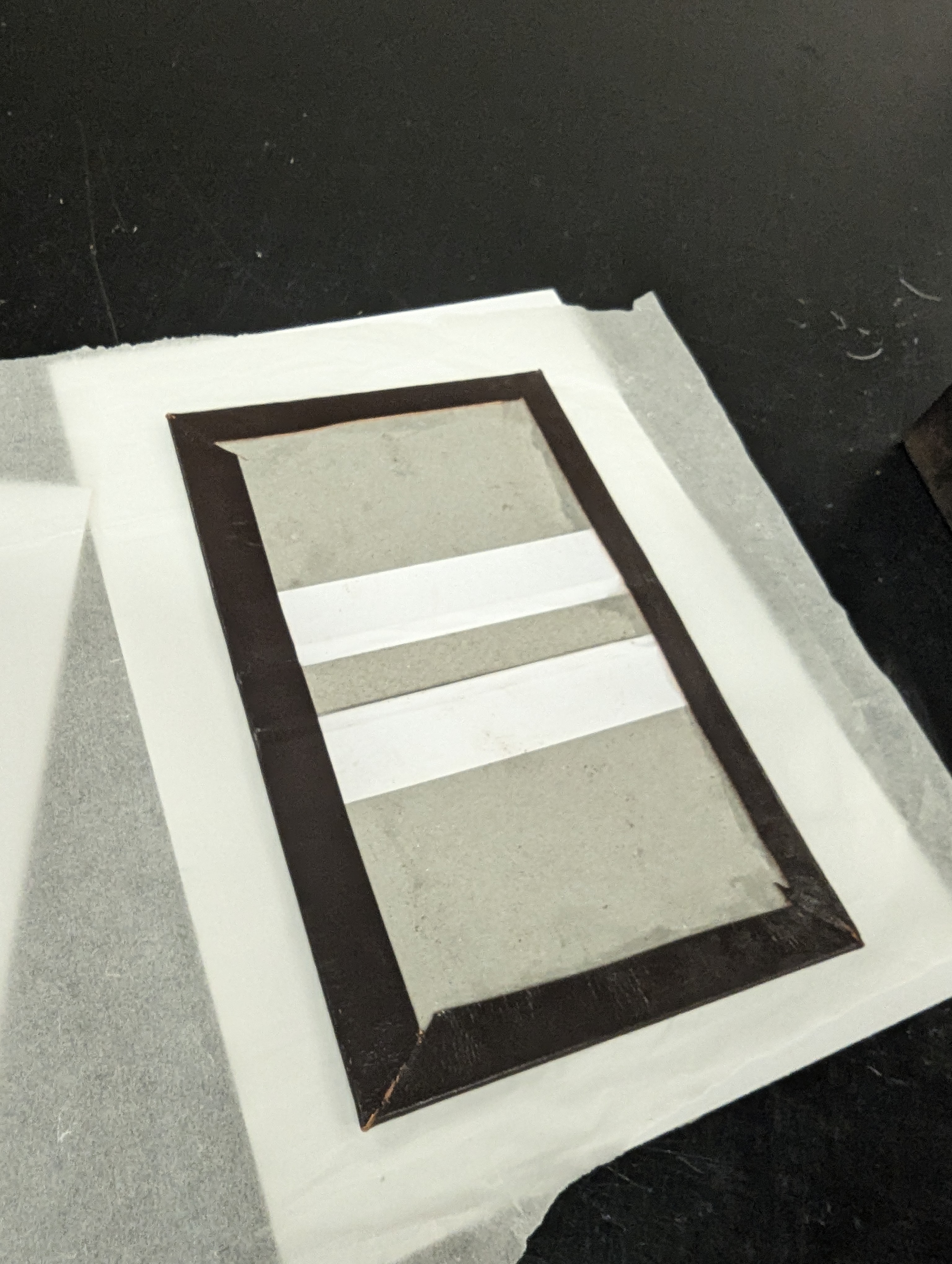

And a bradelback case cut out and glued
Looks great!
I have some sort of a leather case for my practice book

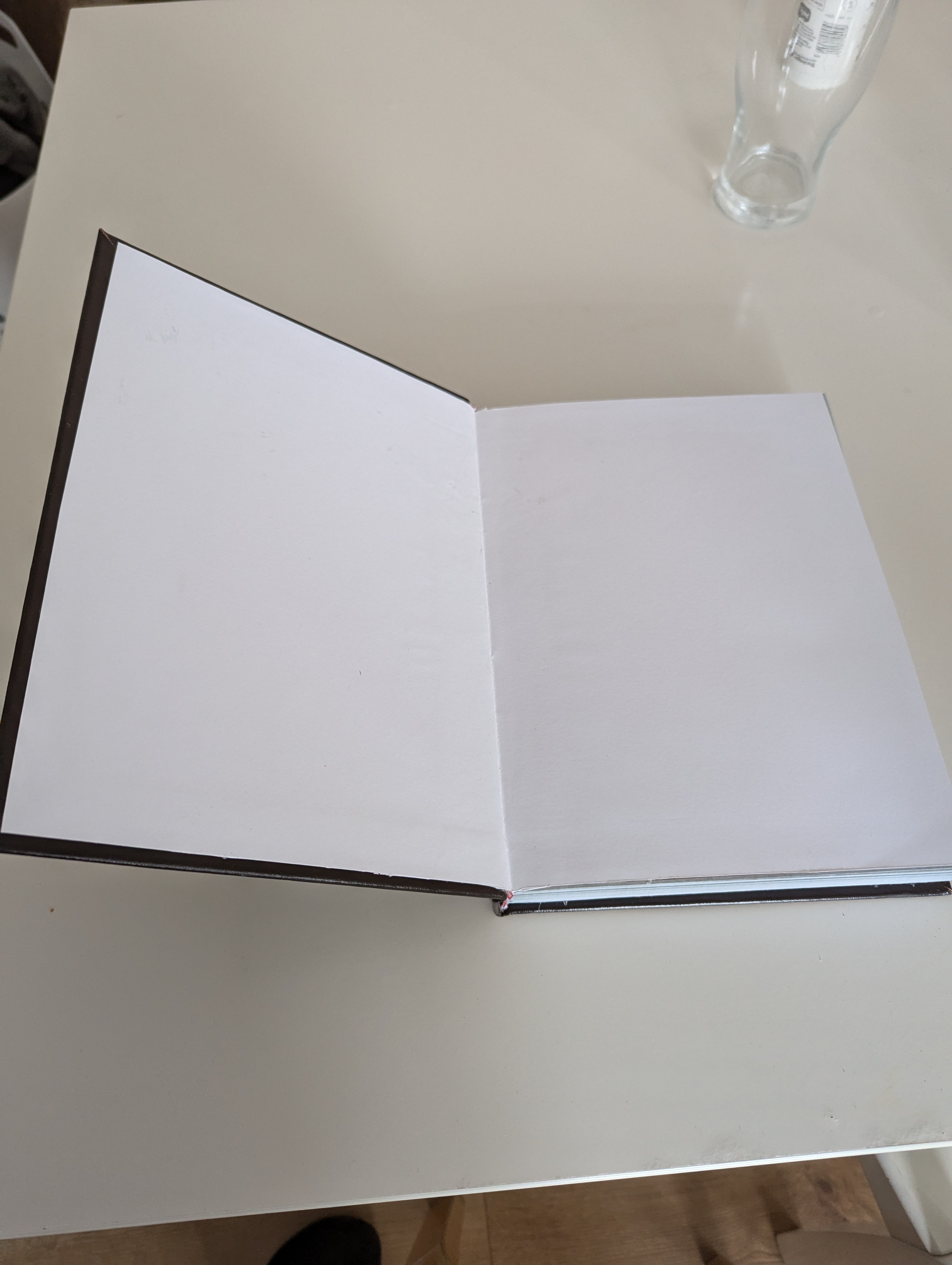

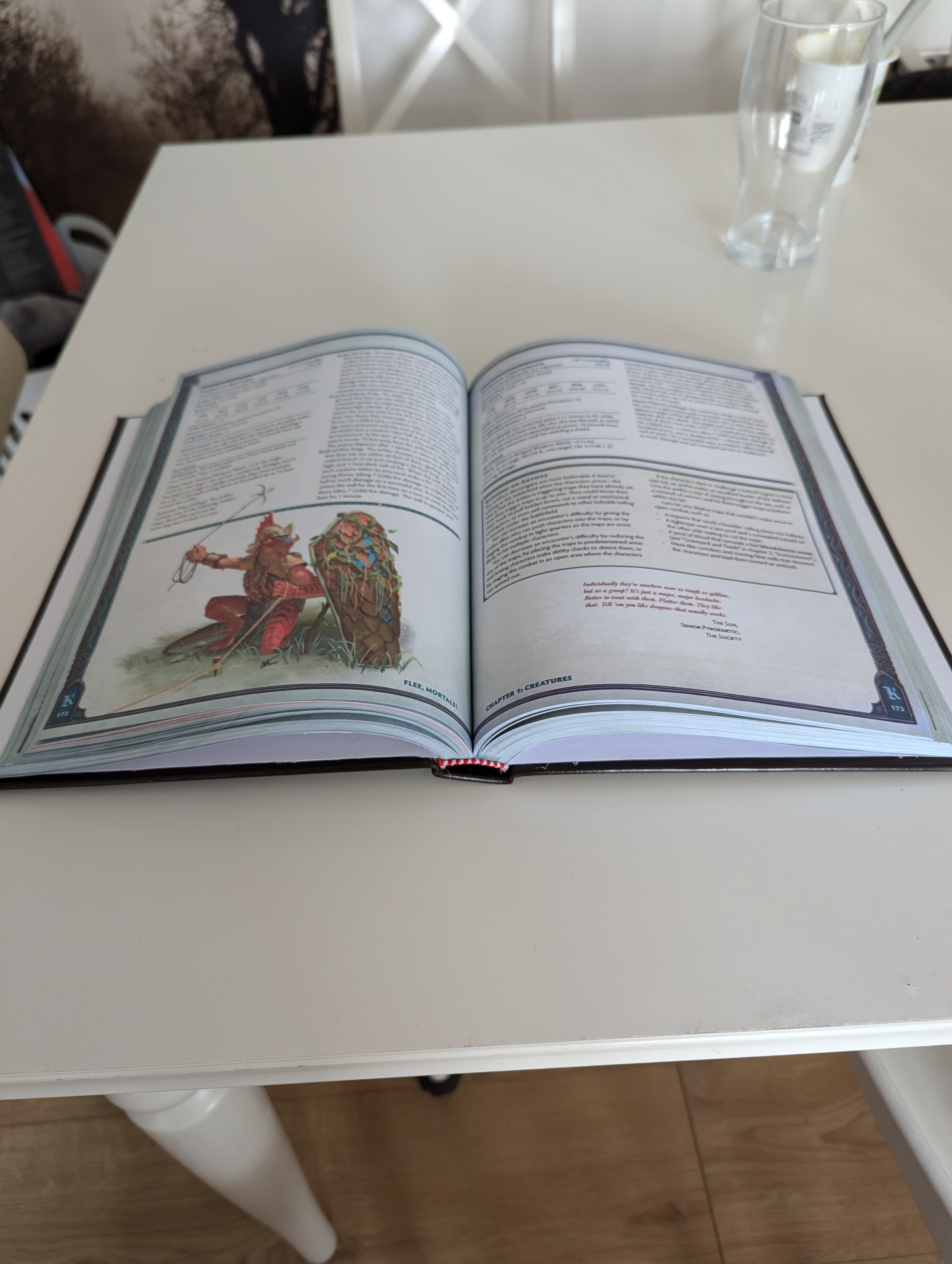

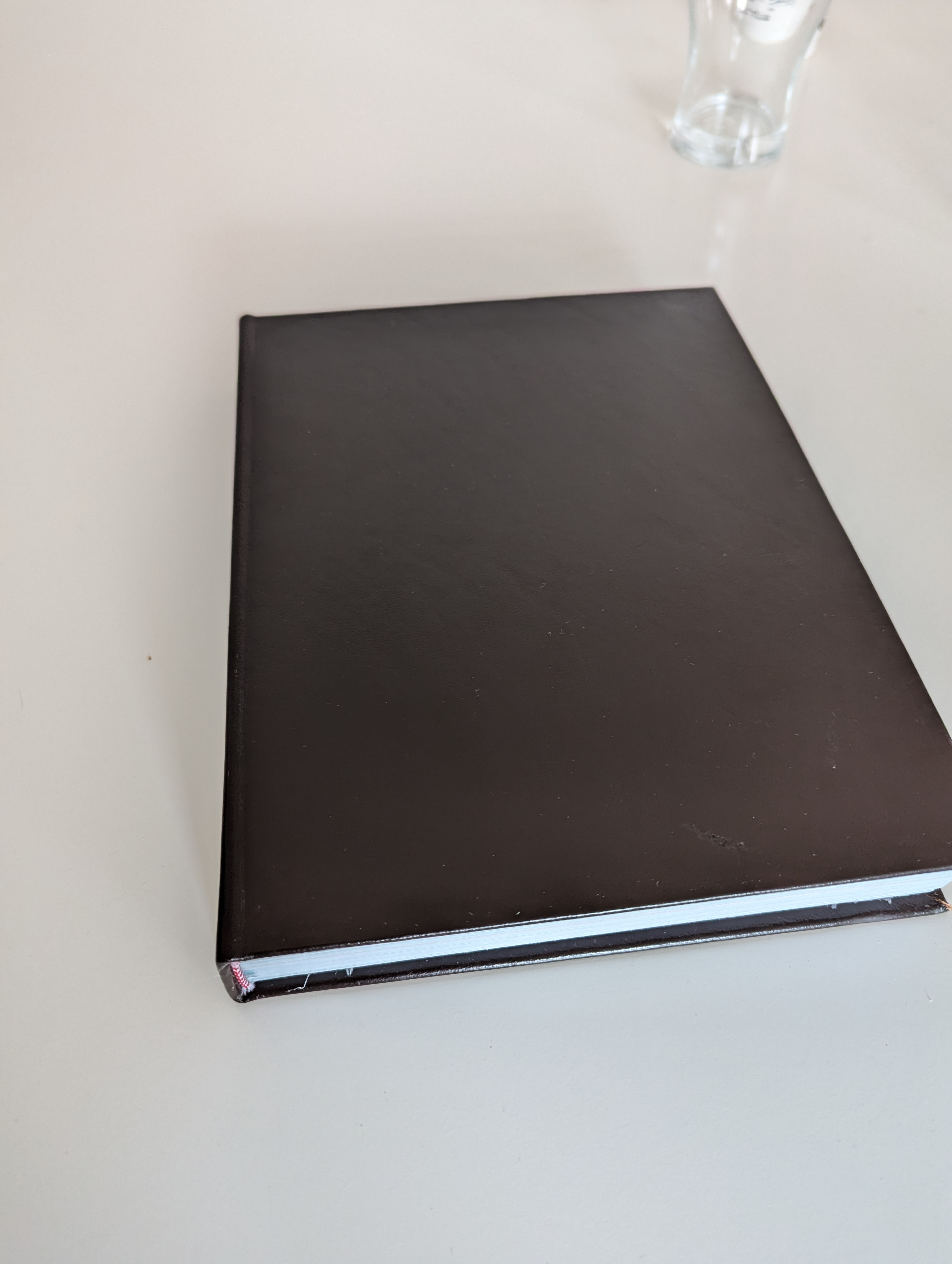

Not sure if I’ll continue with some sort of cover decoration. But happy with where this got to. A lot of lessons learned, and a big thanks to @scday94 for his help and advice throughout
Looks fantastic!!
