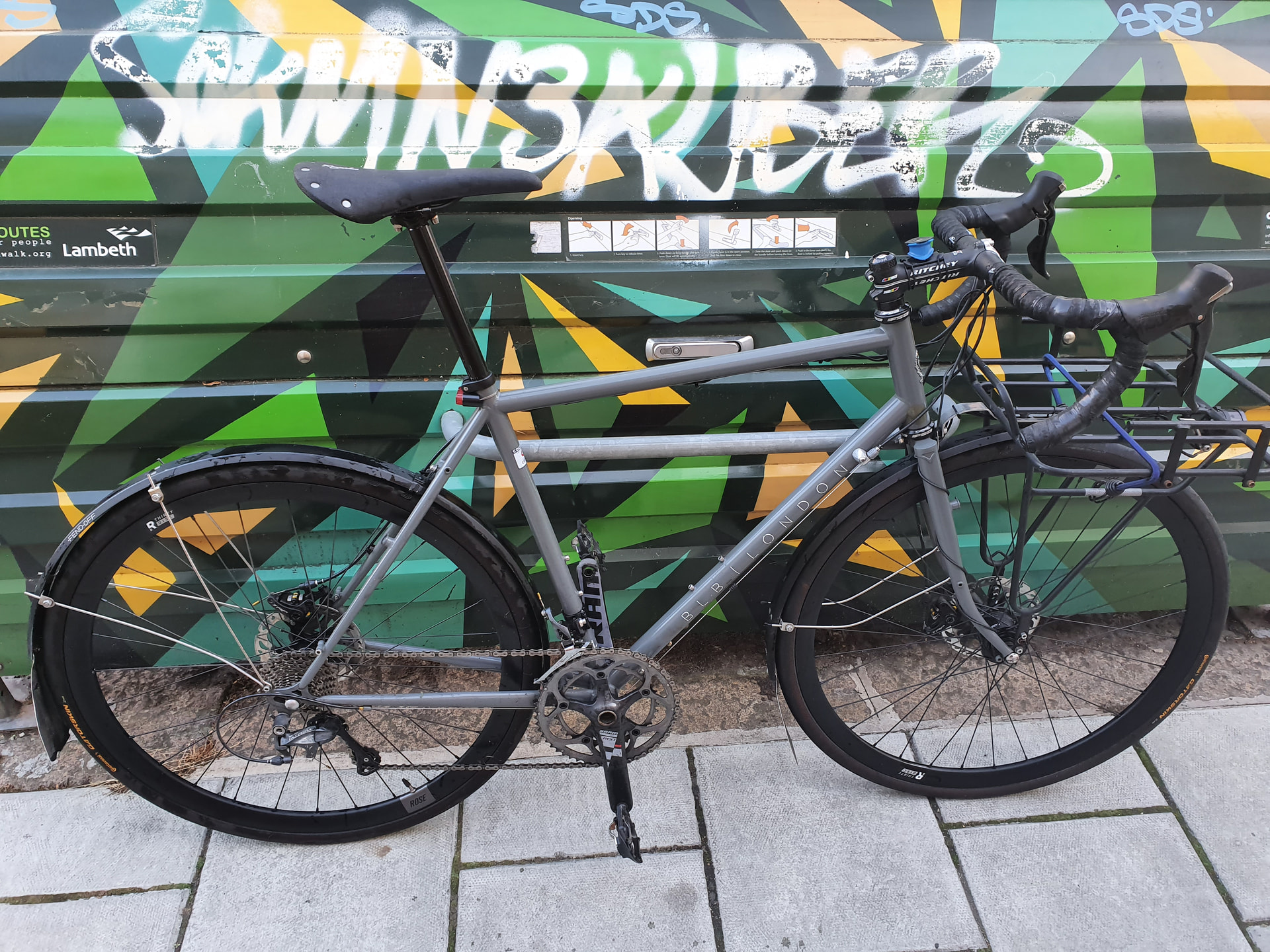

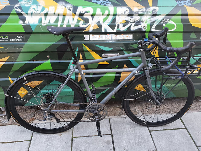

This is the bike (now running 1x)
So it’s a modern frame, inward facing dropouts rather than the track style and running with a derailleur.
It’s a normal QR axle size (6mm?) but I’m using a pinhead security axle. The tool for it isn’t great, but you can crank it down pretty damn tight and it still slips all time time. Slipping then leads to the gears working very poorly and sometimes brake rub
Sweet whip - Interesting that BLB have put that style dropout on a bike intended for gears and disks. Very unusual

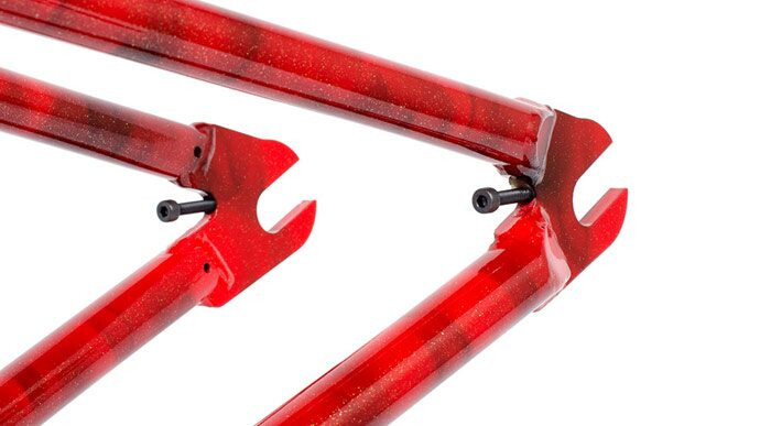

If you want to go down the modifiaction route you could look at a solution like this - BMX frames often have integrated tensioners
But thats not gonna stop the axel from slipping forwards under load.
Bicycles have had these dropouts for over 50 years and I mean at the highest level… TDF riders producing over 2000 watts of power haven’t suffered this problem. It leads me to suspect one of three things… You have a mechanical issue, wheel fitting error, or you are in line for a world record and you don’t even know it… :grinning_face:
Seriously though, I’m intrigued to know why this is happening #CanIBorrowYourWatts
I am certainly not producing that much power. Fwiw my hypothesis isn’t that this dropout type is rubbish, but I do think there is something wrong with mine specifically, to me they look quite wide which results in not much of the skewer/washer bearing onto anything. Perhaps some adjustment with a hammer it’s what’s needed. If anybody is curious and wants a look I’d bring it down at some point
Yes, that’s my thinking as well when I say mechanical issue. Please don’t use a hammer though :pray: :rofl:
Bizarre drop out choice for a disc brake, is getting the rotor aligned with the brake caliper not a massive pain?
