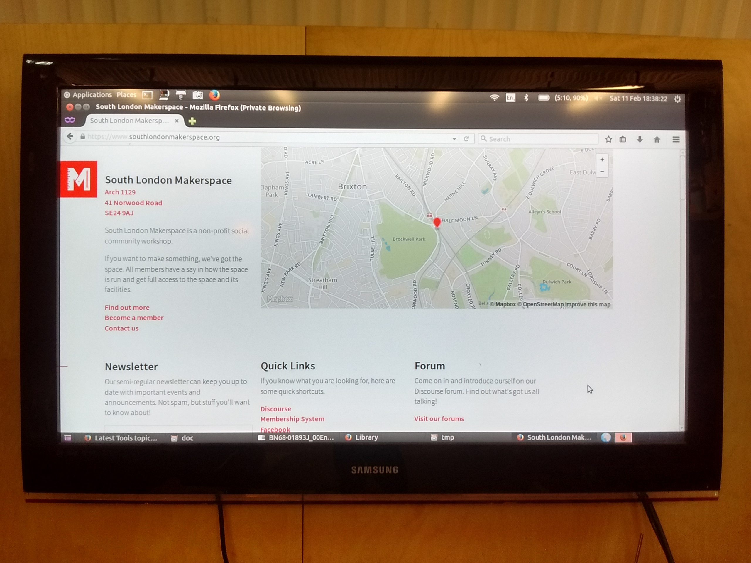

The model is Samsung le40b530p7w, a 40-inch flat screen monitor, mounted on the wall.

During Use
You plug in your laptop or other video source to the HDMI cable. The monitor will select the source automatcially after about 5 seconds, you don’t have to press any buttons at all.
Should you ever need it, you can select a particular source with the “Source” button of the remote control, or the “source” button at the little panel at the bottom of the right-hand side of the screen (viewed from the front).
After Use
Please leave the HDMI-to-HDMI cable plugged into to HDMI source 1. This is because only this source has no overscan, so you can see the whole image (which is necessary for computers and better for films).
