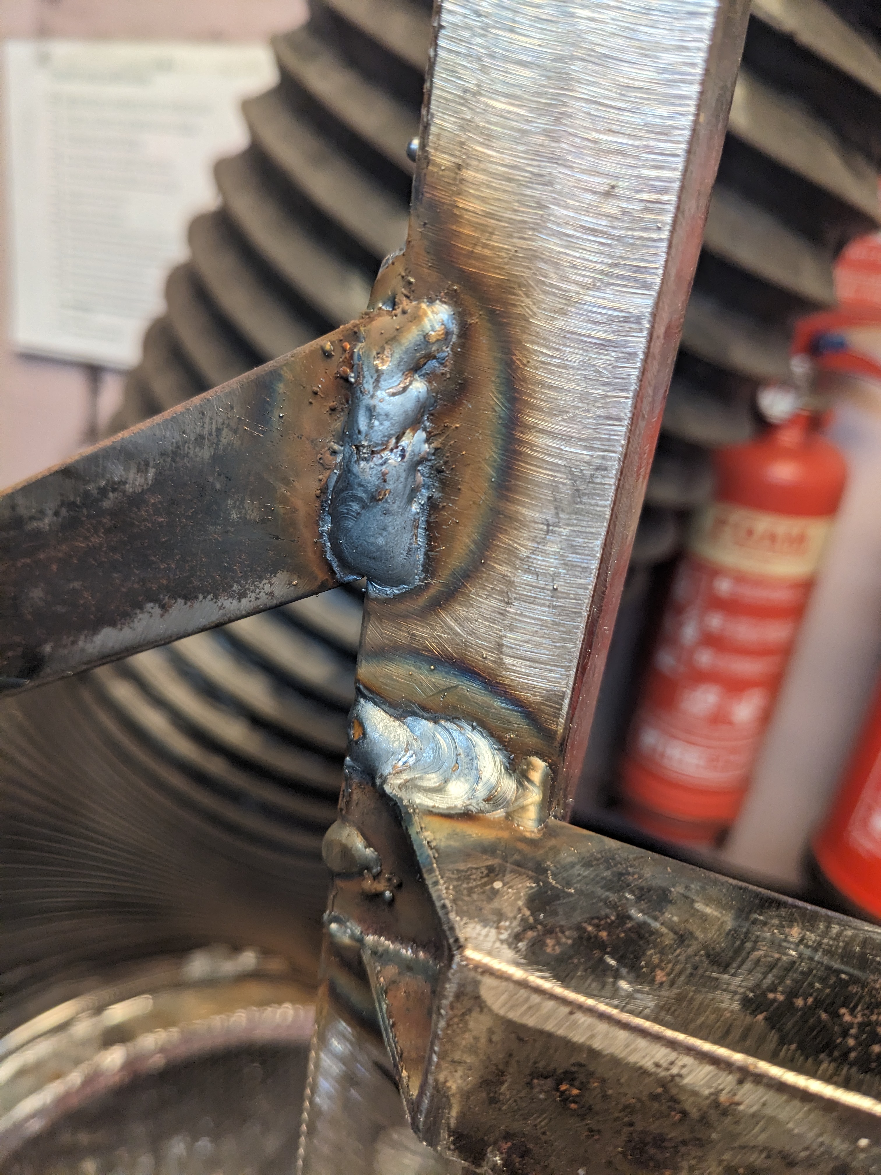

My wheels arrived today, so I was finally able to adjust the axle bearings and take some measurements for the wheel supports. I designed and cut the wheel mount bars from more if the same tubing.
To make it easier to get the spacing correct and mitigate twisting between tubes, I clamped up a weld jig. After getting the whole thing tacked up, I banged and bent the last few pieces into reasonable alignment.
Final hours of day were spent grinding off some pretty chunky welds. Overall the welds turned out better than I’d hoped after 15 years since my last welding project. Took a few tries to get the settings dialed in reasonably well. Even then, small adjustments depending on the type and orientation of the seams helped quite a bit.
