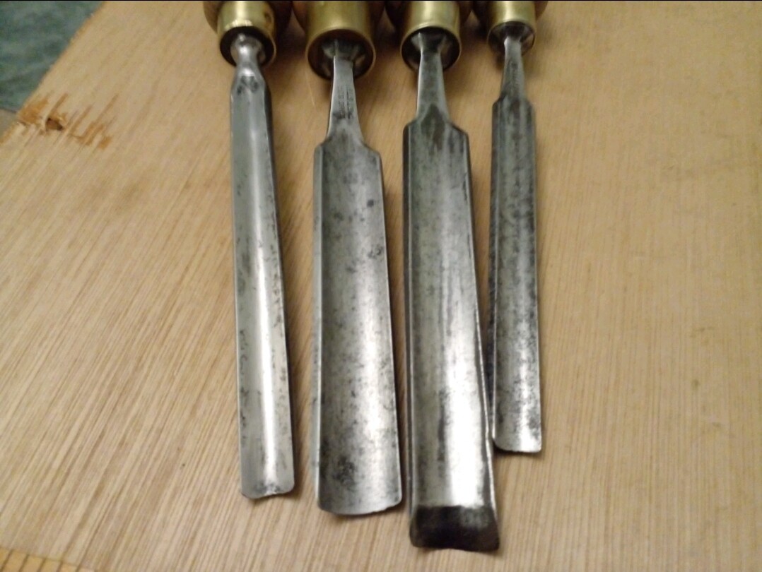

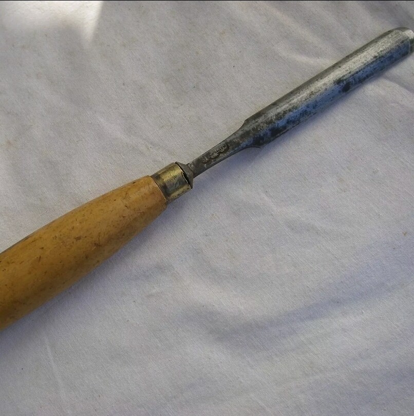

I have a couple of vintage gouges I got off of ebay for a project that need sharpening. What would be the best way to do that in the space?

What kind of state are the gouges in?

I think that’s 4 outcannel and 1 incannel right?
I think I can skip the incannel one for this project.

Those are in good condition!
