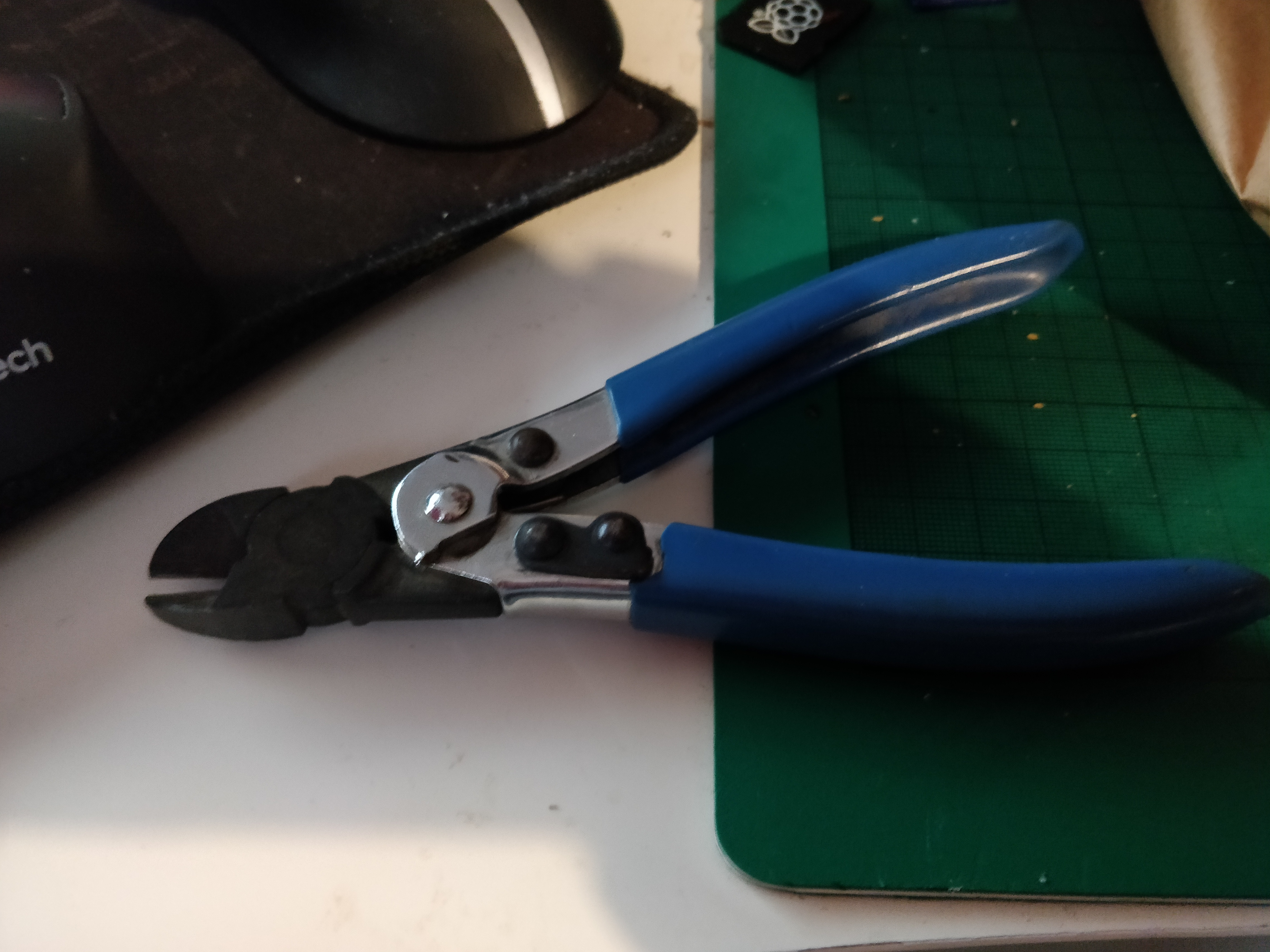

Like you I often put a nuts on the thread, this is definitely the fastest way I’ve found to restore the thread. The challenge with an angle grinder is that it cut by abrasion so it leave a big burr. I usually use my dremel cutting disk if I have a lot to cut or a normal hacksaw often work as good (if your blade cut well)

I’m very happy with the result, I’m just looking for a portable solution, so I’ll try the cutter method you suggest
