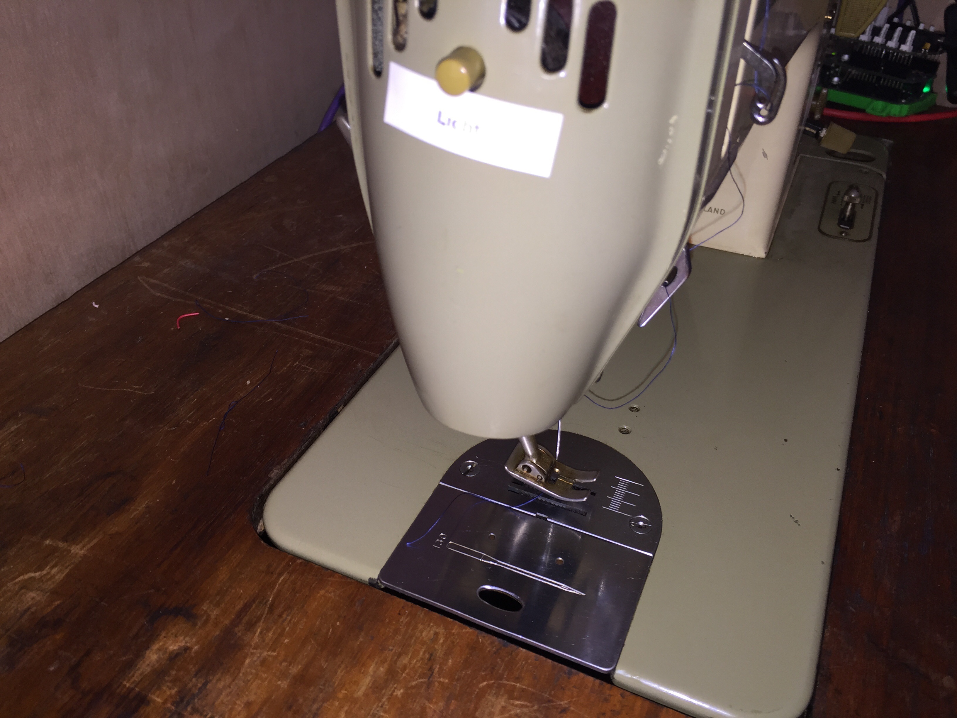

The main issue seemed to be with the bobbin side of things; the mechanism was sticking with the needle close to top-dead-centre and the result of moving through was a horrid tangle underneath the work surface.
I initially suspected the needle but as the stick was with needle up the thread doesnโ€™t really flow then. Possibly the thread was too thick but it was only general purpose 3ply cotton.

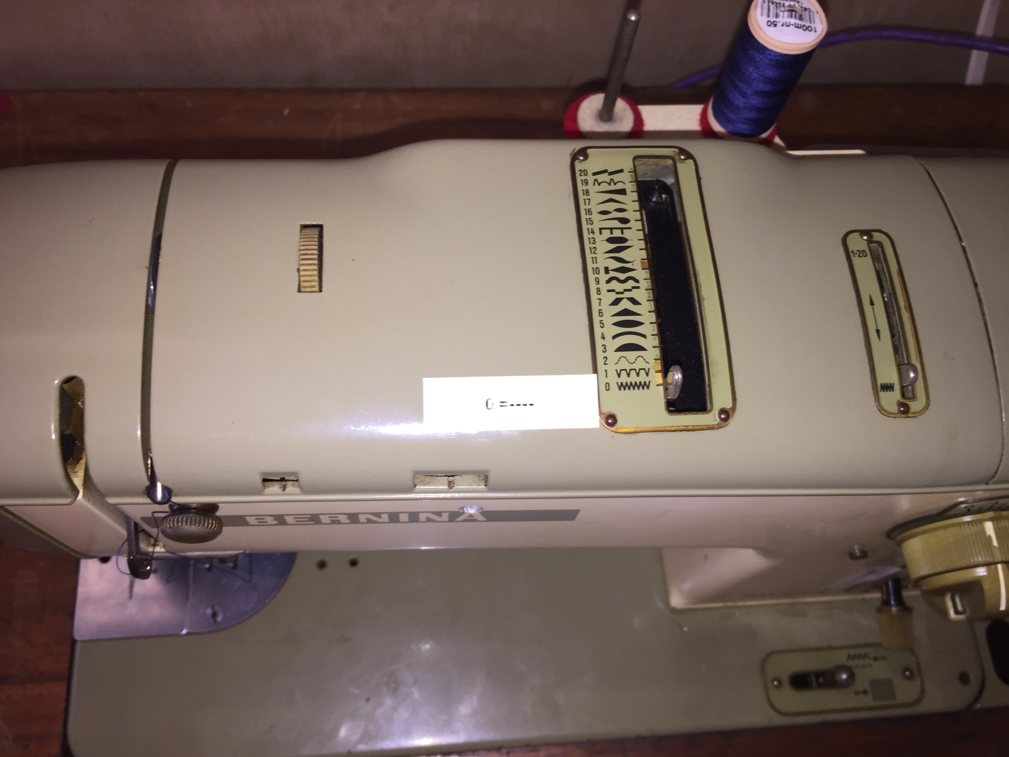

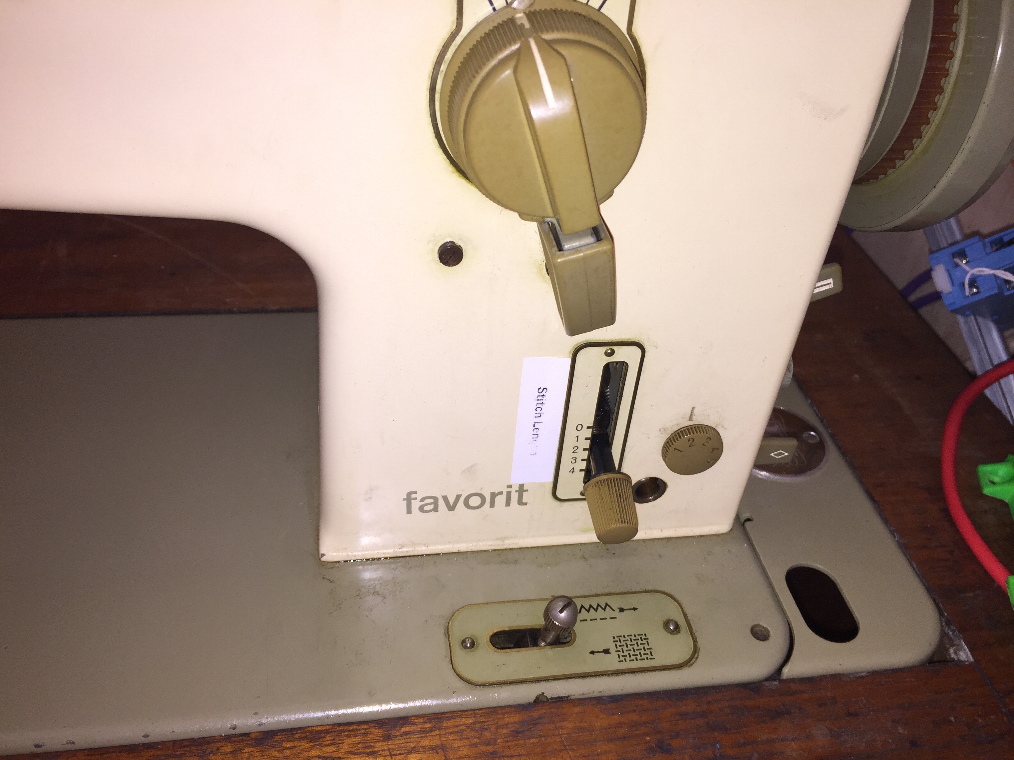

I did label some of the controls

Bobbin sits like this
Some controls
