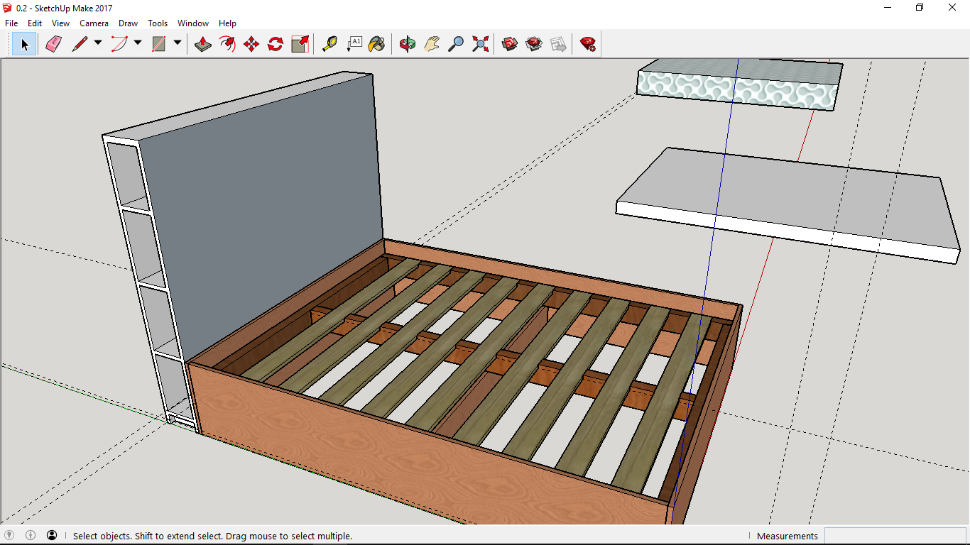

Print screen from my sketchup file - this is hopefully going to be a gas spring bed (opening across the bed) allowing me to take full advantage of the storage. I think I’m going to opt for 18mm beech plywood, but as I’ve not much experience on furniture projects any advice appreciated! The headboard will hopefully be finished using a thin layer of reclaimed hardwood I’ve managed to get my hands on, but for now I want to concentrate on getting the structure and function sorted.

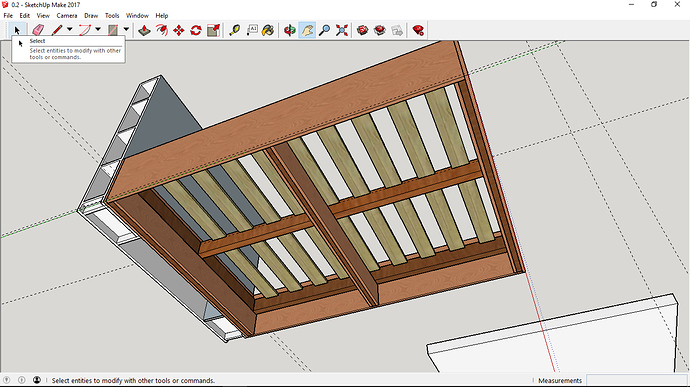

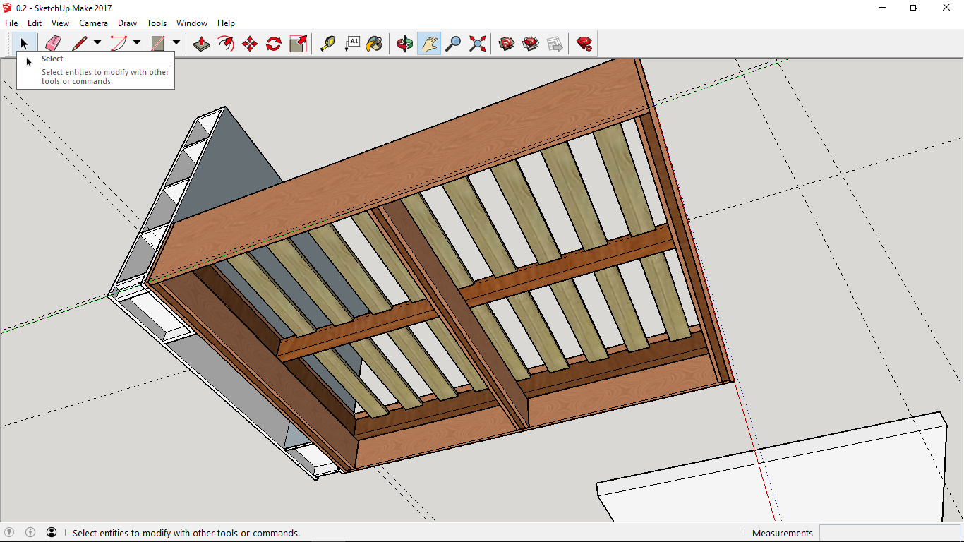

And a quick shot of the underside, showing the board and beam sandwiches which make up the head-, middle- and footboards.

How are you planning to do the joinery ?
Cheers. Nothing particularly fancy, due to the need to take it apart in the future. The head and foot boards will be sandwiched softwood and ply, so I can put screws straight into that to secure it. I will probably route out a dado for the shelves and glue the headboard together as a solid unit, then laminate the front on.

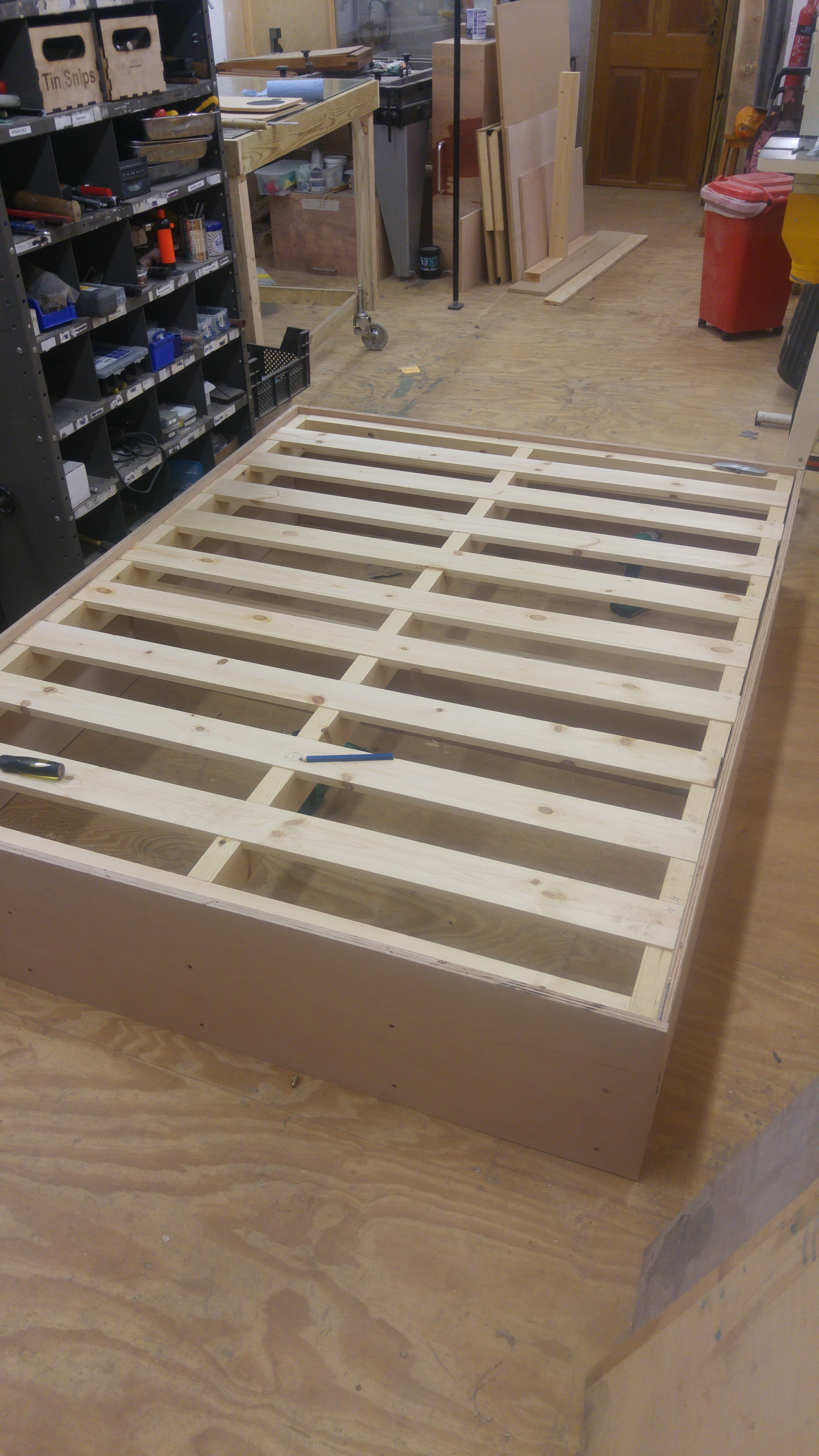

For the actual bed the slats will be set into the main frame and screwed down, and I’ll probably go for a chunky domino and screws to secure the corners. I also need to source gas springs.

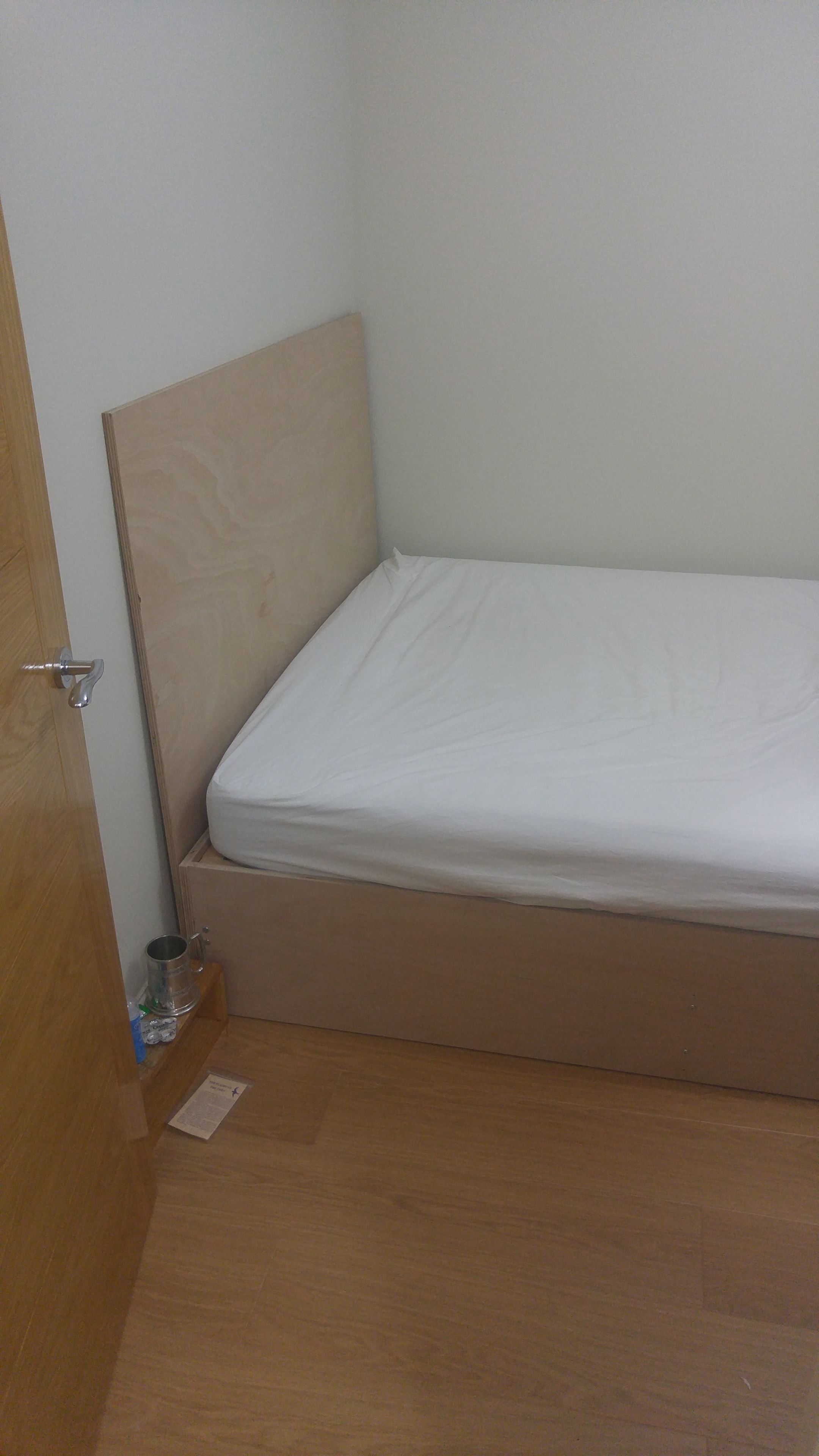

Progress on the bed: main bedframe complete and one layer of wax applied. Quite pleased so far.
