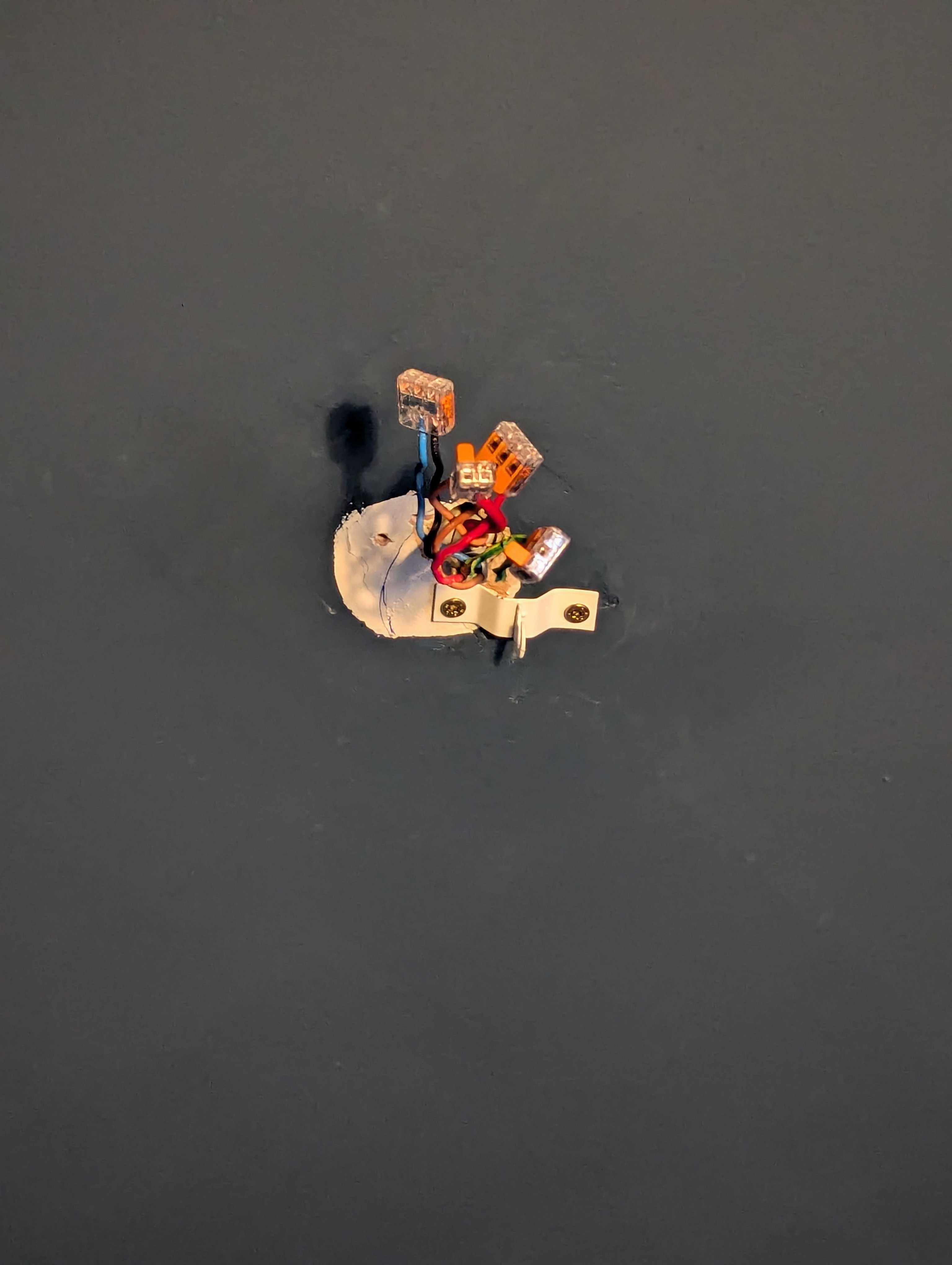

  • I’ve connected all the wiring into wago blocks and am confident in all of the connections

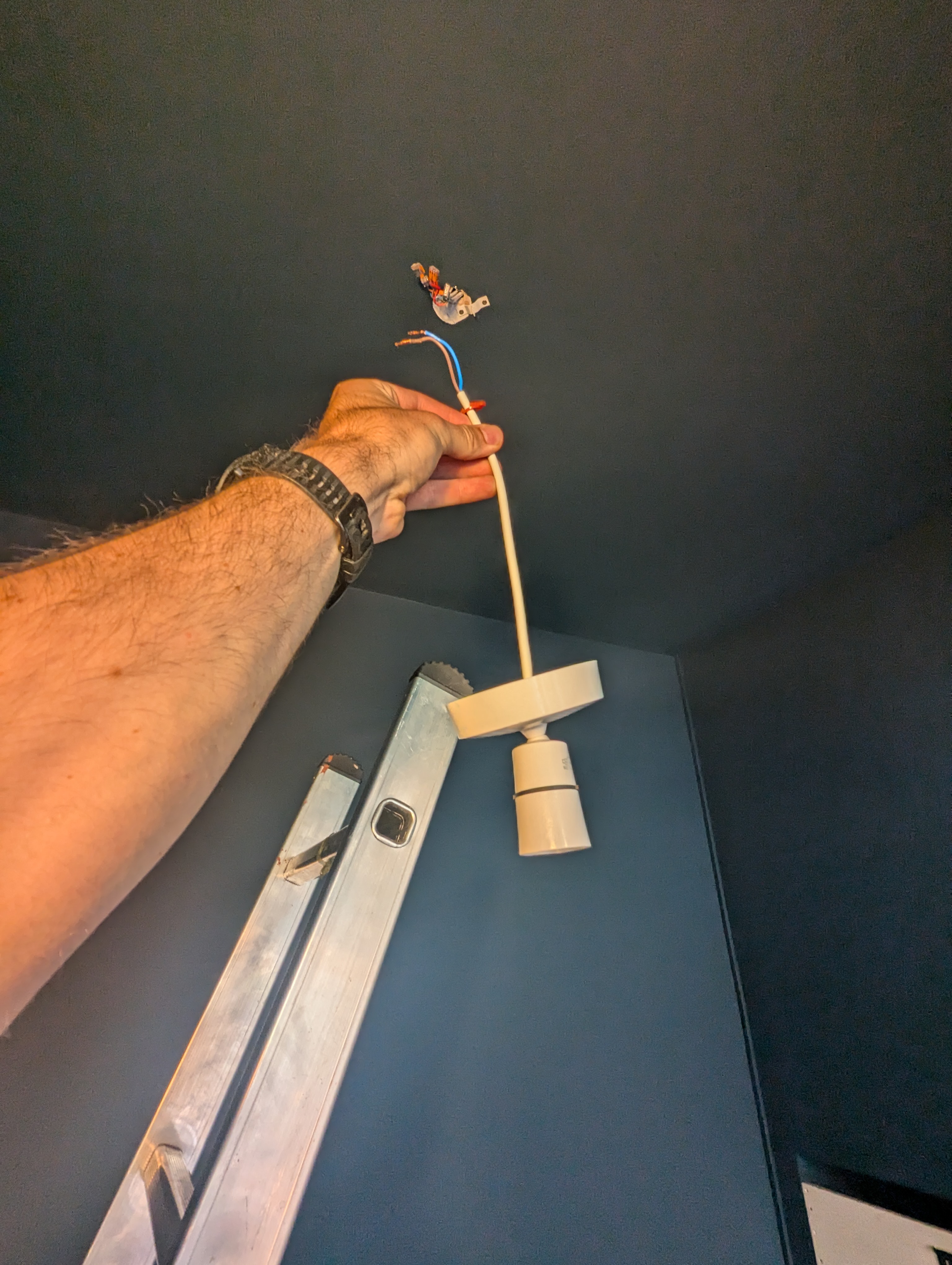

  • when I connect in the old pendant into the new wiring setup, I get 240v at the bulb end
  • when I connect the new light fixture I only get ~25v at the bulbs which isn’t enough to do anything
  • I have continuity between the ends of the wires and the bulb terminals
So, I’m losing ~90% of my voltage it seems over the light. It seems to me like the light they’ve sent is faulty but I don’t have super high conviction as a total electrical noob. I’ve also had to cut the cables and chain and stuff down to get this far so you feel you need to be sure before sending it back!

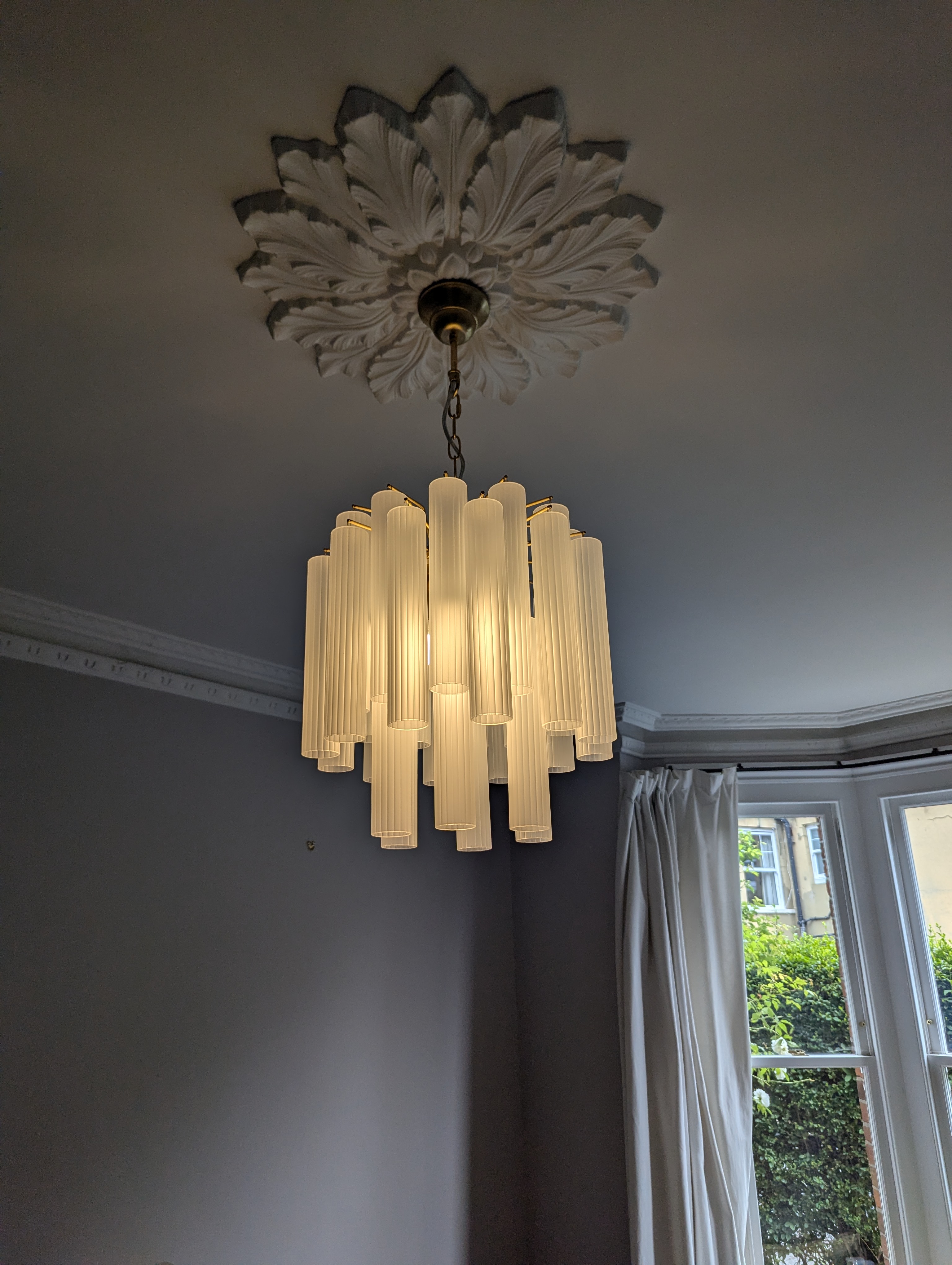

The new light is the same as the chandelier photographed above. We have one in the room already I installed a few months ago and I am now putting another up
Where I’m putting it up, there was until recently just a simple pendant which was wired with a ceiling rose
I’ve taken the ceiling rose off and put it all into wagos for the new fitting. The fitting wasn’t working (getting 25v) so I tried putting the pendant back but via the wagos as the new light is wired, this is where I’m getting 240v

The light has 4 screw bulb fittings for candle style bulbs (E14). I’ve checked the one I have installed and it has 240v
