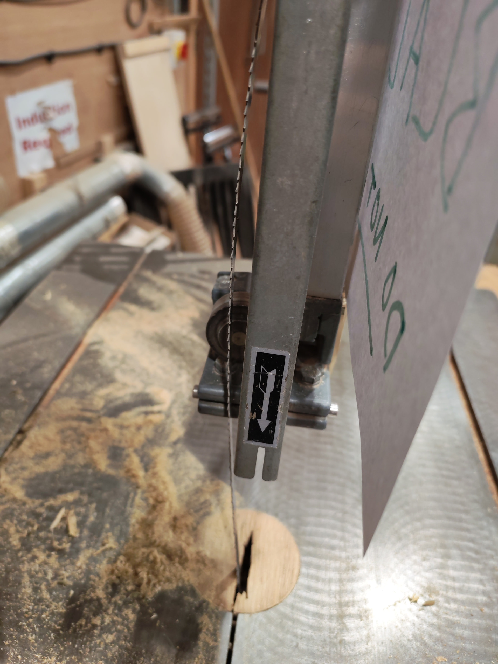

I was cutting on the bandsaw and the blade seems to have either snapped, or dislodged itself - I can’t quite tell. I’ve put a sign on the machine warning people not to use it.

This has been fixed.
It seems like the tension on the blade was just way too low and it fell off the wheel. I put it back in and put a reasonable tension.
