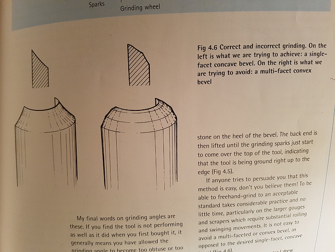

To add to this I noticed on Monday eve that the roughing gouge had been sharpened incorrectly. Probably an easy mistake to make but it really does make the tool ineffective. It should have a single concave bevel and at the moment it has several convex bevels. I’ll try and feed this stuff more into L2 inductions…I understand there are a lot of different gouges and it’s not always easy to remember.
I say done… didn’t feel like doing aall the grinding, took a little more off post turning so it’s a fresh edge, will continue doing a sharpen each week, should be a clean single bevel in not too long…
