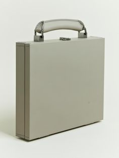

this is the reference image i’ve been given. it needs to be about 40x30x10cm. for the action in the short film, it needs to be very durable, able to be slid across the table, dropped, slammed shut, etc.

My first thoughts are structure, would you want leather bound to a thin plywood box? if so you could some cheapish sheepskin and staple it to the inside, if its being opened up in the short film youd have to consider an inner lining and what you’d want it to look like
There are youtube guides that can help with hand sewing handles like in the image, and screw down closures can be ordered online, J. T. Batchelor in Dalston is also great for hardware, tools and the like.
