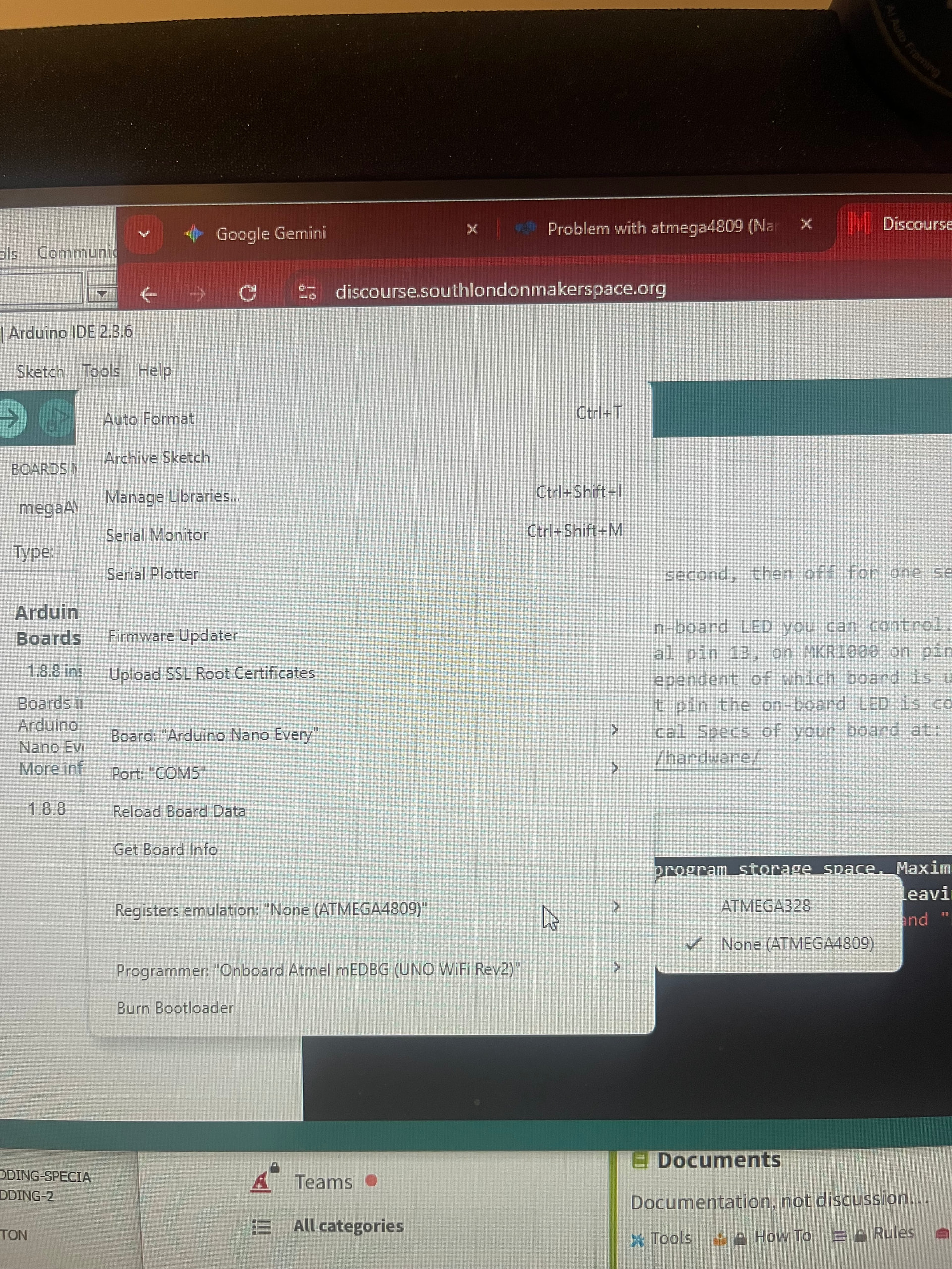

These are my settings, I’m getting the new following error on windows after trying to set the processor to the 4809

For the programmer - the only option I can see when using the rest of the settings for the Arduino nano every to select is mEDBG,
Try changing:
Tools → Programmer → AVR ISP (any)
Do not use Upload using programmer. Simply Sketch ->Upload
Programmer only has the following option nothing else to choose -
Onboard Atmel mEDBG UNO Wifi Rev 2
Which doesn’t sound right as this isn’t an UNO and doesn’t have wifi.
Is there a library or something i should download to get the programmer to see more options?
I had lots more programmer options when using Arduino nano vs Arduino nano Every, but the code didn’t work then either

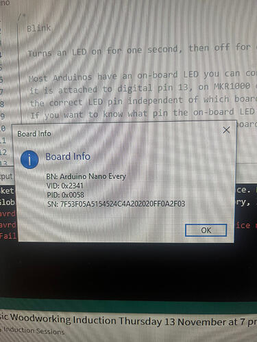

Can you share the result of Get Board Info" ?
This is a misconception. You can - for now - ignore that setting, since you are not using a dedicated programmer - confusing at the beginning, but you’ll understand that soon.

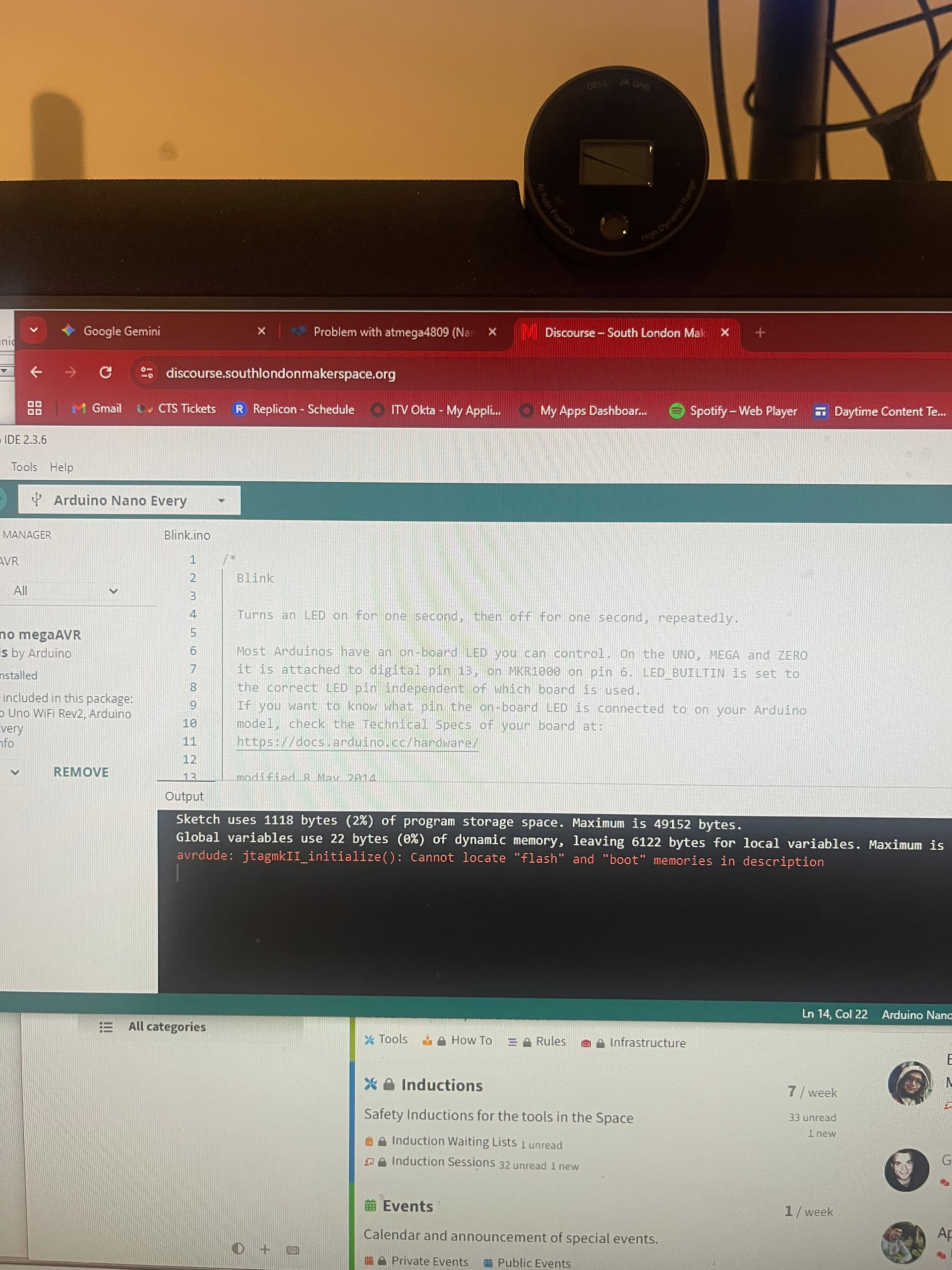

Tried all of that and getting the following error
avrdude: jtagmkII_initialize(): Cannot locate “flash” and “boot” memories in description
Is it possible, that you actually have successfully flashed the Every and it is blinking away??
You probably have seen this, just posting in case.
https://support.arduino.cc/hc/en-us/articles/4405239282578-If-you-see-a-jtagmkII-initialize-Cannot-locate-flash-and-boot-memories-in-description-message-when-uploading-to-Nano-Every
You are in fact right here, I read through that doc and the code is actually working. The blink programming is seemingly impossible to determine being different from the general blinking that the nano every does so I couldn’t tell it was working.
I used strandtest on a set of RGB LEDs and the code is running fine!
