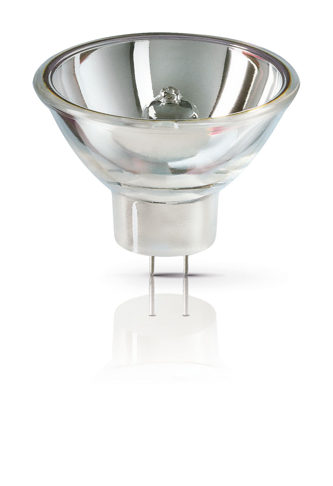

Just bought a couple of these 100 watt bad boys for a photographic enlarger I got off ebay but looking at the power ratings and lifetimes (only 50h!) I’m considering how hard it would be to convert something like this to LED, for both heat and lifetime of the bulb reasons.
I have no idea though if it’s sensible to keep the rather bulky 12v (AC) power supply and fittings or try and find something else with the same dimensions and wire that up inside the head instead. There seems to be a fair bit of room, presumably for airflow currently so I get the feeling it might work, assuming I can find something with a similar colour temperature and brightness.
I’m totally out of my depth with working out what bulb might work here, datasheets all seem to be lacking lumen values and I’ve just glazed over trying to google for things and getting useless repeats of things I already know.

This is the ‘official’ datasheet for the bulb you’ve got:
The colour temperature is 3330K which is probably the same for all enlarger lamps (mine has the same specs, although it runs at 15V, which is the first time I’ve seen that).

You could potentially find a way to replace it with LEDs, but you’d have to build something like a diffused lightbox that goes directly above the film - a bit like what the Intrepid people have done with the enlarger mod for their large format camera: https://intrepidcamera.co.uk/blog/introducing-the-intrepid-enlarger The challenge there would be to ensure you get a good diffusion with no bright or dark spots.

It sounds like I need to go to a lighting shop and talk to someone friendly there. If I can get a reasonably similar brightness bulb with the same housing then power supplies etc might be a pain but should be solvable with a bit of help. There’s a lot of space in the existing one too, I almost wonder if I could add rectification to mine.

But let me know if you do manage to get it working with an LED bulb, it’s an interesting experiment. Bear in mind that the LED bulb is going to produce some heat too, certainly not as much as the incandescent one, but will still need some ventilation so you probably can’t cram too many electronics next to it.
More and more it just doesn’t seem like it’s worth it. I’d have to rectify the AC to dc, which might at a pinch fit in the existing transformer case but also find something of a similar brightness, from a reliable (i.e. not ebay) seller with a high CRI and in roughly the same form factor.
Given all the problems involved it seems like it’s just more sense, unless I start my own print shop, to just use the halogen bulbs.
