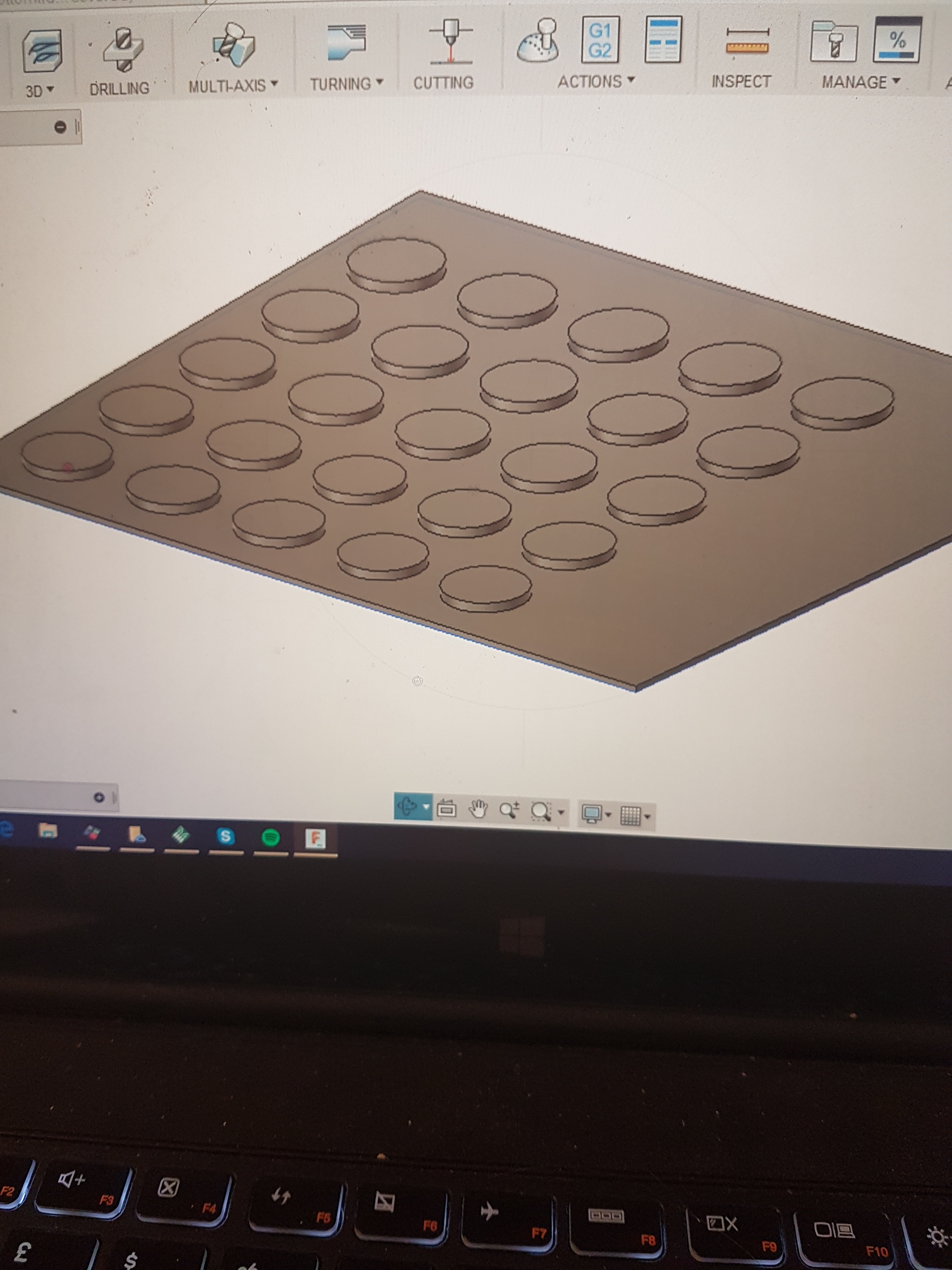

I am currently trying to make some endpieces for some electronic bagpipes I’ve been working on. This starts with a sheet of acrylic, which is then milled to give outline of 25 endcaps, then laser etched and cut. However, using the metal mesh sheet as a base for good allignment on laser is proving difficult - and my tolerance is quite tight (±0.2mm would be good). What generally happens is I put a sheet in top left corner, with a spacer to hold the top corner of sheet at 0,0, then the first cut or two goes ok but then the weight of the sheet changes as bits fall off and it shifts by 0.5mm or so - enough to ruin the rest as they are slightly misaligned. This is amplified as the metal mesh rises slightly at the edges.
Does anyone have ideas how to do this process better?
Images of the sheet design after milling and after lasering are below - thanks!
