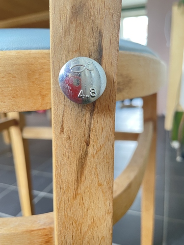

Hello lovely people. Looking for some advice. I’m working on some old chairs that have visible M8 coach bolts, which need to be replaced.
The M8s I’m finding for sale have a 20mm head which look too big in situ. The M6s available have a 15mm head but I’d need to redrill.
Would you a) just drill out a wider diameter head recess and accept that the heads look a bit big.
Or b) fill the holes and re-drill for an M6 bolt. Is there a way to do this which won’t lead to the filler deteriorating over time? The bolts are load-bearing so it’s important they stay firm.
Thanks!

Thanks @mbg, @Ryanf. Not sure I trust myself to make a decorative job of the grinding! The dowel could possibly work - I might attempt just one and see if it’s possible with the shape. As you say, it is slightly curved so drilling will need to be on-point.
@dannz I’m intrigued by the possibility of making an M8 sleeve. The slight complication is that coach bolts have a square grip just under the head that you hammer in. I imagine it compensates for the lack of head notch when screwing on the nut.
