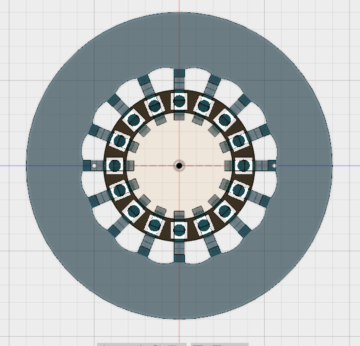

LEDs
I’ve got myself a little Neopixel ring to play with, since the form factor is nice and portable (unlike a floppy strip of LEDs). Unfortunately, it requires 5V, and the Teensy is 3.3V only, so I’ll need to sort out a level shifter for that.
