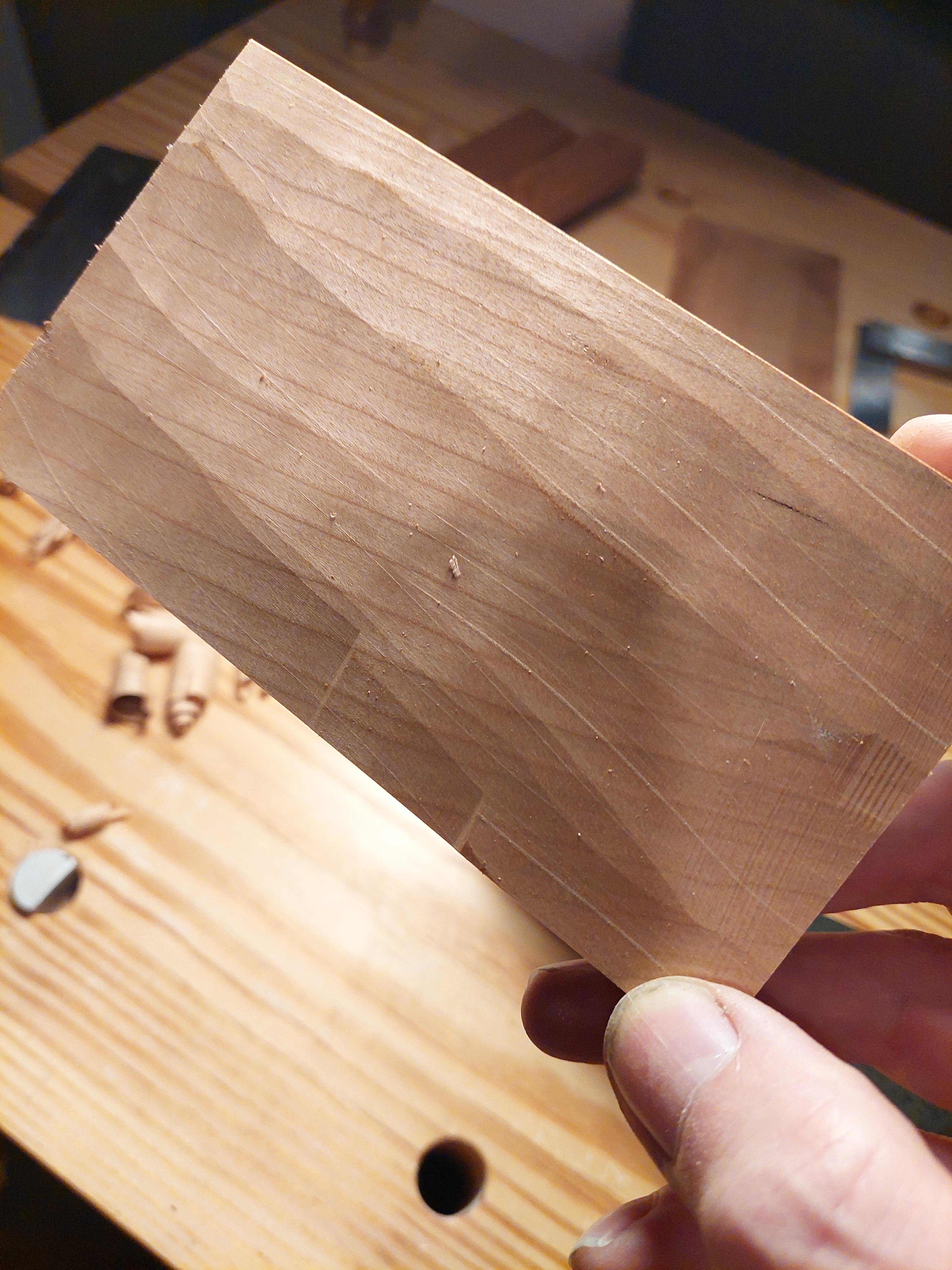

I remove the wind by planing a triangle of wood from each end of the wound wood.
I have shown it roughly marked in the photo.

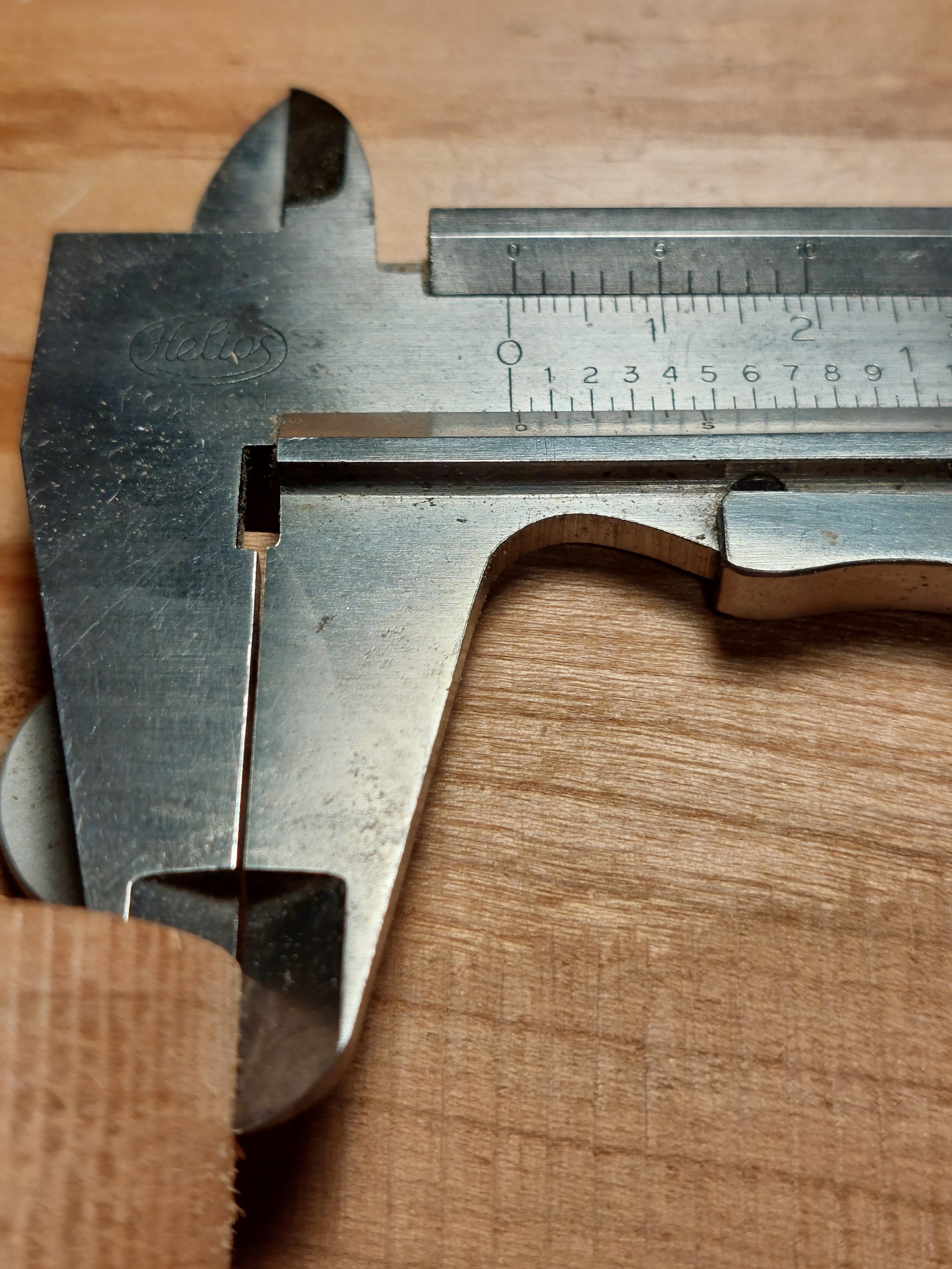

I managed to squeeze 6mm thick, components from my resawed banana boards.
