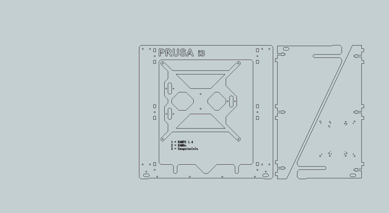

First we need to see if there is enough 6mm PLY in makerspace for cutting the frame
frame-6mm.dxf (558.9 KB)
frame-6mm.pdf (232.5 KB)

How much is suitable sheet metal? As the offer from @Jonathan seems too good to pass up
presumably 6mm alu. would be ideal, but depends whether welds are needed. @laurent_muchacho?
I understand the motivation and all my PrusaI3 have alu frame however this project cost estimate is made in mind to use 6mm ply cut on the laser from the space on a do it ourself basis the frame once assembled and with a coat of paint to seal it offer a good platform to complete the cheap Prusa in a reasonable amount of time.
If some of you want to go for the alu options go for it but bear in mind that it will be outside of the scope of that cost estimate
Based on the current blueprint only M3 20mm socket screw and nuts are required.

Do you have this as a dxf?
dxf version attached to the original post
