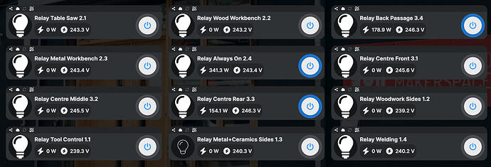

From what I can see, it looks like not all the lights are on and the physical changes in the space probably haven’t kept up with the strings of lights:
I’m guessing it’s 1.3 that you are missing, I’ve just turned it on, if not let me know and I can turn on 1.4, these should be mapped on switches.

I think the one that is misbehaving is 3.4 but some lights in the snug are on almost all the time while the last 2 (above compressor and above bandsaw) are off all the time.
Sounds like a mismatch in the actual electrical connections.

It is 3.4
Half of the sensors have gone missing, the one in the snug (by messy room/snug door) was the last one to control those lights.
They are the only ones not switched.
I can add them to one of the switches in the metal area if you want
YES PLEASE!!!
If I can choose, can I have them on the 1.4 welding?
Thank you so much
So do you want them to turn on and off when 1.4 welding is turned off?
Yes, if it’s possible.
I am not that fussed on what switch controls them as long as I know, and I am able to turn them on.
All done, give it a try when you are there and let me know it works
