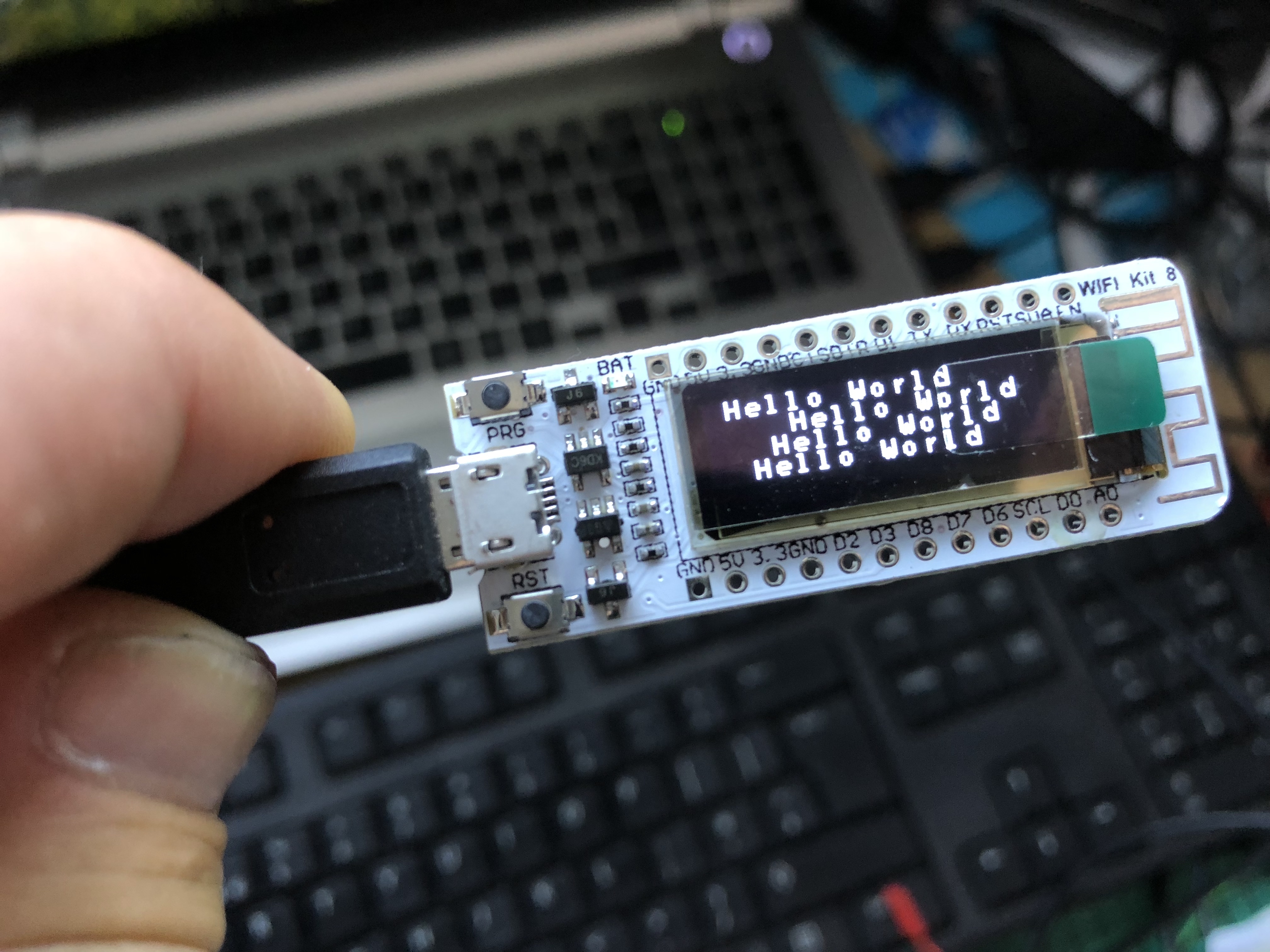

Sorry, came to this thread late.
This is an oled with esp8266 (Arduino compatible) in one unit. Far easier than trying to drive the unit yourself…
Courty
They are cute…
It’s big brother has the square display and an Esp32 !!
Courty
Do you know what the display is? Clearly going to add one to my esp32 project board.
