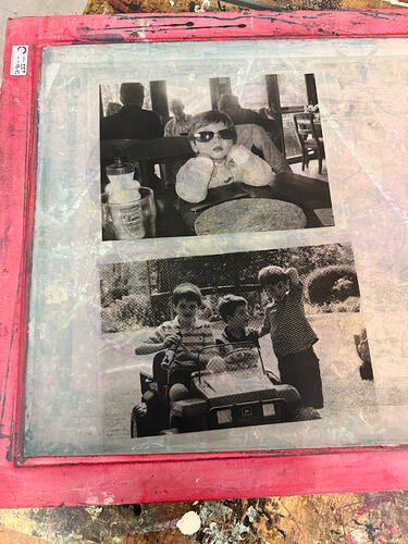

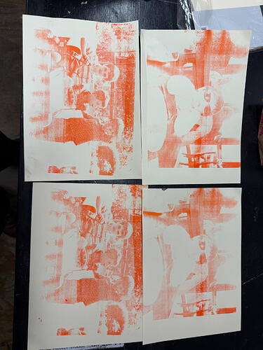

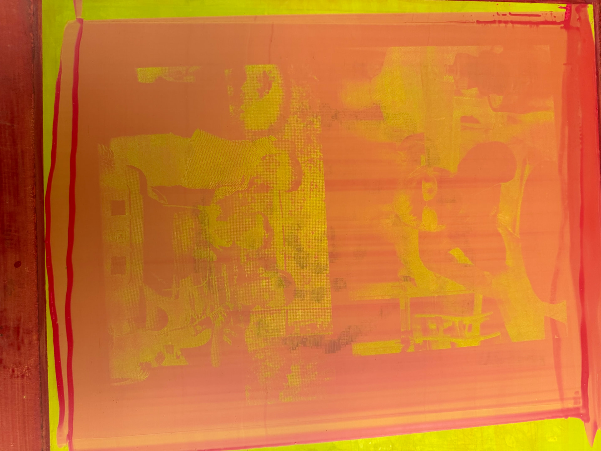

Hey guys, having trouble with this print! I’ve messed up the exposure time a few times but I think this try should be ok. 1st try the coat was quite poor which left patches.
2nd try was definitely overexposed but the coat was nice and even
Hunting for general tips really if anyone has any thoughts on what I should do for something like this with possibly too much detail
@silkscreentechs @screenprinters
Messed up exposure time? It should be standardised on 3 minutes and not something to really alter at all.
Are these laser or inkjet transparencies? I can’t tell from the photo but they also have to be 1 bit images, either black or transparent with no grey at all, all intermediate tones with dithering alone. This looks like it has a lot of fine detail that might be a bit of a challenge.
Inkjet! I’ll keep it at 3 mins this time because my coat is good
Black and white, I think it’s the fine detail that’s proving to be tricky but there isn’t any grey in there
1 more run should do the trick
It’s getting into the weeds but your mesh size should be the size of the raster when you’re exporting the artworks. Try it on a 77 mesh screen. You might just be a bit too ambitious on this for now though.
Looks like it’s just too much detail for the size and mesh count of the screen! I would reprint larger halftone pixels or do one of the images but twice the size and see how that goes.

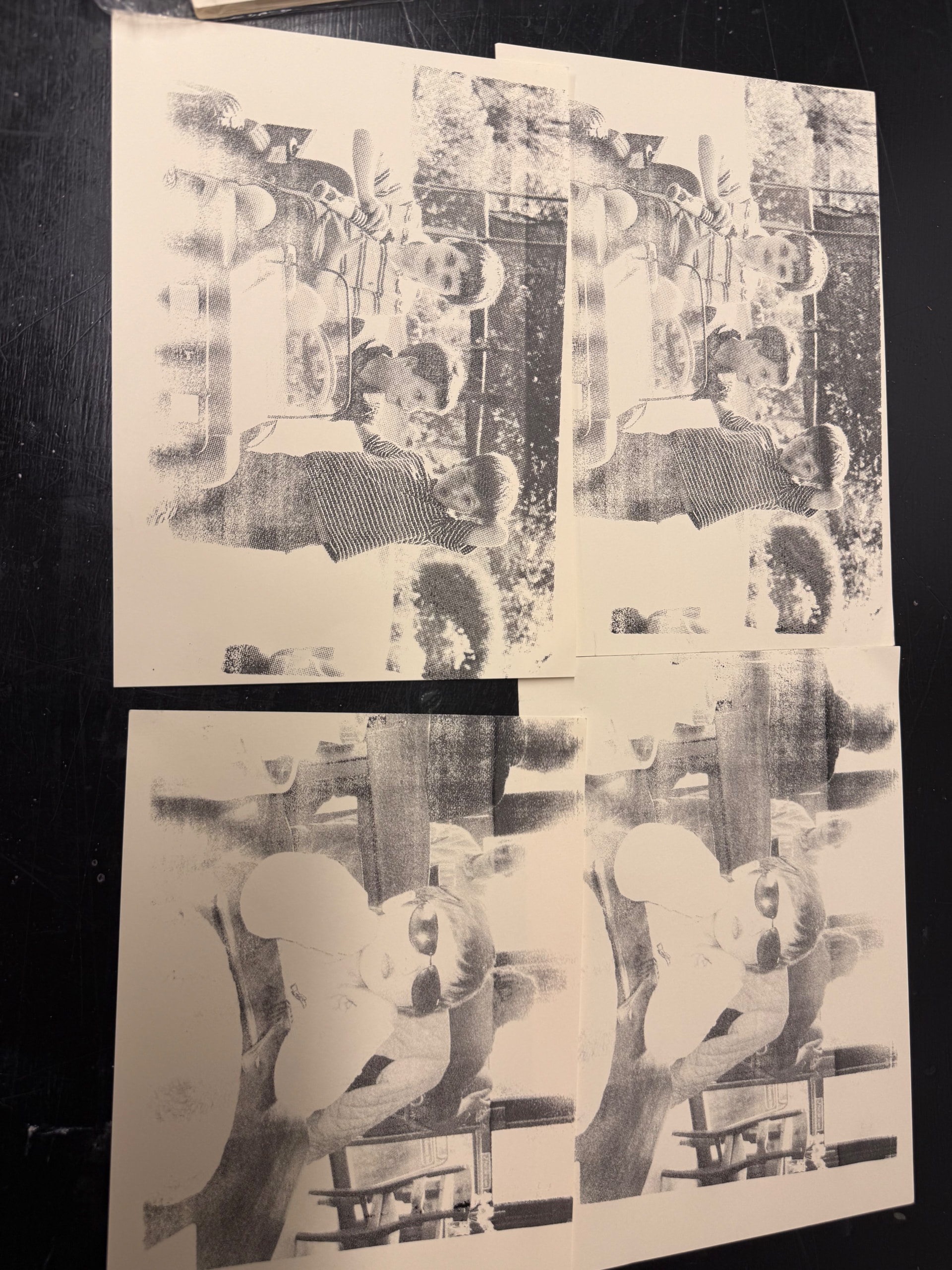

When you print the screen is it barely showing, or over saturated?
Pictures aren’t the best but thanks for all the tips guys! Changing the choice of screen definitely helped, and I think being more patient with washing
This looks better than my previous attempts
Next time definitely lowering the resolution for my own sanity

Thanks for all the help guys! I think a better emulsion coat would help with the streaks on the bottom, and more focus washing those parts, the white space had some detail that didn’t make it through but I can live with that, overall a fun first attempt after induction!
