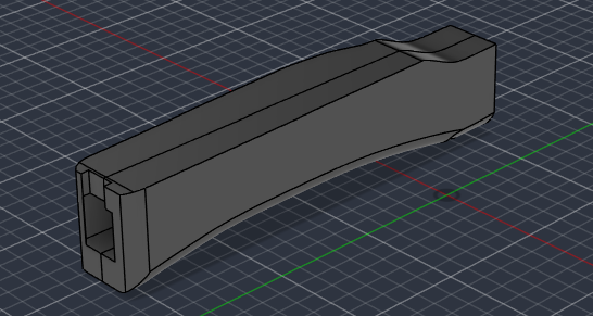

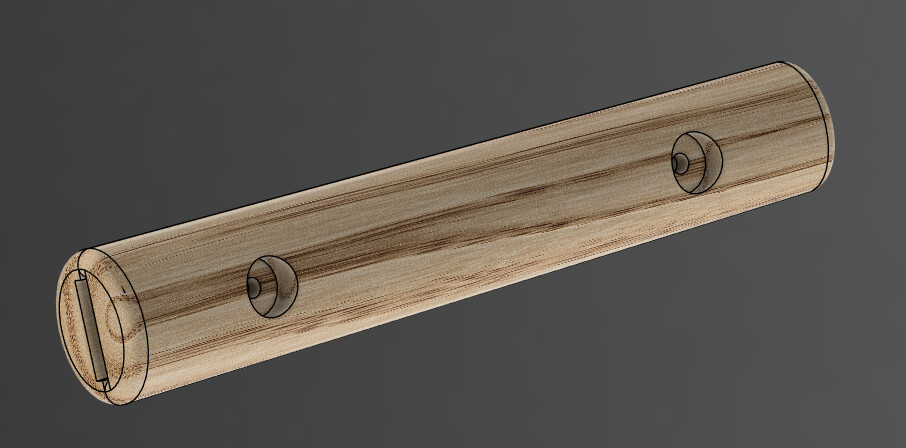

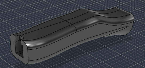

Sorry for the late response, it was a friends Bday yesterday, so what I’ll do, as there’s 4 models, and I might produce 3 of them (I know I originally said 2) I’ll divide them into halves, because based on some research it’s definitely not possible to do them in one go, but in might be possible to do them in two, so first cut out the inside, which leaves a flat surface to rest on, then cut out the outside and I can then stick them together.
This is the first one as a new user I can only send one item at a time.
This is the second.

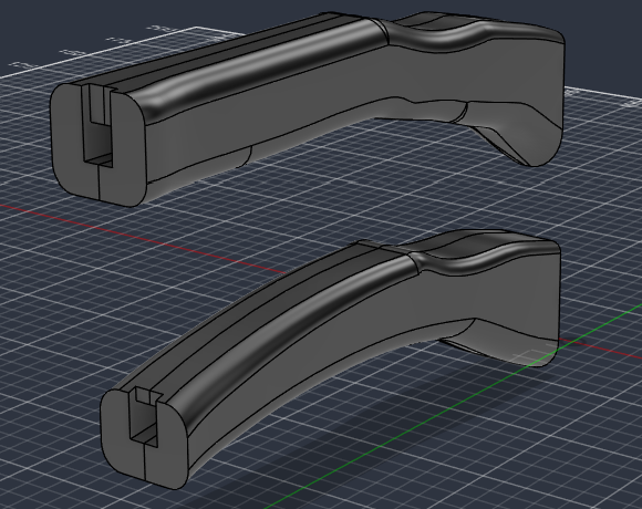

And these are the third/fourth, I’d only make one of these.

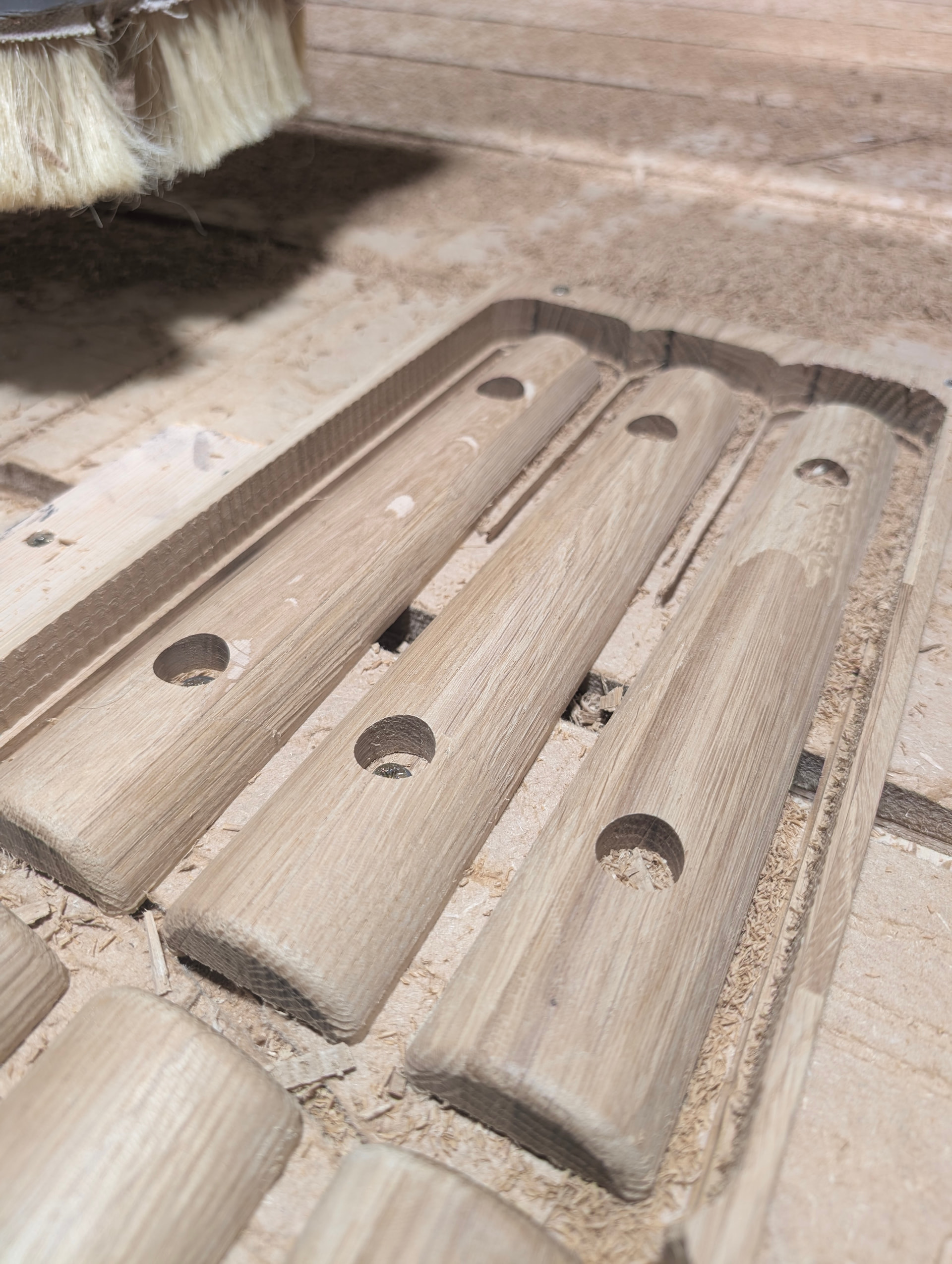

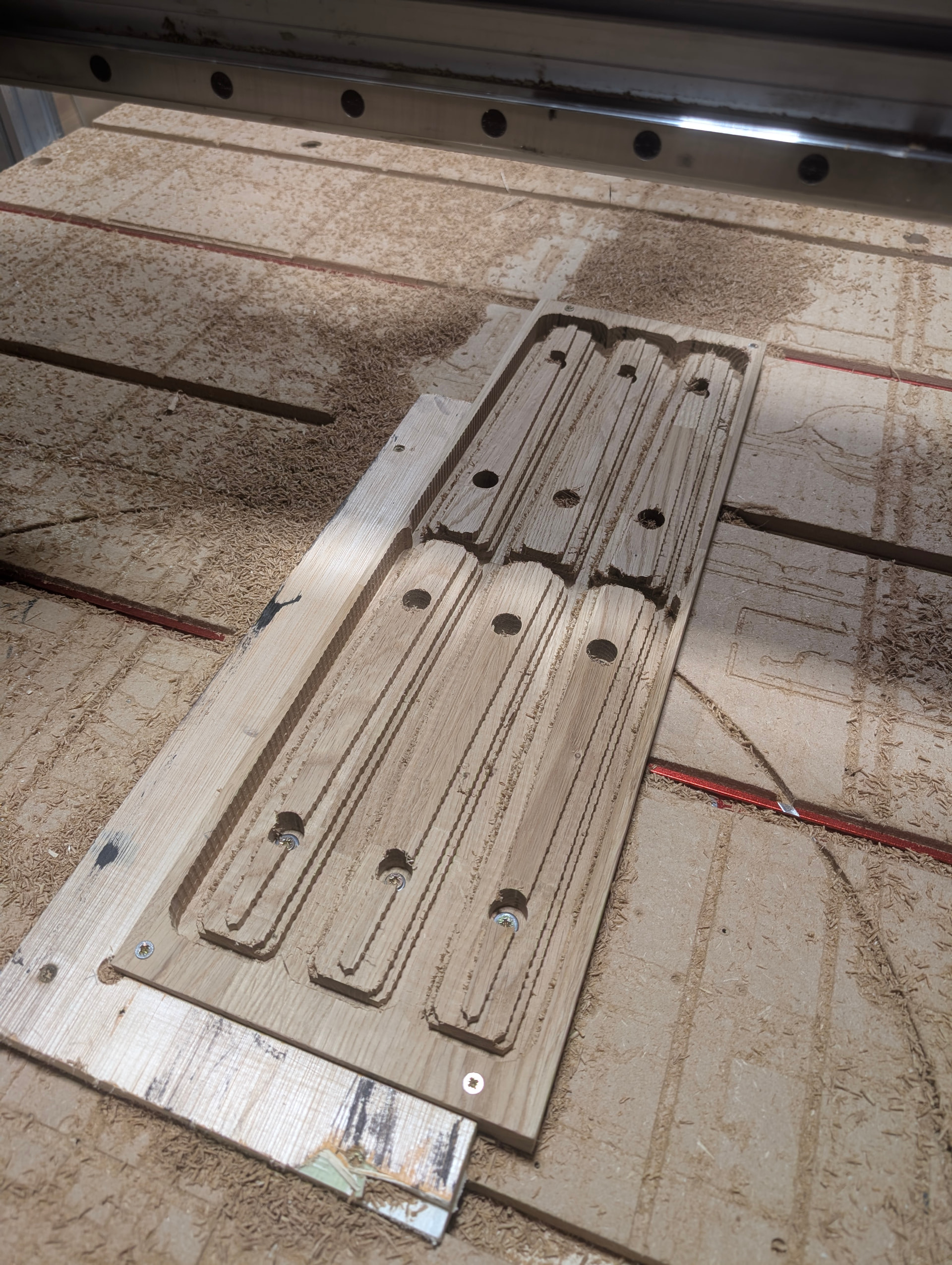

These look remarkably similar in concept to the sword handles that I recently cut on the CNC router.
I cut both the inside tang grooves with the parting plane as one surface of the material face up. Then flipped the material and cut the 3D contour on the backside of the material to get the outer round shape, which is also tapered.
I took a bit to figure out all the steps, but ended up great!

You could definitely get the general shape from the CNC, those round overs with varying radius along their length would be extraordinarily difficult to get right on a standard 3 axis cnc - I’d recommend getting the general shape on the CNC then smoothing / rounding by hand
Doing a finishing pass with a ball end gets it to the point of being able to hand sand it no problem.
Ok, so I’d need to redo the models, I’ll get on that asap, shouldn’t be to much of an issue as the versions I need should be in file history.

No this would all be on the CNC router table. Here’s some pics when I did mine.
Interesting - didn’t realise VCarve could do this!
