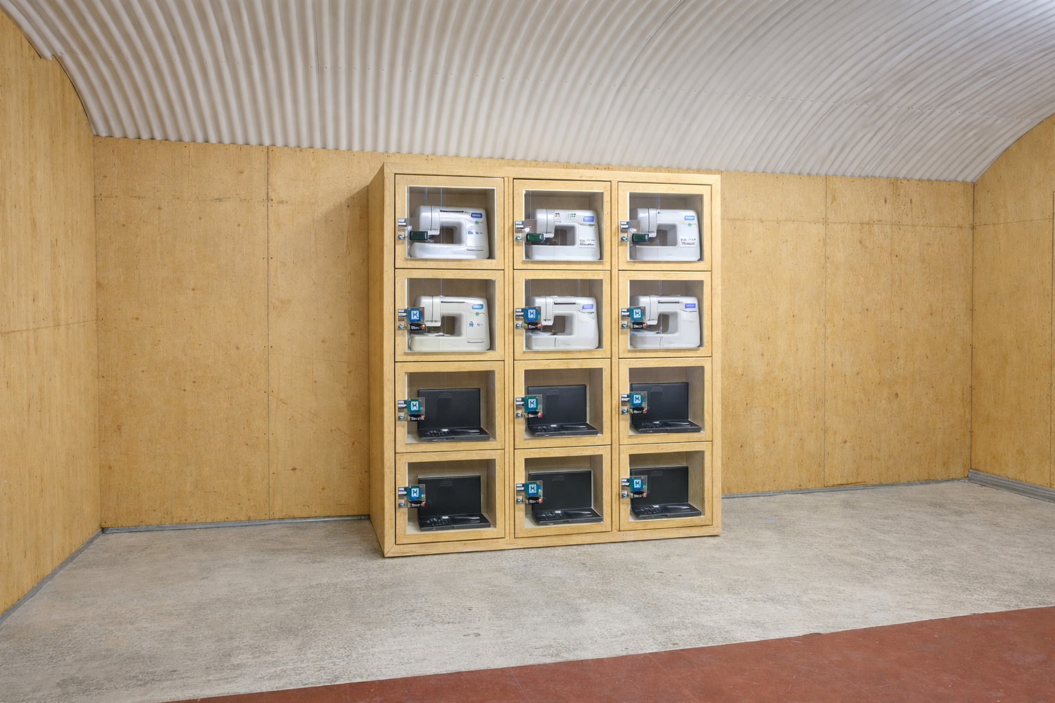

The simplest solution as I see it is a locker type system, where users can check out machines with their key-fob when they use them, and put them back afterwards - creating a record of who’s used them in the process.
In theory we could restrict certain tools with this, but for the most part I think having a record will keep people on good behaviour without being too heavy handed.
I’m happy to put a few days into actually building it, but do people feel this idea has legs, do techs actually want their tools locked away, can the tool control system handle a load of new nodes on it?

(AI slop rendering of tool lockers)

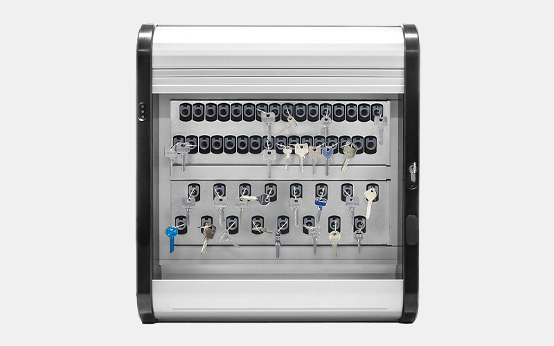

There are products that do this:
Diester is the manufacturer of the glove box key thingy that Zipcar used too.
Might be out of our price range - no idea, but we should be able to make one, as it’s basically a hook and tenon system.

Btw, that is the same product I was looking at, no prices on the website, which usually means “bloody expensive”

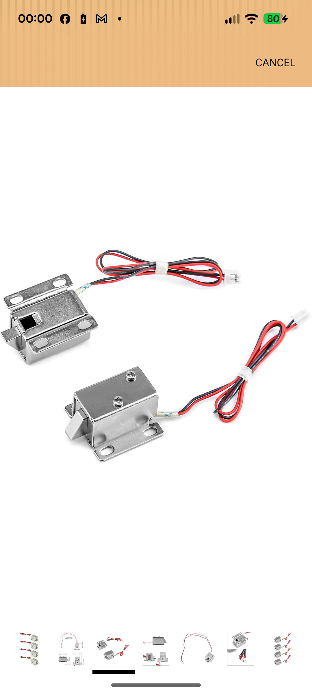

Surely would be way cheaper to build the locking module ourselves? At the end of the day it needs to be a very simple device not an actual security item.
Don’t you think?
Something like this on Amazon is only about 3 quid each…
And I’m sure we can find somewhere to buy in bulk that is cheaper
