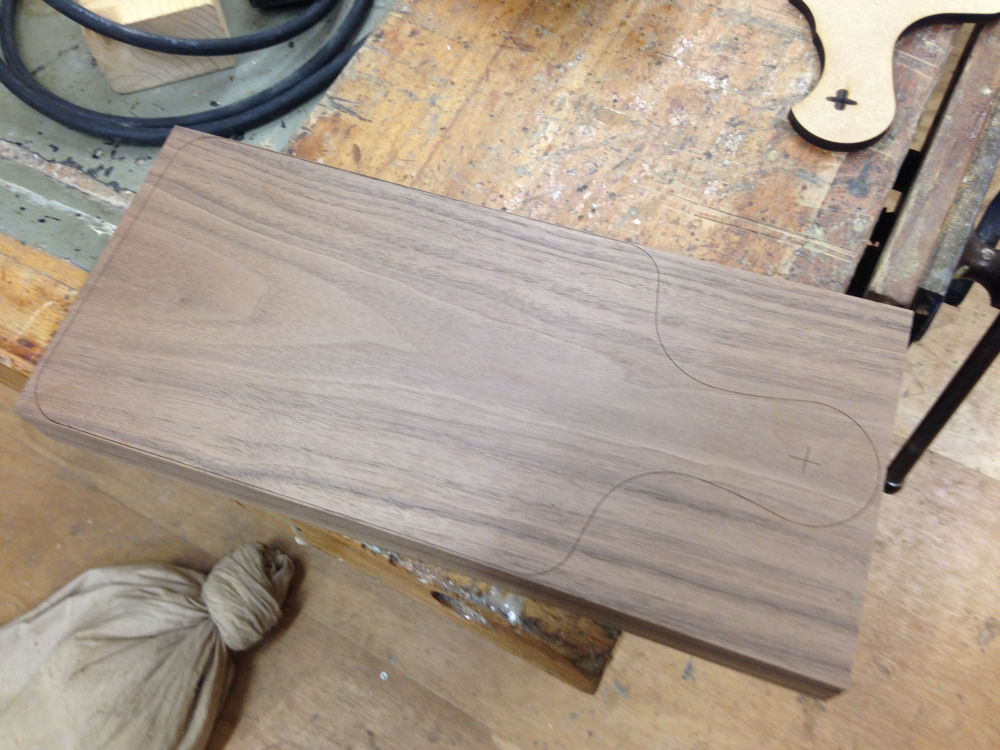

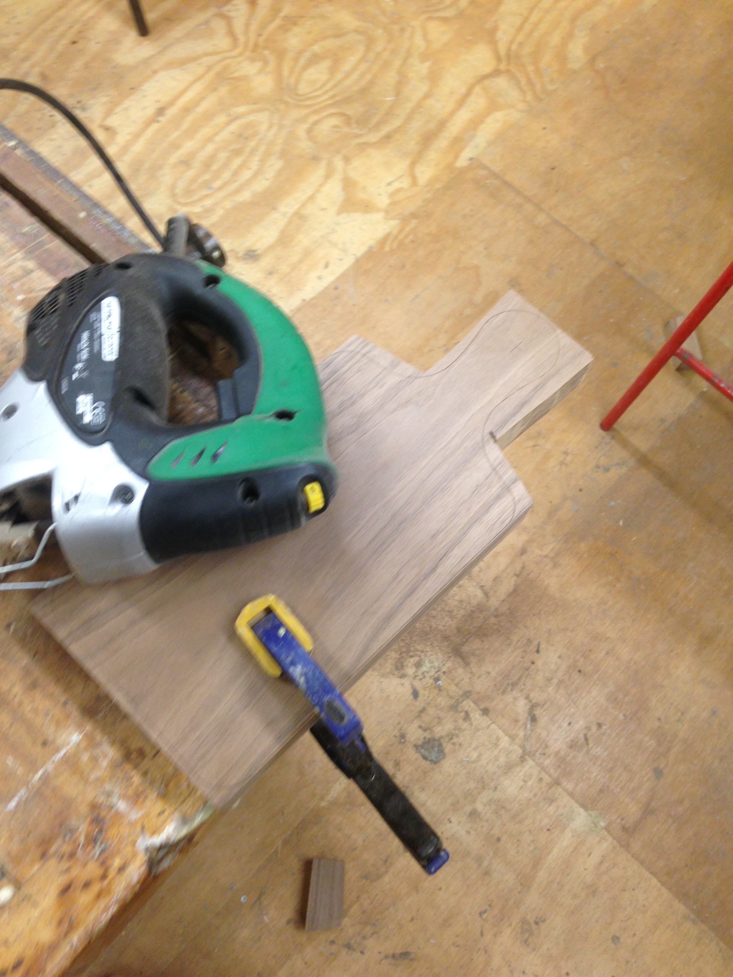

Started off with this piece, planed down to a reasonable thickness (about 28mm), then laser engraved the basic shape on it.
Trimmed the excess with the jigsaw.

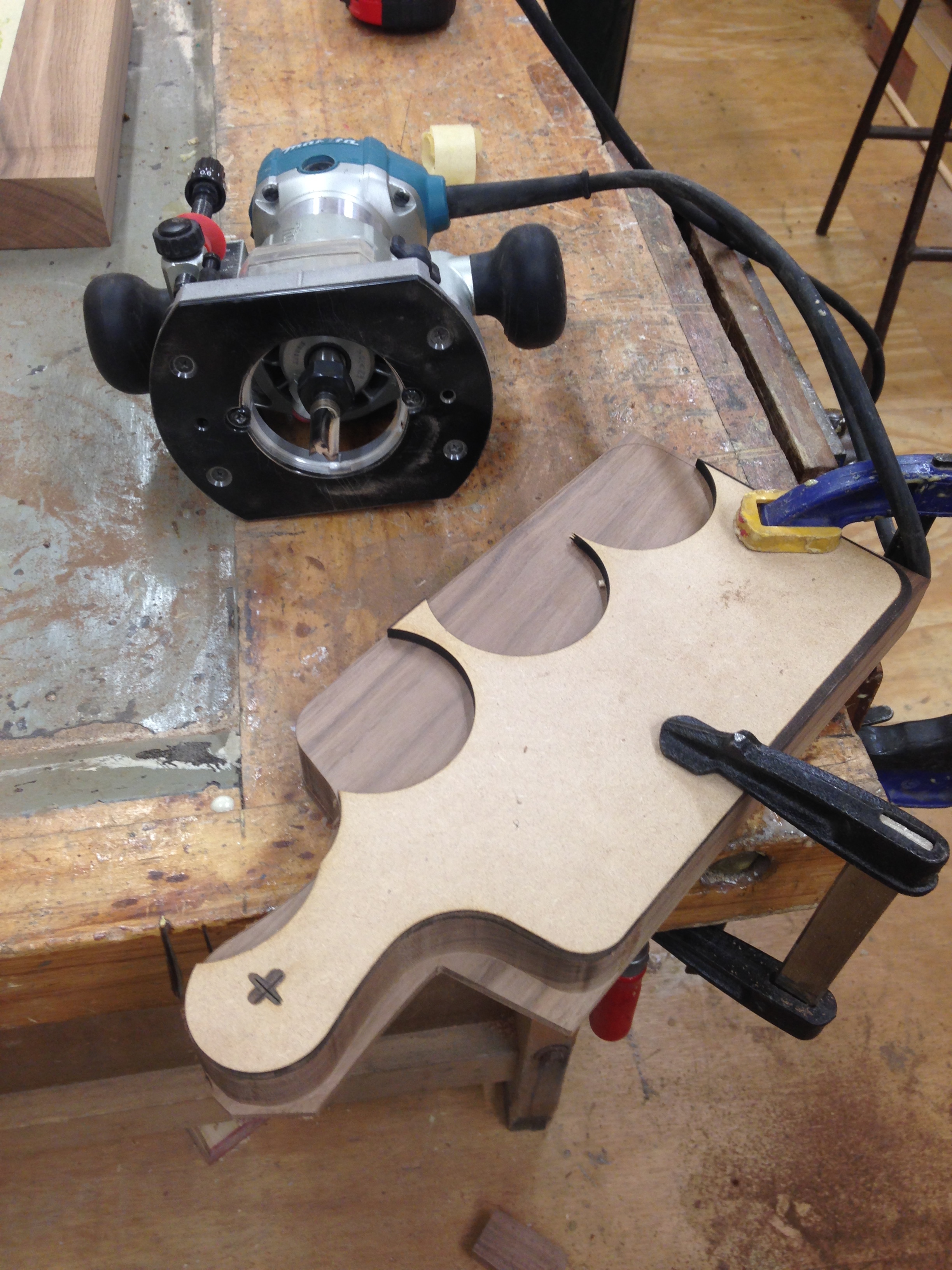

I found a bit of scrap just big enough for half the board, laser cut a template in the same shape, lined it up, then used a ball bearing bit to trim to the basic shape on the router

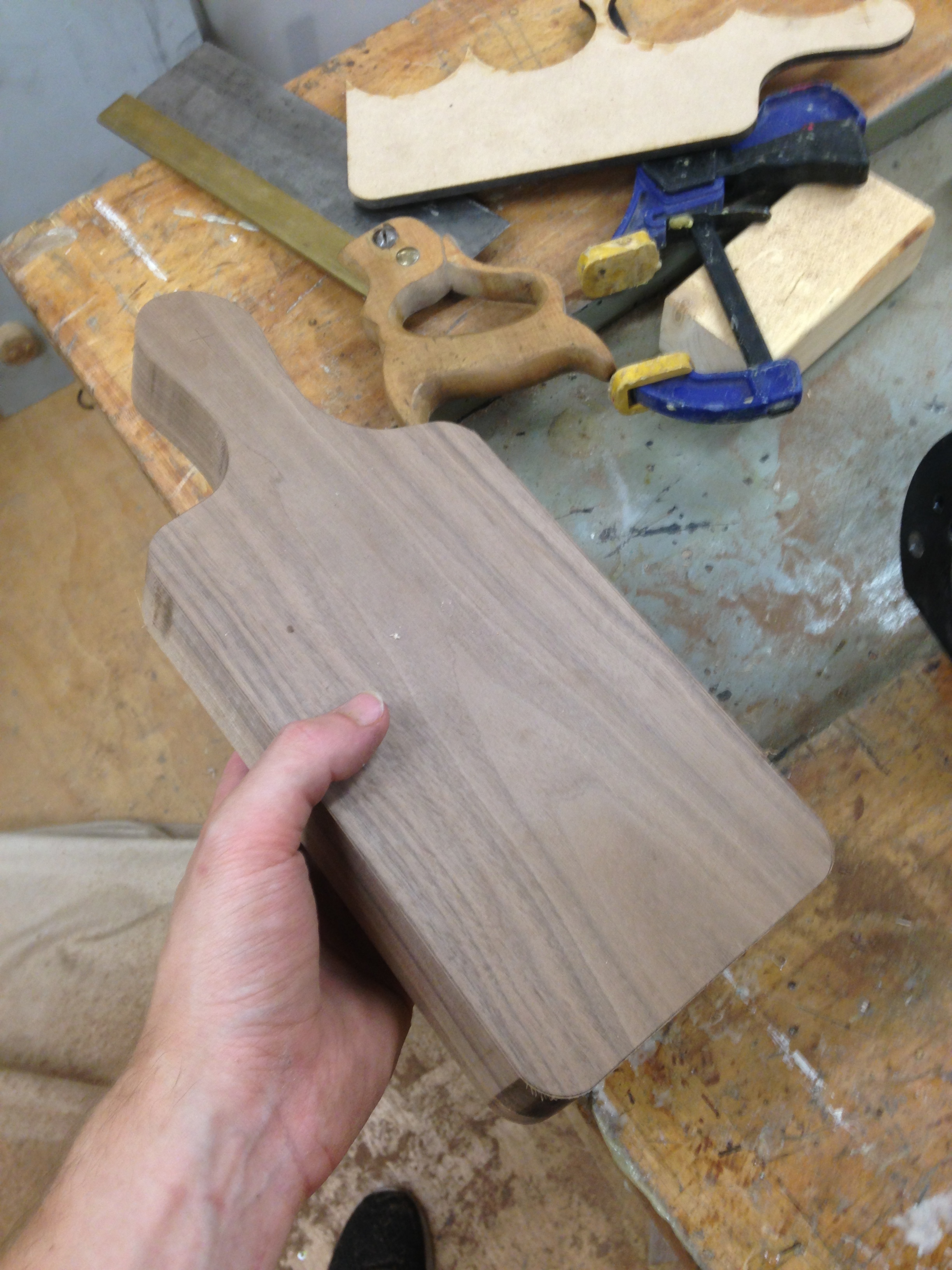

Routing done.

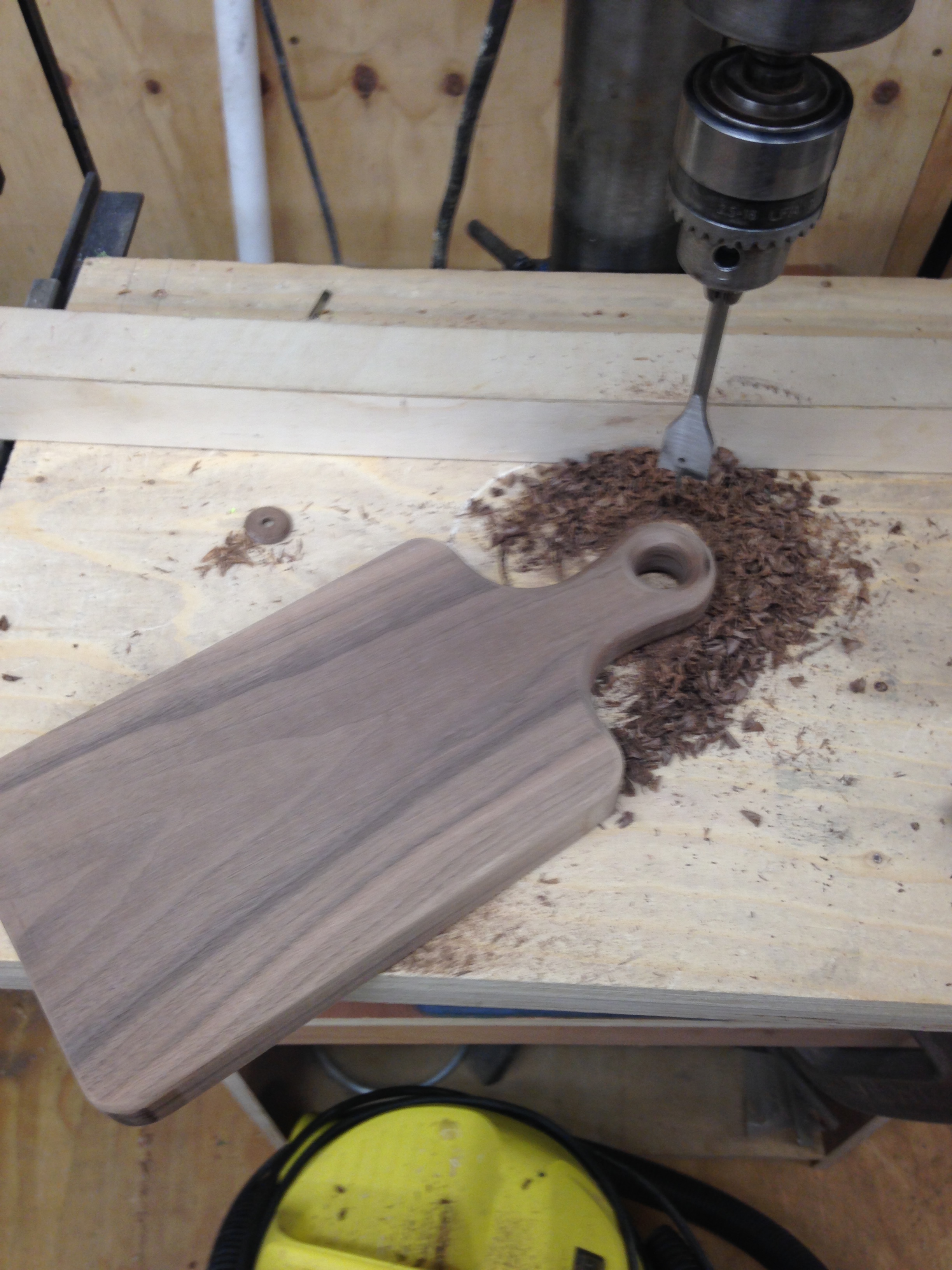

Drilled out hole using a spade bit, then rounded off the edge with the router

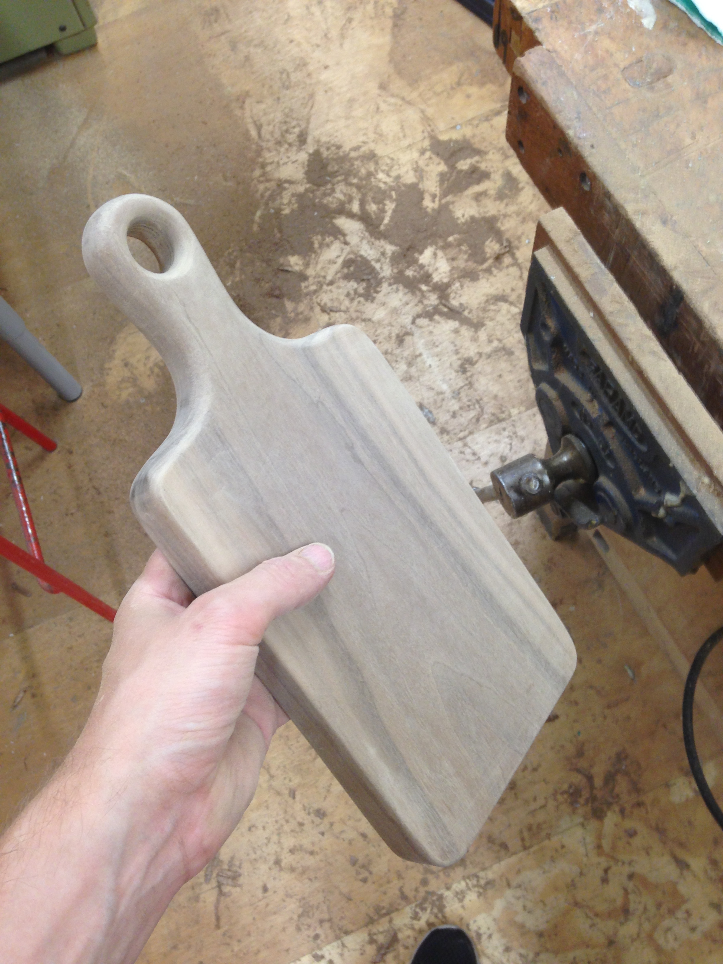

Sanded the final shape by hand

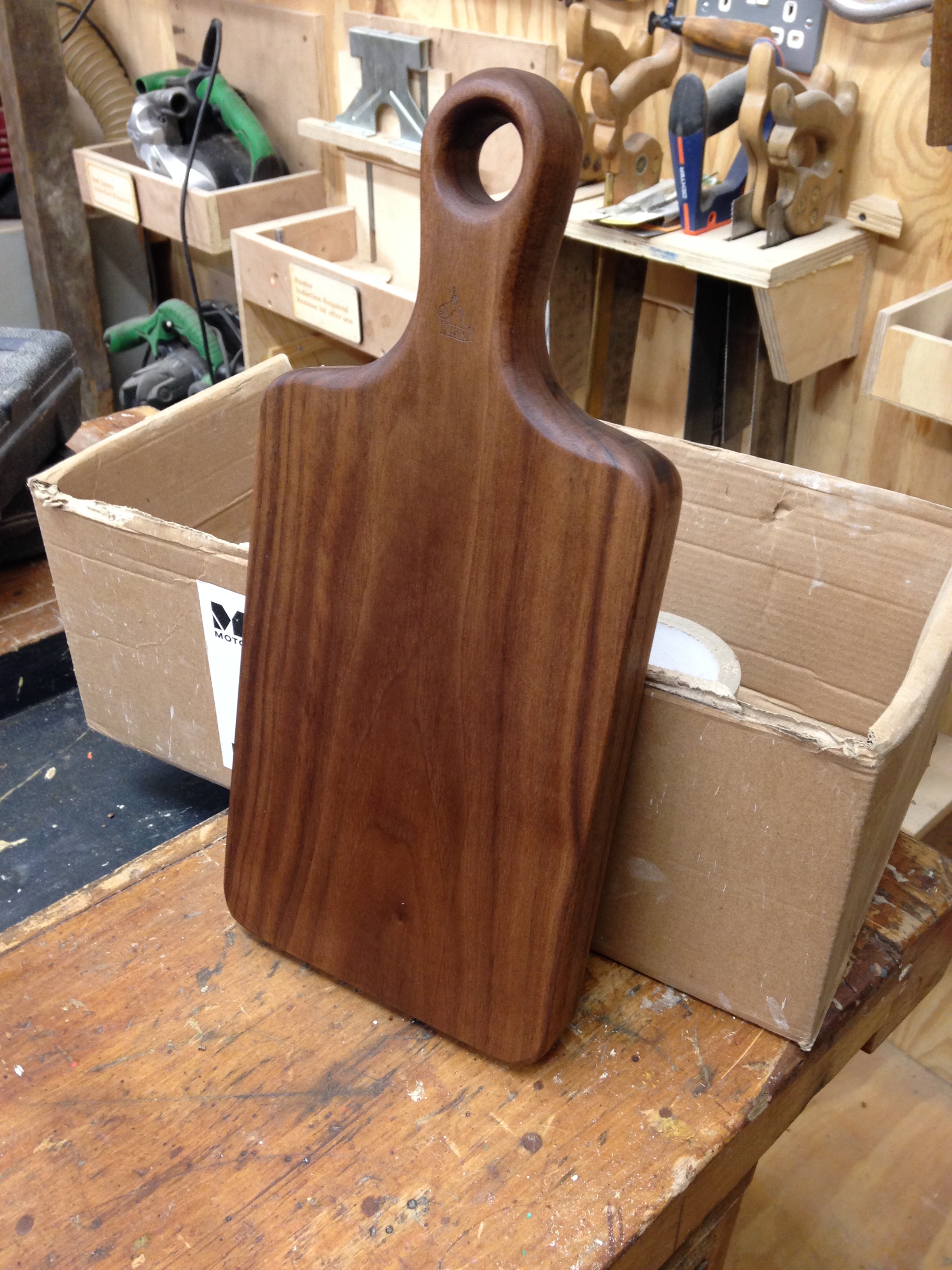

Finished! Oiled it with ikea SKYDD chopping board oil. Really pleased with the final colour!
