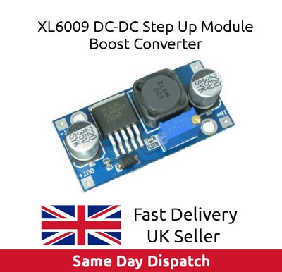

That is about right for the first stage but maybe drop the two100k resistors to 22 k and put a bit more gain in a second stage or just use the microphone input on the camera as second stage
This should do 48v with a few mods
