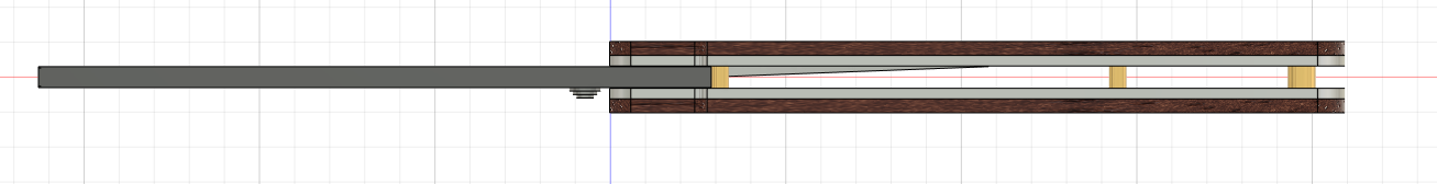

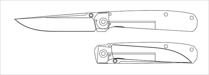

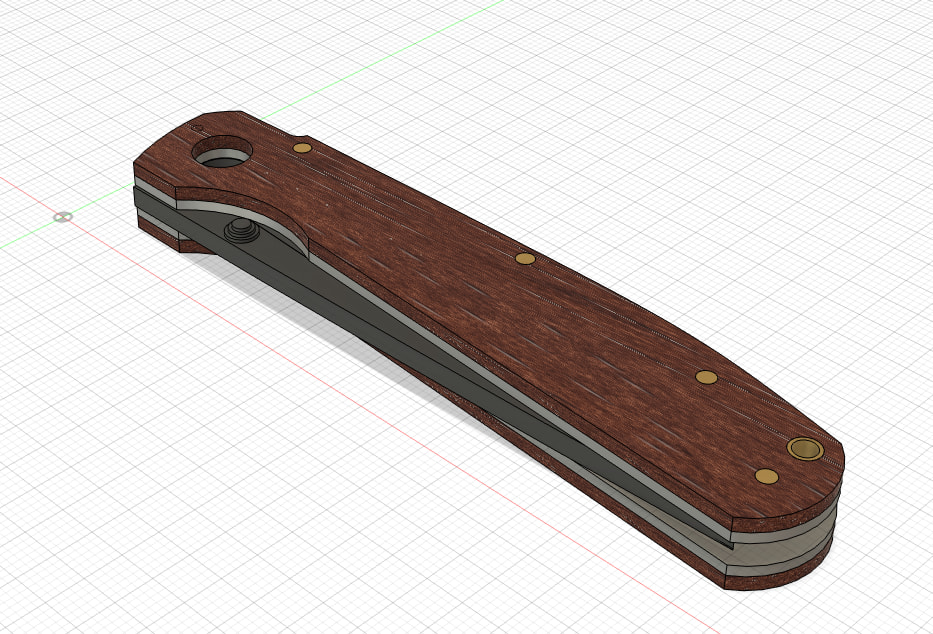

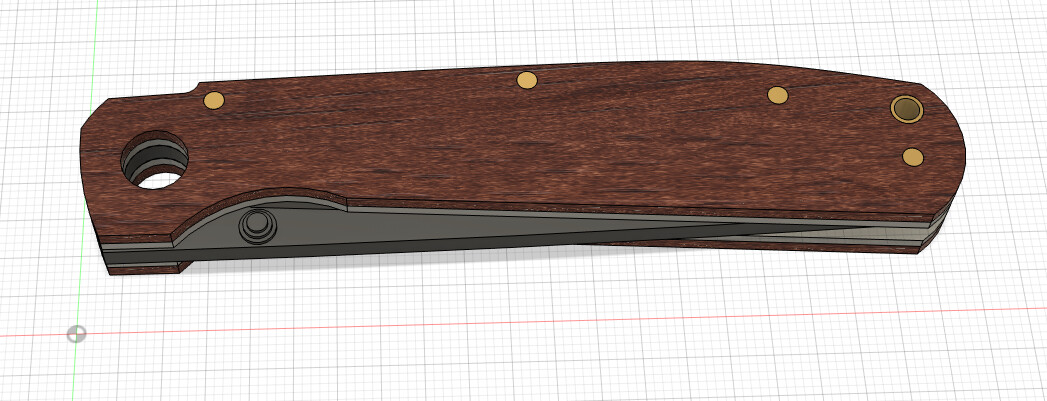

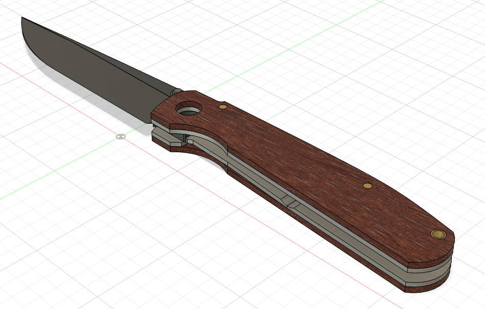

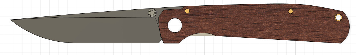

This is the design I was thinking of

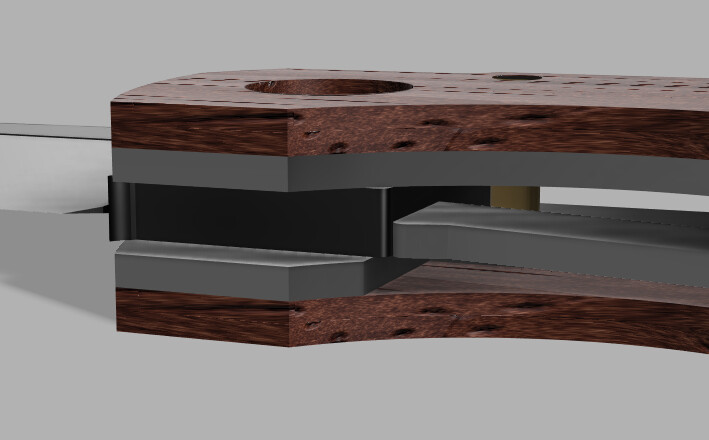

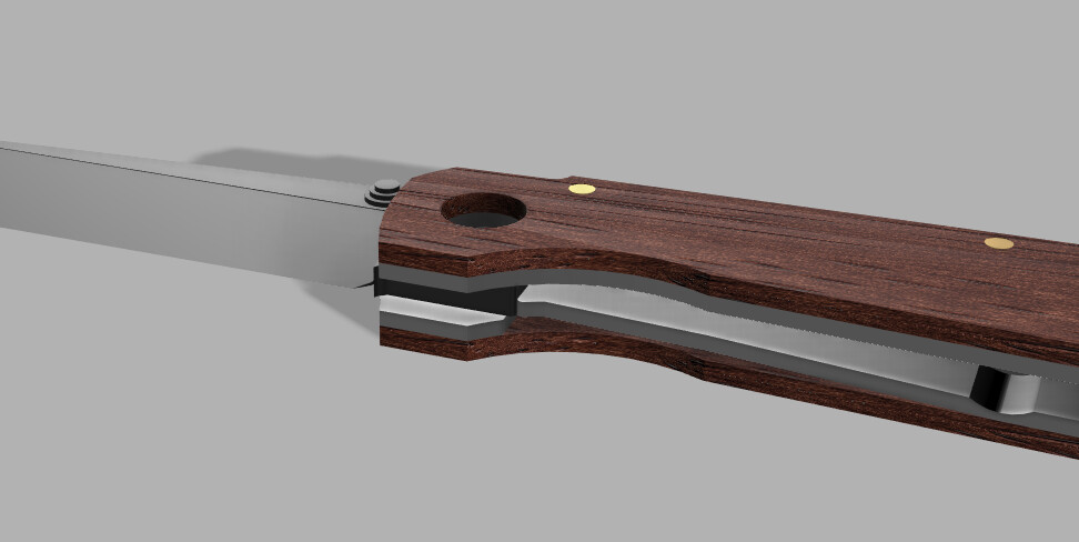

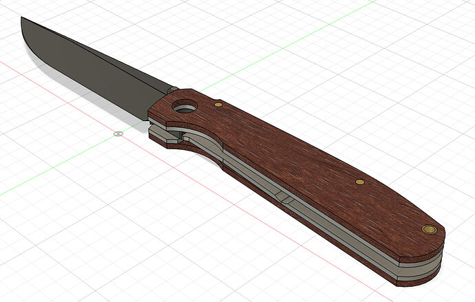

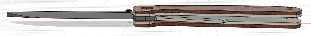

3d design below (to be refined further)
Have you thought of a locking system for the blade when out, extended?
We don’t want to see you chopped fingers around the shop.
:slightly_smiling_face:
That’s the liner lock mechanism he mentioned :+1:
@stefanoromano the design looks beautiful
Hi,
Yes it’s a liner lock.
Not super easy to see in the render.
here it is
Great stuff!
