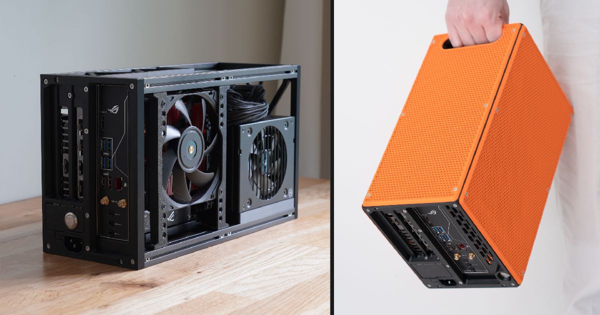

Heyo! So folks may have seen me stalking about figuring out how I’m going to print a 3D case. If someone was up for buddying up on this, I’d be super grateful!
Basically, I’m putting together a case for a Steam Machine replacement build (partially 'cos I didn’t make the ballot, partially 'cos I can make something cooler myself with a few sacrifices :stuck_out_tongue: ) using the BeamCase SW models I found on Printables.
I’ve actually taken a stab at prepping the files both as STLs and as sliced 3MFs so I could shop around for quotes in case I needed it quicker than I might be able to manage here (though I feel like I should do some more checks on them, as it’s my first stab at FDM and I think there’s tools available I’ve not tried…), so if you wanted to take a look at the Printables project, the files I’ve prepped, or the PDF on building it when it’s done, you can find them here:

You’ll want to print this is ABS probably. PETG might be fine but its thermal limit is around 70 degrees where ABS is just under 100. I think if your case temperature got to 70 there’d be worse issues other than the print warping but ABS is probably the safer bet.
Yeah, looking at what people on the Printables page have said, PET-G would probably be okay… but one of the constraints I’ve given myself is I want my main PC’s GPU and CPU to go into it when I upgrade that, so though it should be okay for now with a Ryzen 9600X, RX 9060XT and total TDP in the 200s, it’s eventually going to have a Ryzen 7800X3D, RTX4090 and total TDP around 600 - between that weight and heat I want to be a bit more careful!
