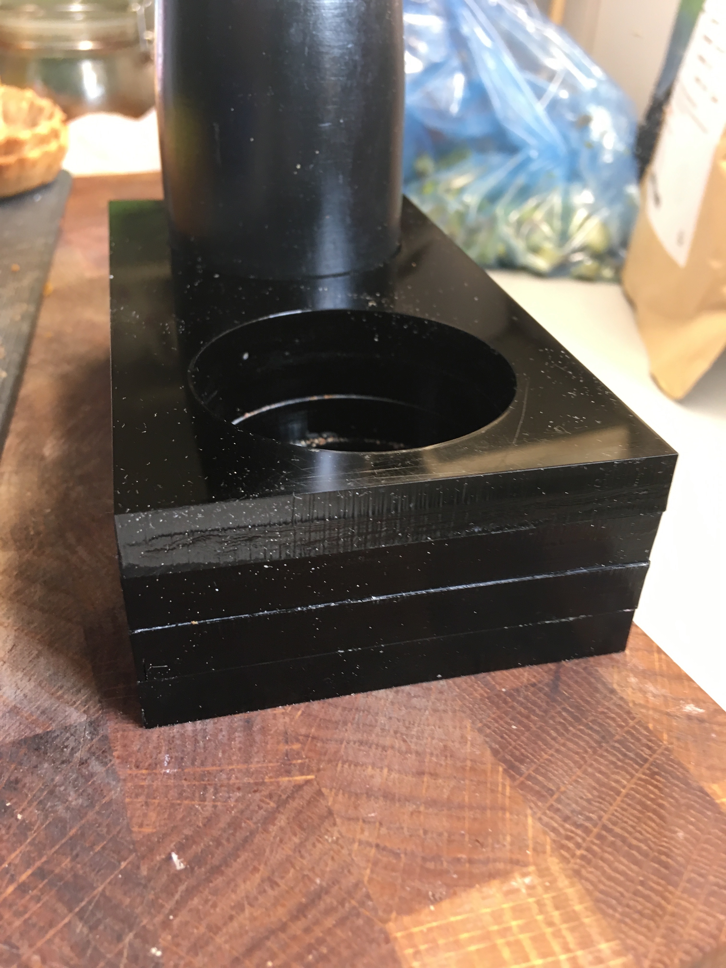

Hello, I’ve been playing around with different materials to see how they behave. I wanted to see if i could make 3D structures from stacking bits of laser cut acrylic.
I used some of the 9mm acrylic(?) from the scrap laser shelf.
1st test was a salt and pepper holder made from 4 layers of 9mm with 3 containing 2x holes.
I tried a few different glues but in the end found ‘Tensol 12’ to give the best finish - apparently it ‘melts’ the two parts of acrylic together to create a solid bond but doesn’t work across gaps very well. It also worked well affixing wood to acrylic as seen in the pencil holder.
I wonder if anyone can help with a few questions?
  1. Am I on the right track with the Tensol. It seems to do the trick - note that i’m not going for food grade here.
  2. The laser cutter doesn’t give an amazing edge. What are the options for smoothing off / buffing it. I’ve never worked with acrylic so not sure if you can sand it/polish.
I have a project in mind where I want to stack 8-9 pieces and it want the edge to look continuous.
options for smoothing are:
-sandpaper taped to a granite tile or pane of glass (or anything super flat) for coarse grain
-water stone for fine to ultra fine grain
-buffing wheel and compound for getting a mirror finish
you should probably do all three in that order
make sure the sanding surfaces are really really flat
i haven’t done pmma but i’ve heard it polishes ok. epoxy fares well.
But you could always make a cast and polish that! You can mix resins with a filler like powdered marble or bronze and stuff like that. Might be good for your holder to give a nice weight to it.
