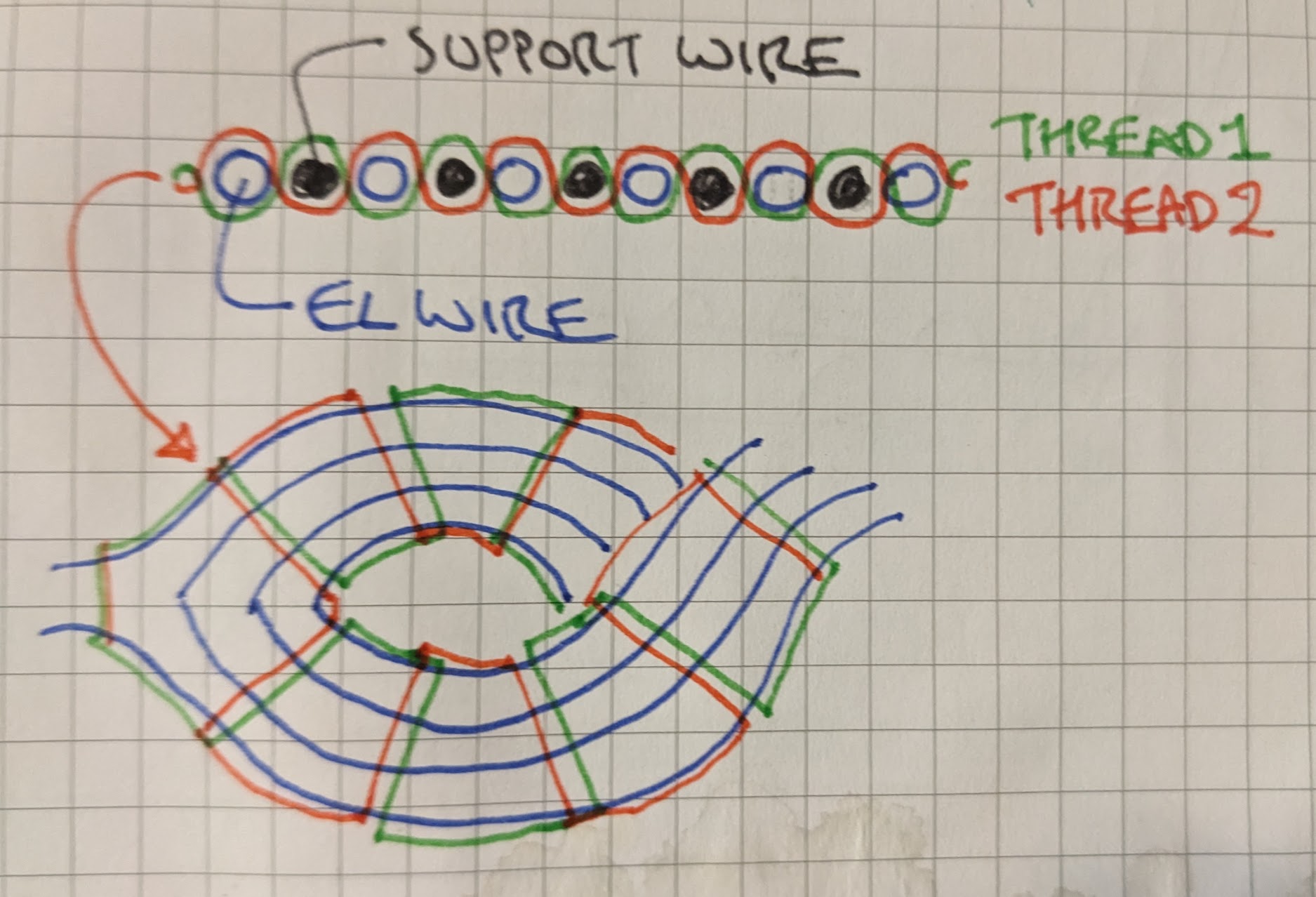

I was going to try and glue/sew/clip the elwire onto a regular masquerade mask, but there’s no glue good enough, and any stitches/clips would perforate the mask so much it would disintegrate.
So instead, I’m stiching the wires together side by side with “inert” wire. This photo just shows the “tack” stitch. I’ll come back later and double-stitch neat radial lines, to keep all the wires parallel. I’m using speaker wire as the “support” wire but I may swap it for something solid core if it’s not stiff enough.
