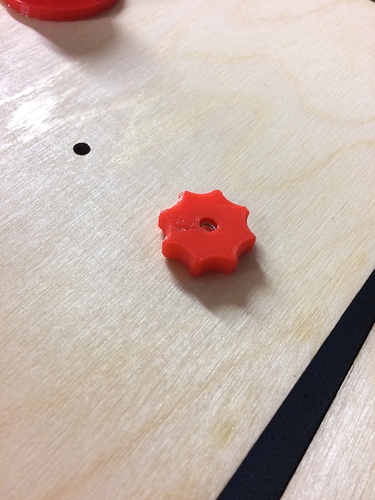

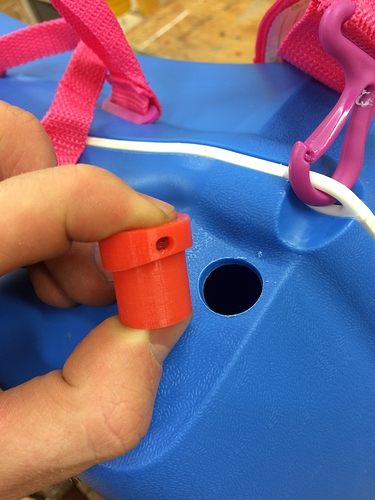

I leave quite soon so will have to mod a trunki and possibly develope the idea for future trips. Got it pretty much figured out using some 3D printed parts, Ali tube, plywood and a stock trunki… will try post some sketches soon…

So… with some aluminium tube, a trunki, some laser ply and a big of 3D printing, my bed box is looking good… some pics of the build below but I need to get a good shot of the finished item. The mattress is still to be completed but will post that too when it’s done…

Looks good! Does the ply fit into the trunki?
That was an original aspiration but as the trunki’s shape is tapered, it meant that the board would get too narrow and so I have kept it seat width and will carry it separate from the trunki…

Will bring the completed bits into the space sometime when I’ve returned and confirm it is all flight safe… all printing part files etc is available for any takers… :blush:
